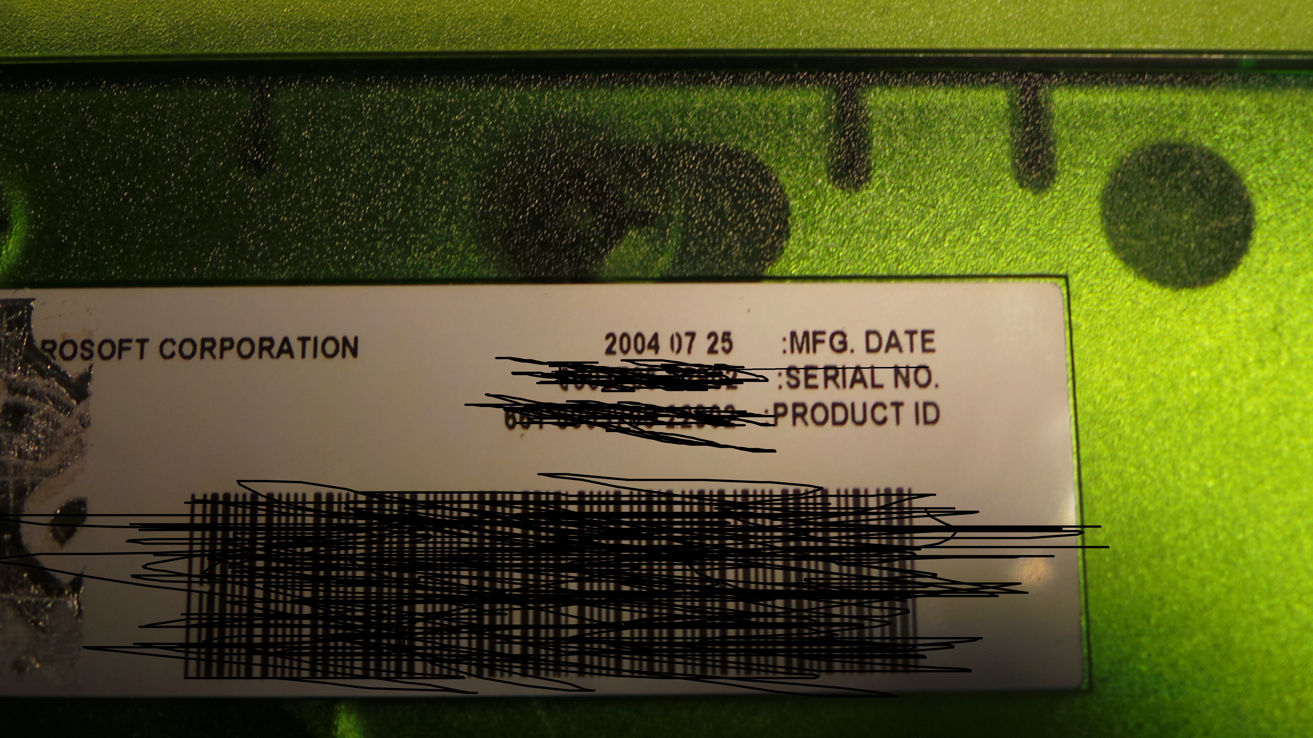

  2. Borman
    Does the serial number match?
    Regardless, it does happen sometimes.
    finalkillcams likes this.
  3. DarkGabbz
    DarkGabbz Some guy from Gbatemp
    Jan 4, 2017
    This sticker says Made in mexico too.
  4. Borman
    I mean, you can check the serial on the dash too. Dev units are strange in that they will use whatever they had
    finalkillcams and Syclopse like this.

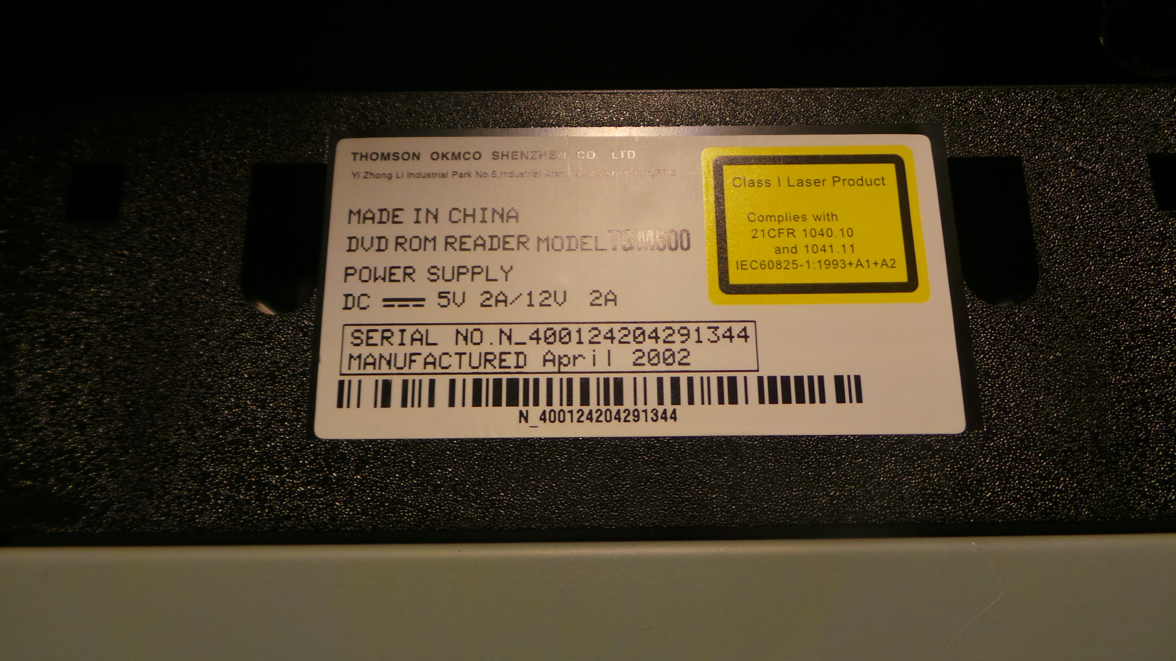

  9. Syclopse
    Syclopse .
    Dec 17, 2013
    1,508
    537
    You can use XBMC or AvaLaunch I think to view hardware information, but why even bother? Maybe it was refurbished in 2004 by MS before being sent out to a developer.
    If you're really curious, what are the dates of the plastics? Should be a circle with an arrow pointed to the month with the year one each side. 0|1 would be 2001, etc.
  10. DarkGabbz
    Jan 4, 2017
    The serial number matches the one from the case sticker.
  11. DarkGabbz
    Jan 4, 2017

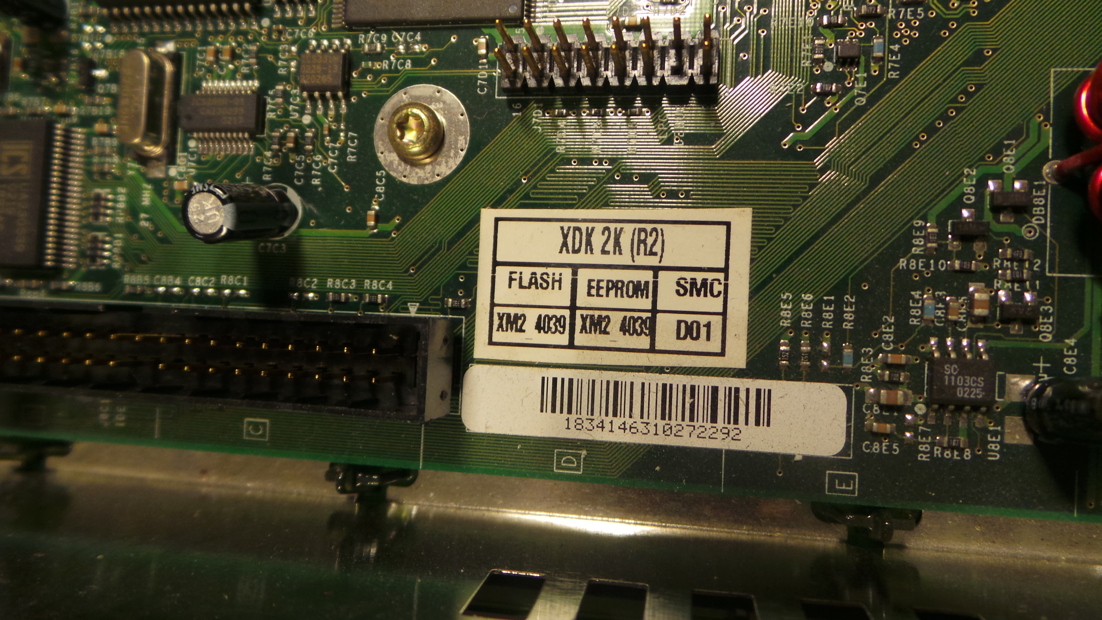

  12. TriMesh
    Jul 3, 2008
    2,324
    Looks like a rebuilt unit - in that photo of the label, you can read some of the chip date codes, and they are all 2002 (0217. 0219, 0225) - the second 2 digits are the week, so they line up pretty well with the rest of the internal parts. My guess is that it was originally built mid 2002, then sent back to MS and rebuilt with new plastics in 2004.
    XboxSurgeon and Digmac like this.
  13. XboxSurgeon
    Nov 18, 2013
    2,109
    923
    I agree. The silver decal over the top of the screw hole, has in my personal experience, meant it's been pierced by MS for official repair or refurbishment. I think it's simply been a repaired unit.
