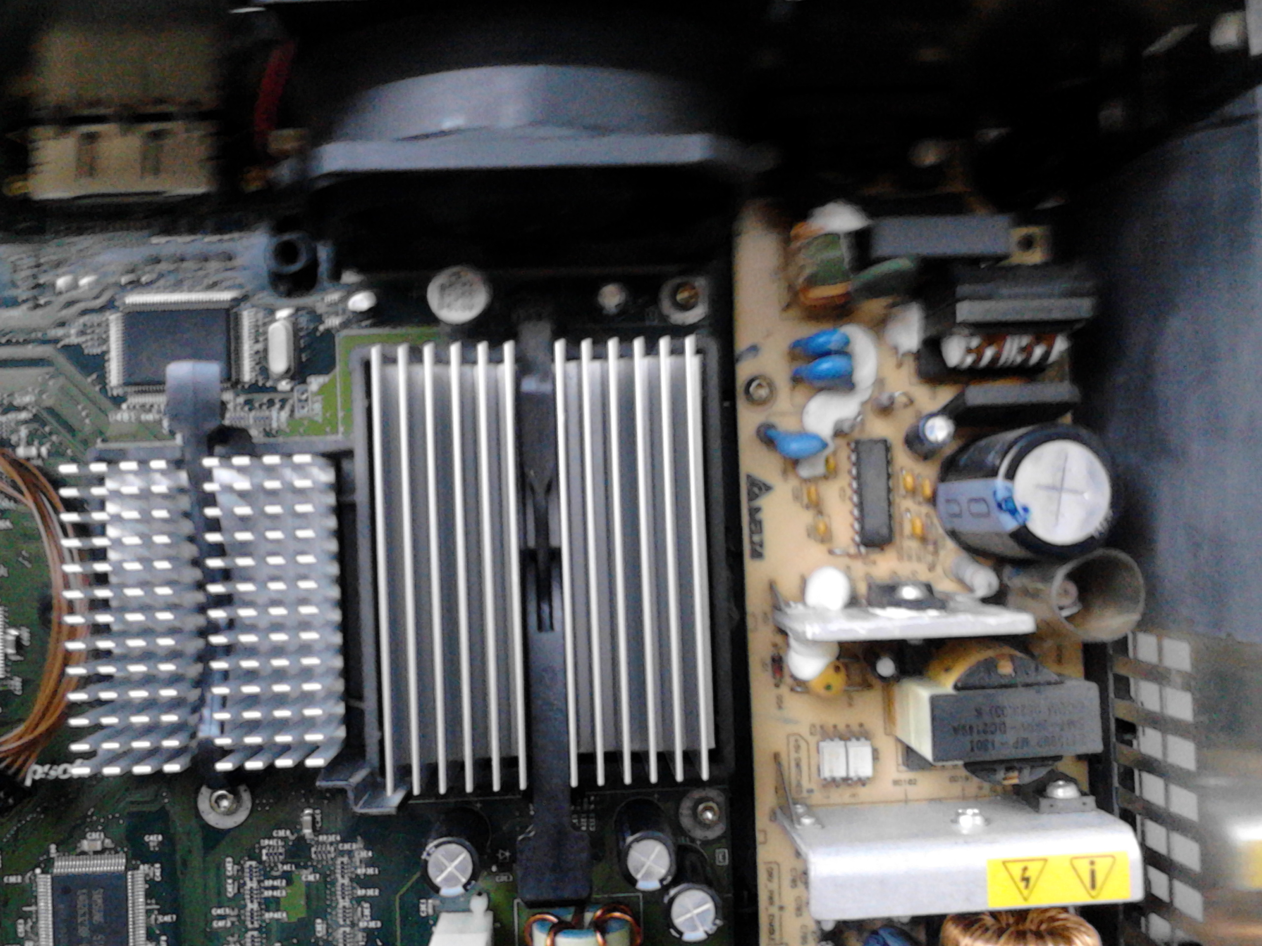

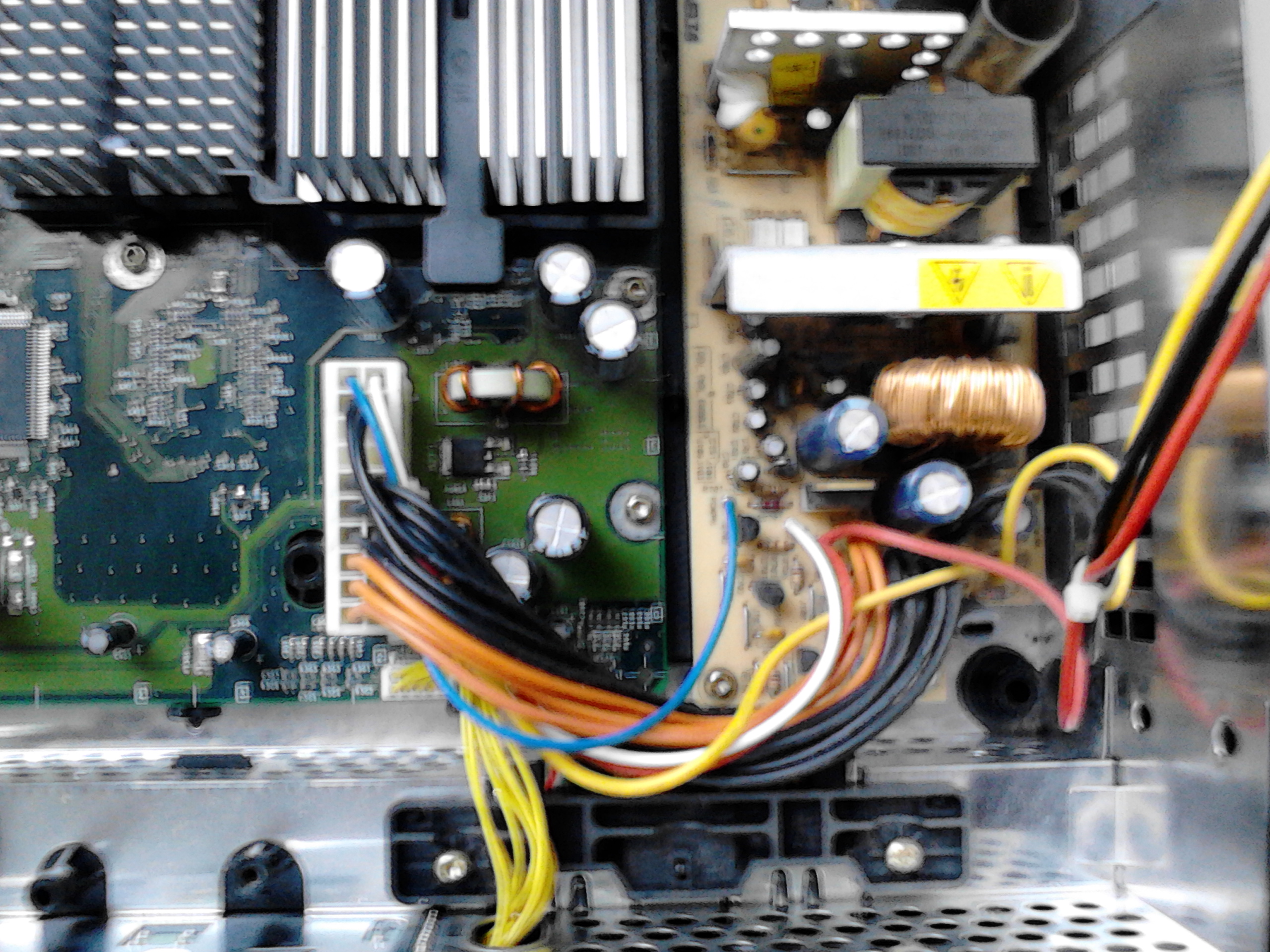

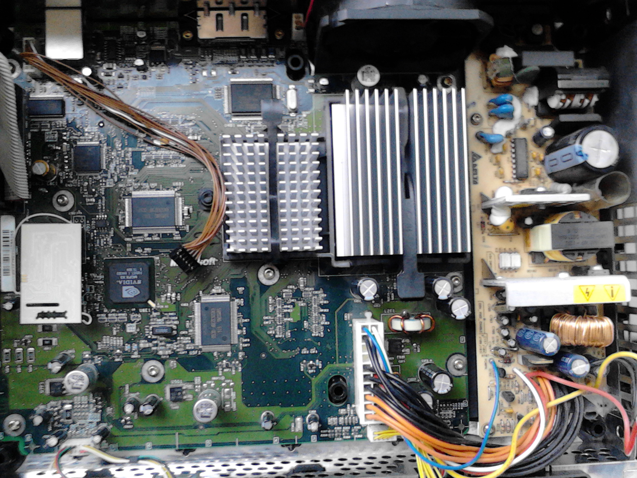

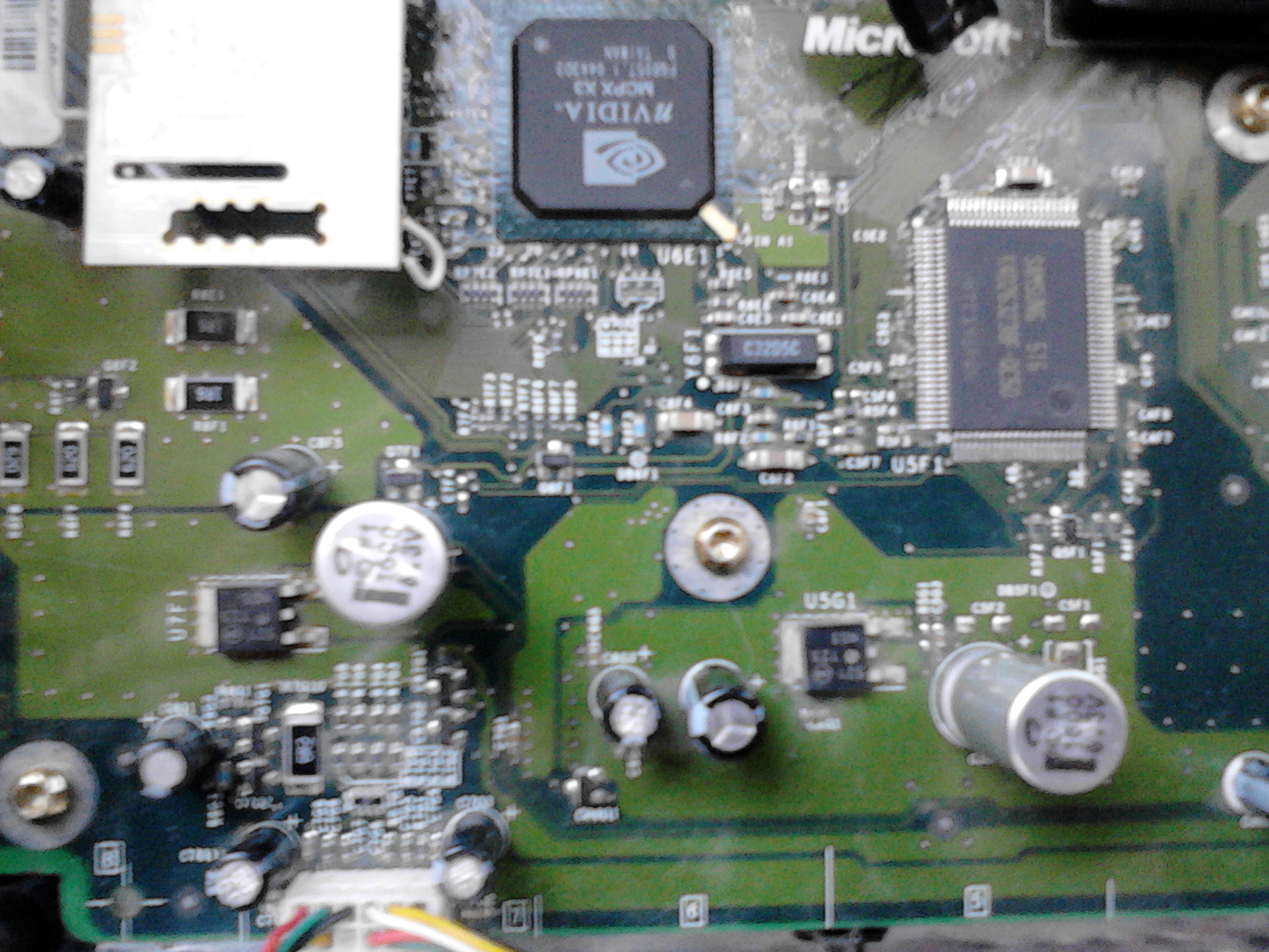

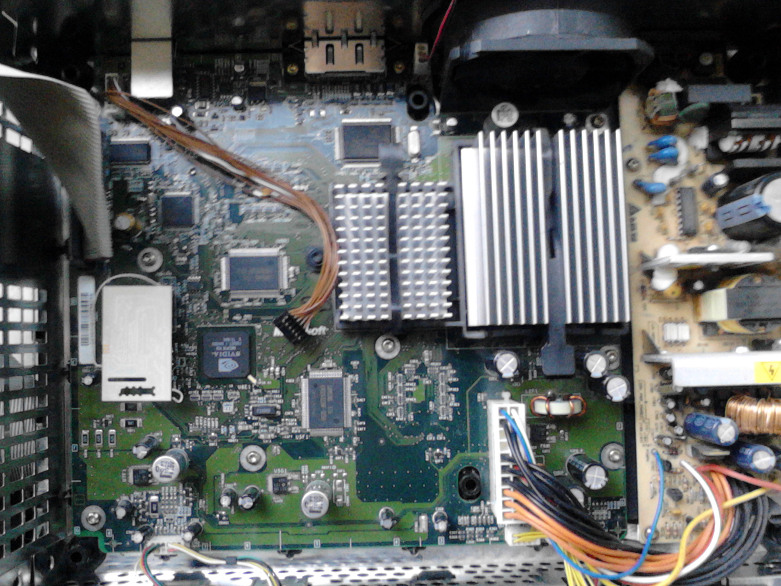

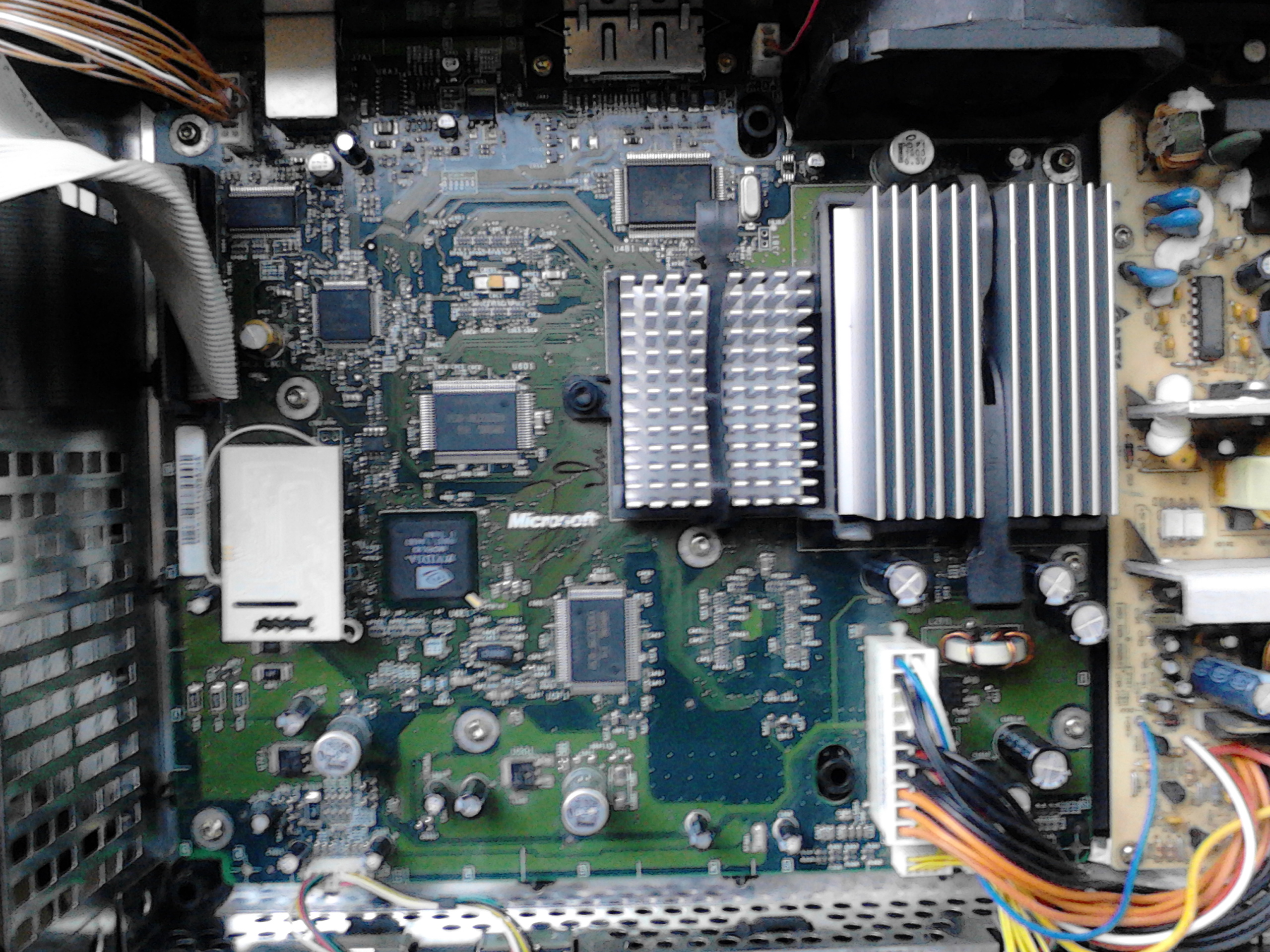

    Here are pictures of my motherboard:
    Sorry about the quality of the pictures... If these not suffice I can borrow a better camera.

    Remove the motherboard & check the underside there should be some wires or a little PCB rebuilding the LPC port (bit where the chip plugs into) make sure all the wires are soldered to the board correctly.
    Also make sure the D0 point is soldered to the modchip & motherboard.
    (Looks like it's using the underside one)
    It could also just be that the bios on the chip is corrupt, if it is the case not sure if it can be recovered.
    (The chip looks like a Aladdin chip, but it's white so could be a pre release run or a clone)
