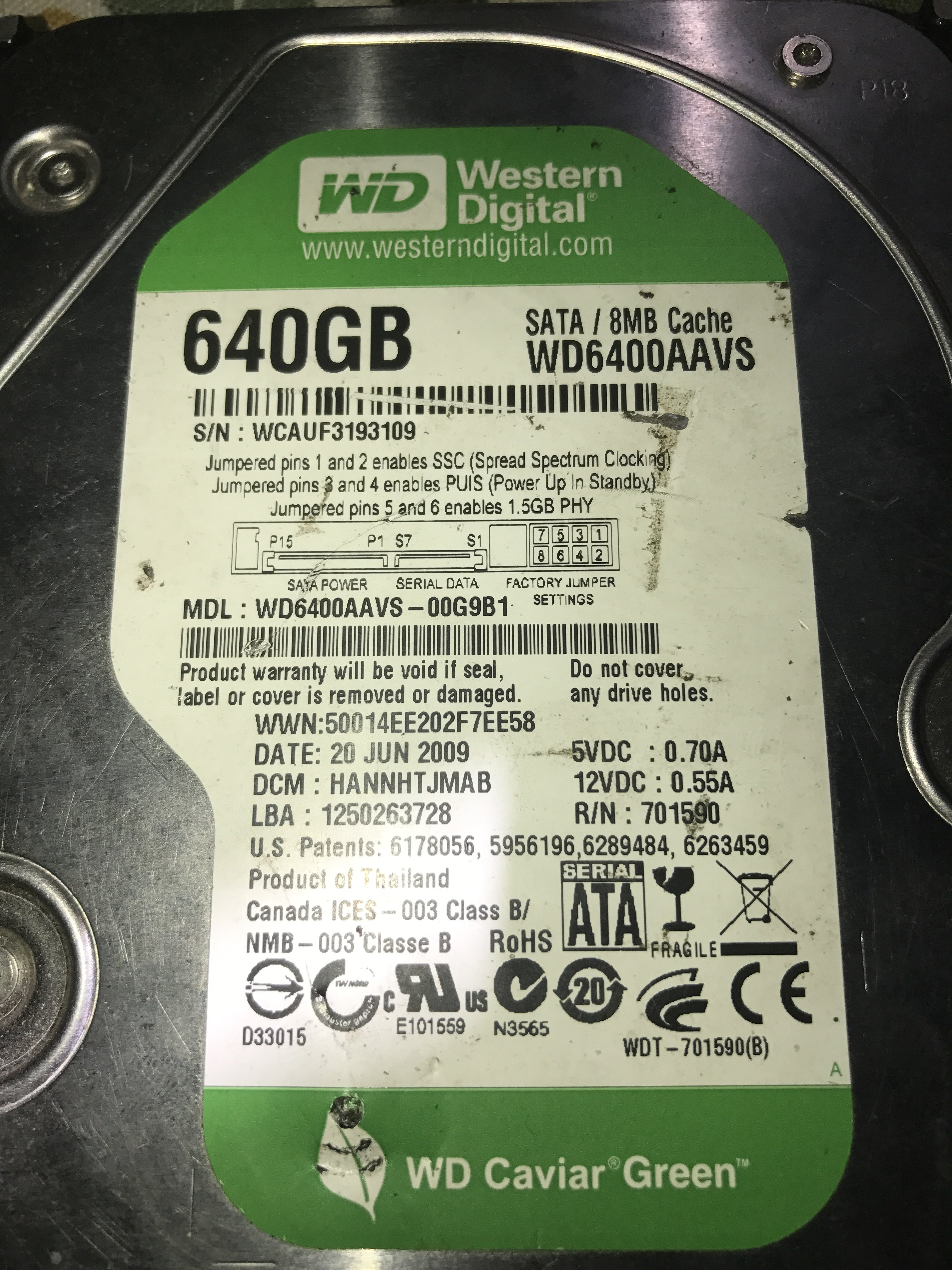

    Yes, 80-wire 40-pin IDE cable and a compatible IDE to SATA adapter. I generally shy away from using a GREEN WDC drive. If you do, find the old WDC utility to disable the green features.

    I want more details of what you are talking about?
  18. Bad_Ad84
    1,309
    Green drives park their heads very very often and is a point of failure. You can disable the feature to make the green drives act like the other wd drives and gain a vast improvement in expected life time.
    Bearking likes this.
