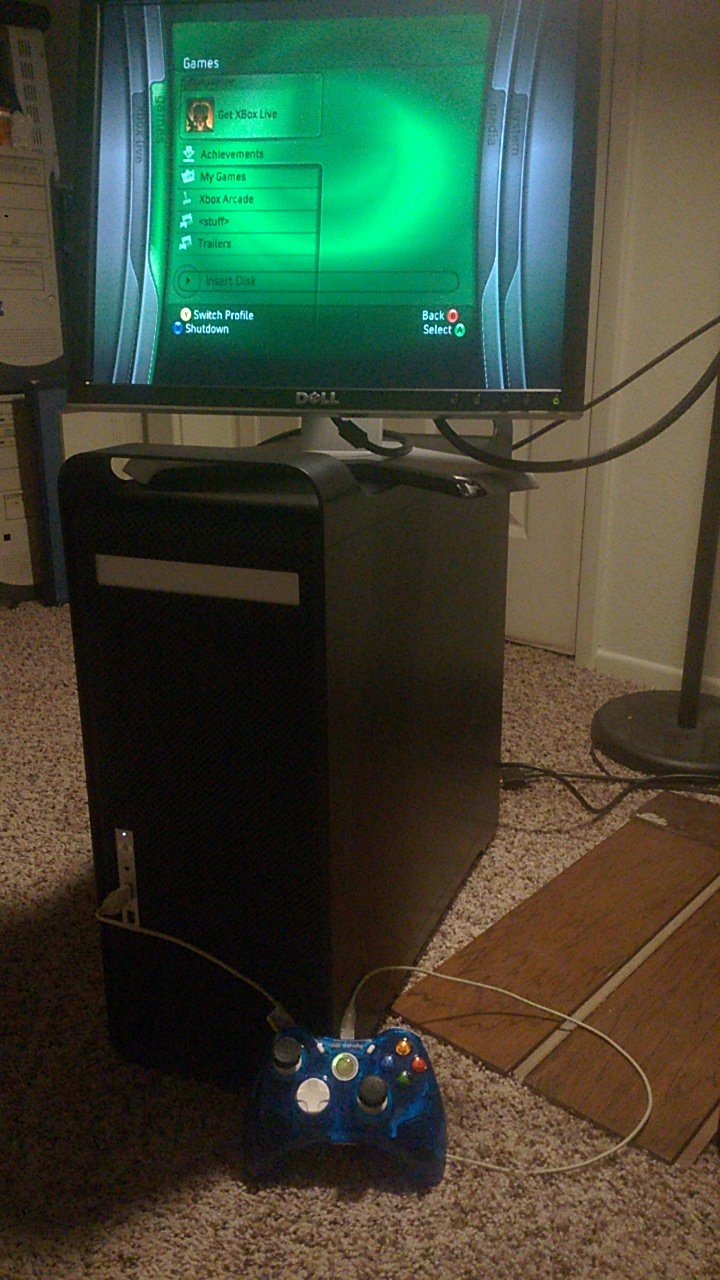

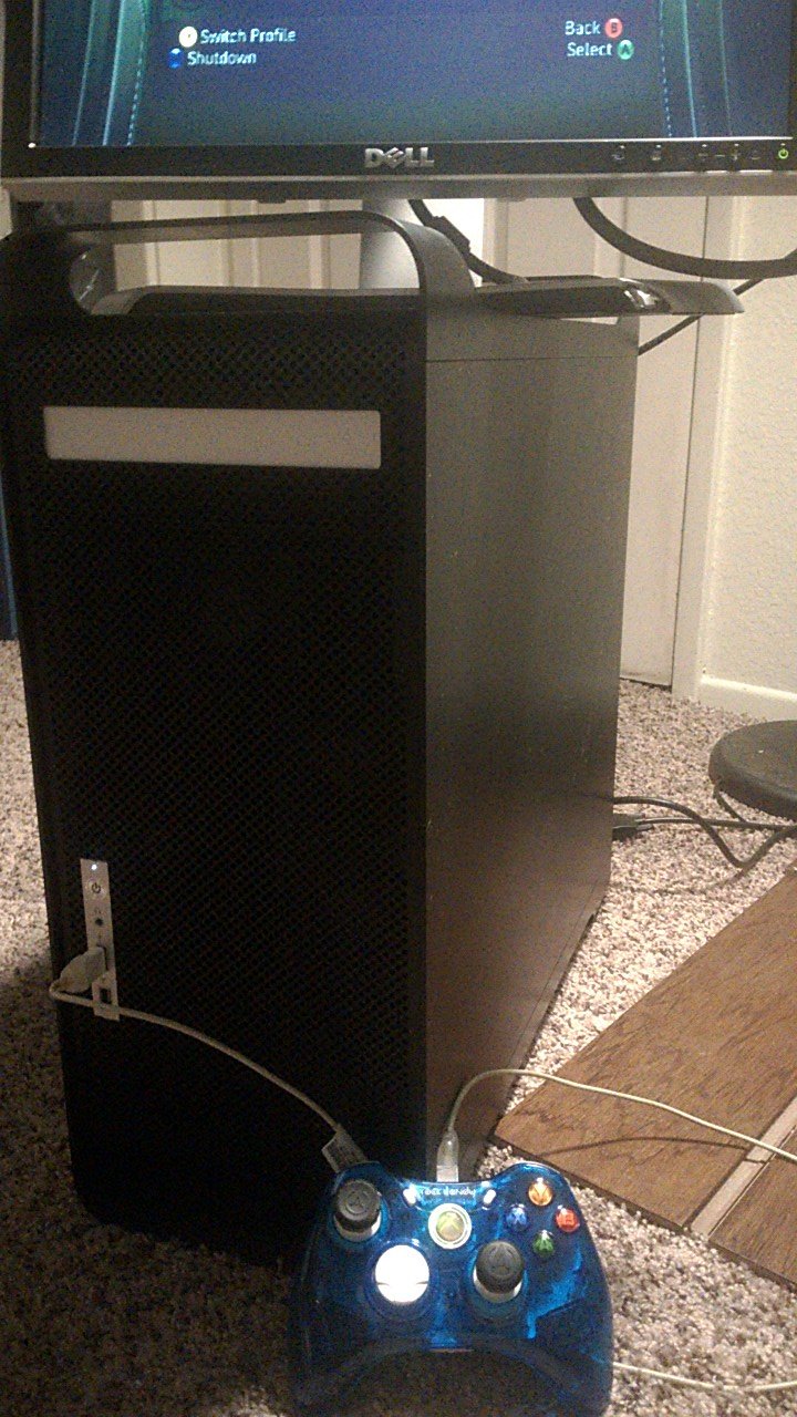

    Got my Alpha Kit up and Going in my Custom black G5 :D

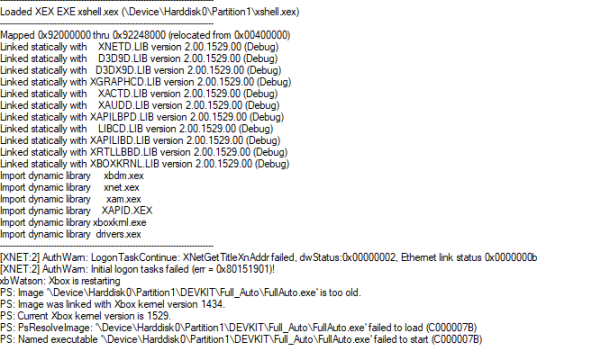

    Something interesting for you guys to try..
    press L + R + UP(d-pad) while on XENON Launcher.
    it will go to a black screen,
    press L + R + DOWN
    it will go back.
    this is what xbWatson shows when doing this.

    So out of curiosity, is there absolutely no chance to convert beta / retail XEX files to work with the alpha kits?
    It's probably too early to answer this question, but maybe someone had a peek into these things.
  20. Shadha
    Shadha #LongLiveTheBromanRevolution
    Feb 12, 2018
    76
    74
    well we have a copy of Full Auto and its very close, you would think it would work, but it doesnt, maybe someone can (and i really do hope) they can get a 360 build to run on it, but the kernel went through such rapid kernal changes, that who knows whats possible.
