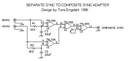

    As I stated earlier in this thread, the XRGB-mini will take 31KHz RGB (VGA RGB) if you combine the horizontal-sync and vertical-sync into a composite sync signal and feed that to the Framemeister. The Dreamcast does have a composite-sync output but it is inactive when VGA mode is turned on so you must make that signal yourself using the h-sync and v-sync signals. I did that and posted pics in this thread, but the schematic to do so is below.
    Alternatively, you can use an Extron interface that will take the VGA signal and output it as RGBS out through BNC connectors and then use a BNC->SCART cable to connect it to the Dreamcast.
    Or you can use one of those VGA->HDMI adapters and feed it to the Framemeister's HDMI ports, but usually those boxes are low quality and I wouldn't recommend them.

    Hm, I'm going to have to doublecheck the connections in the cable- it also doesn't output on a composite monitor with scart input, so maybe the cable's faulty.
    my modified adapter works fine with everything else i've tried- saturn, psx, ps2, wii...
    Haven't had a chance to try the megadrive2 or sfc yet.
    Which extron adapter is this you speak of?
    Interesting notes about the vga sync situation, but I've been so impressed with 15k via the xrgb that I was hoping to use scart instead of vga, and it'd remove the issues with the dreamcast vga incompatible games.
