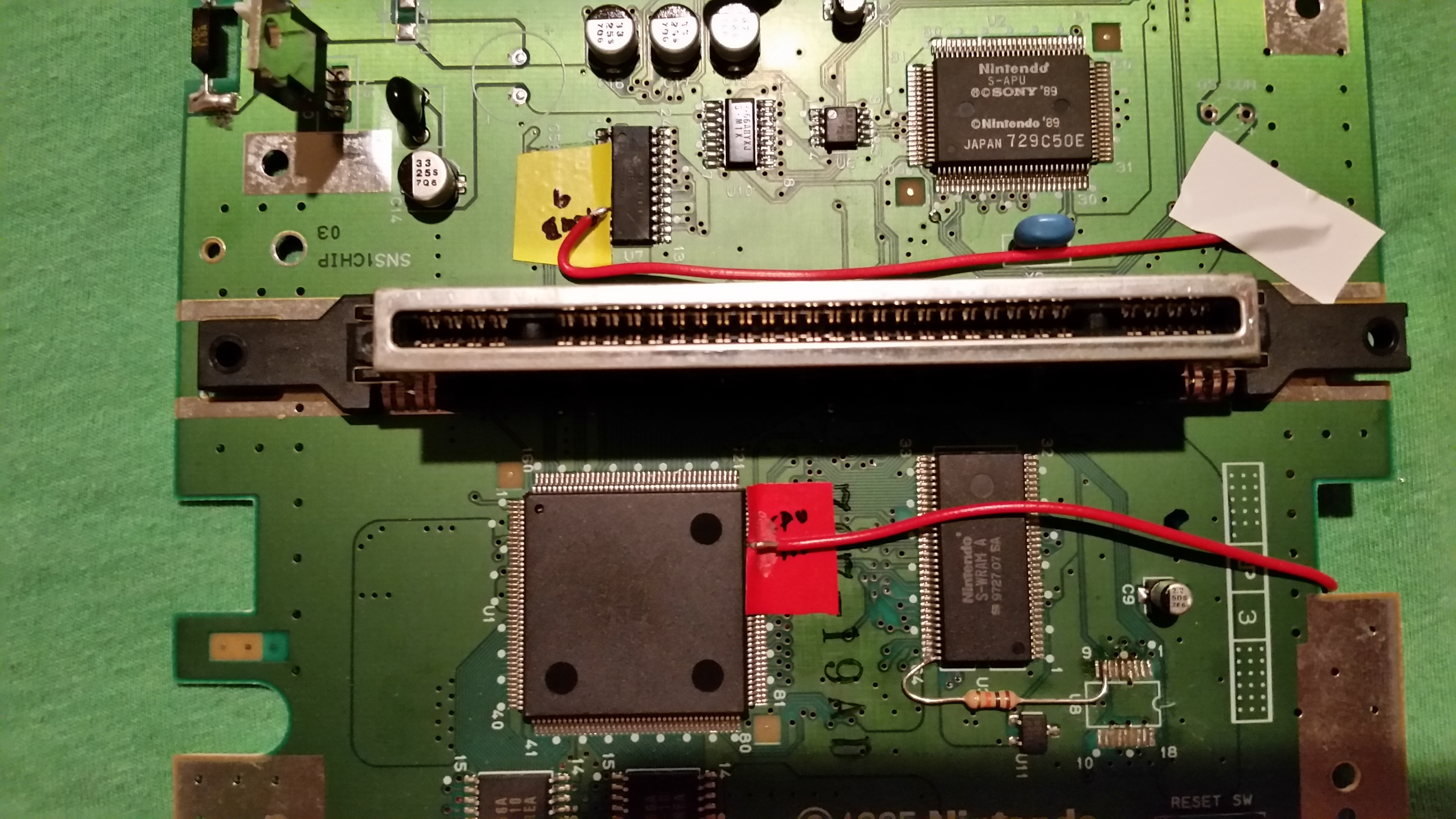

    There we are, corrected. Thanks Kel & Borti, will give it a go installing this weekend.
  2. Bad_Ad84
    1,311
    The X1 right bit you can remove, TC1+ works for both the mini/jr and the "phat" snes.

    I too can confirm that Palthe's board design works :)
    Here are some pictures of my install:
    http://i40.photobucket.com/albums/e236/Konsolkongen/Various mods/DSC_0086_zpssloaiqsg.jpg
    http://i40.photobucket.com/albums/e236/Konsolkongen/Various mods/DSC_0082_zpscfzuqxff.jpg
    And here's some of the jailbar fix (which works perfectly, thank you very much Max War :) ):
    http://i40.photobucket.com/albums/e236/Konsolkongen/Various mods/DSC_0084_zpszv7wxlwt.jpg
    http://i40.photobucket.com/albums/e236/Konsolkongen/Various mods/DSC_0083_zpsvotulli7.jpg
    I wanted everything to be detachable from the mainboard in case I ever needed to add other mods. It turned out alright I think.

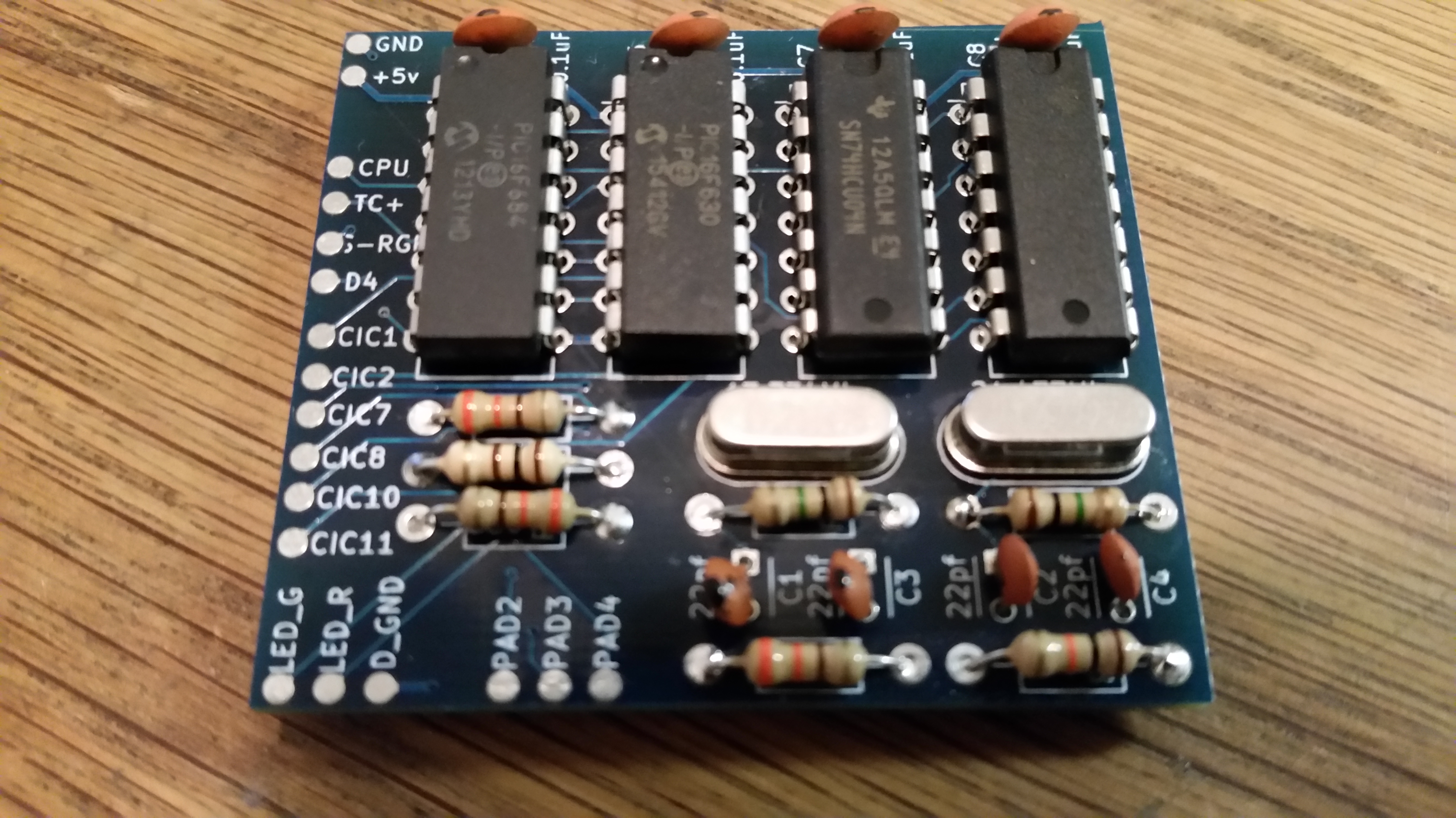

  16. Gredde
    Gredde Member
    Apr 6, 2016
    Hello again all,
    I am sending a picture of Bad_Ad84's custom board b/c I have a few questions about some points. Just asking where these points are on the SNES board and please advise/correct if my guess is wrong, I am going off attached layout:
    Gnd (got it)
    +5v (got it)
    CPU (s-cpu pin 9?)
    TC+ (snes Jr only?)
    S-RGB (s-RGB pin 9?)
    D4 (?)
    CIC 12781011 (got it)
    LED G&R (I assume to replace current lamp, but is it okay to use a multi color lamp [I think the one I bought outputs 3 colors] and is there anything more to it than maybe using some resistors? Also is D_GND used for the lamp, if so, good spot?
    PAD 2-4 (?)
    Sorry for the long list, I'm obviously novice, but trying to get better with circuitry. Let me know if attachments don't work. Thanks in advance!!!
  17. Bad_Ad84
    1,311
    Are you installing in a 1chip console?
    If so, CPU goes to SCPU pin 111 (and must be lifted from the board)
    TC+ is correct on both Snes JR and 1chip phats
    D4 - do not use this, its for an addon that currently I dont sell (but you can use other D4 patch boards)
    S-RGB is correct - S-RGB pin 9 (and must be lifted from the board)
    Pad 2-4 are to pins 2, 3 and 4 on controller port 1.

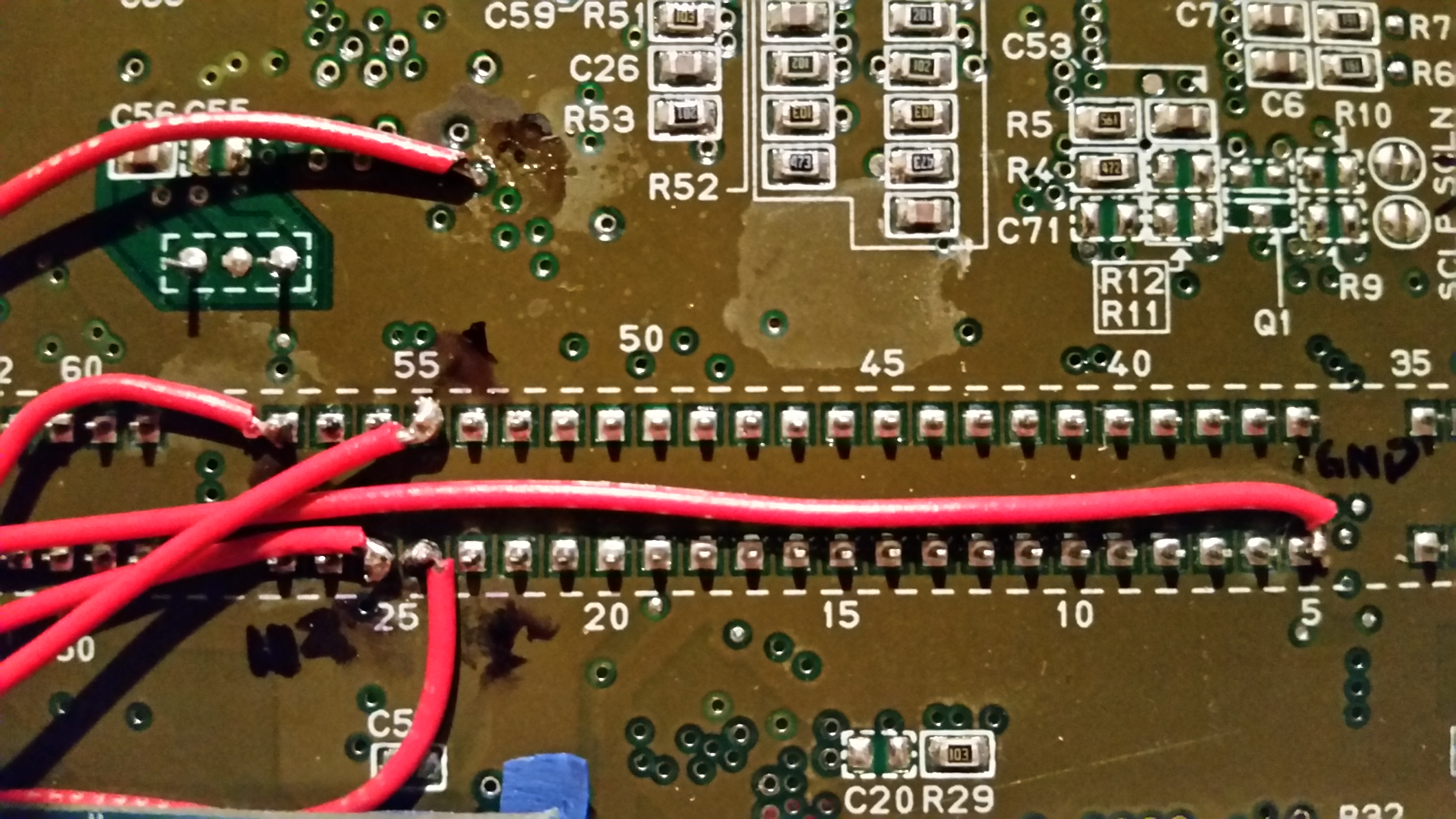

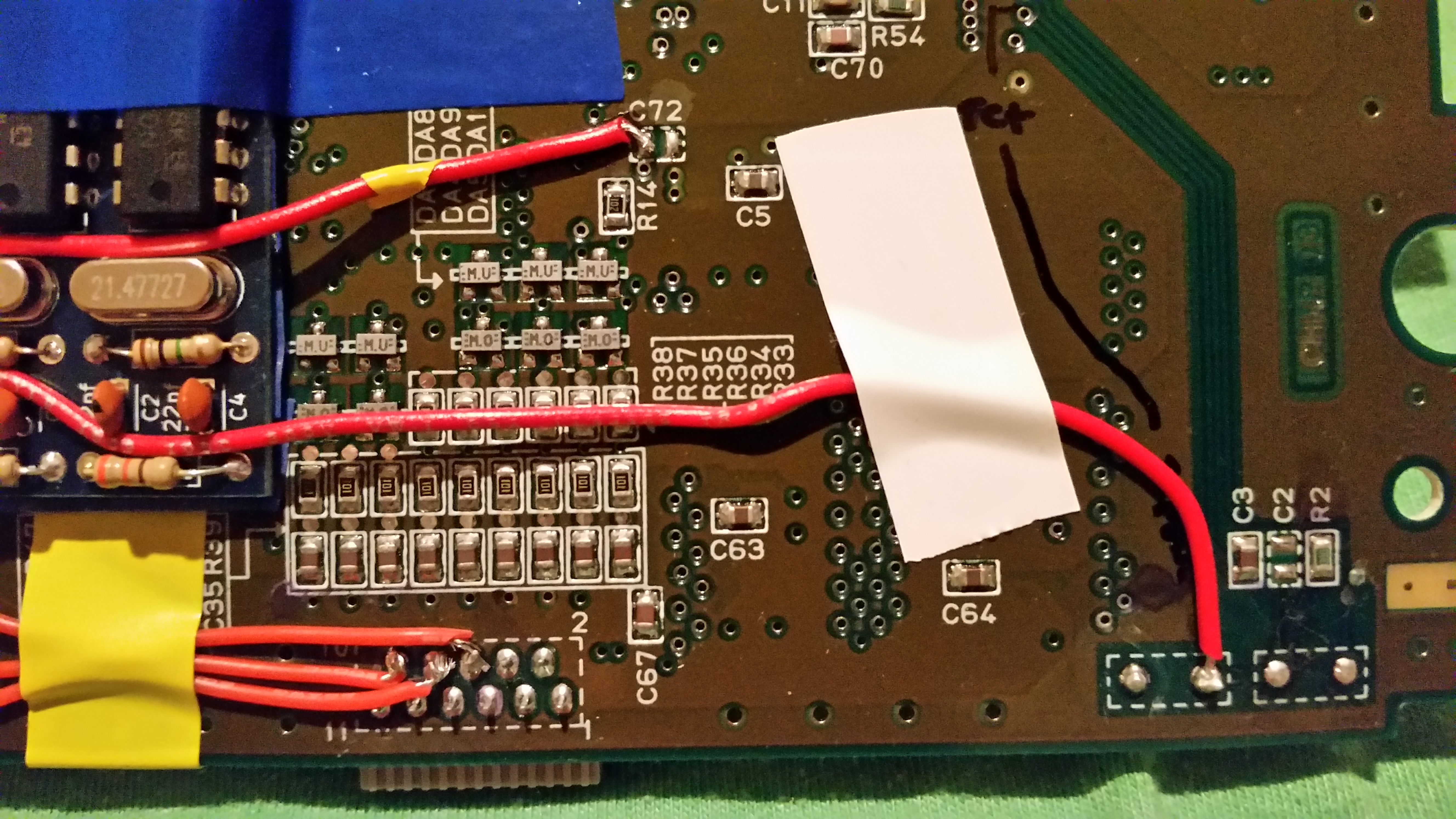

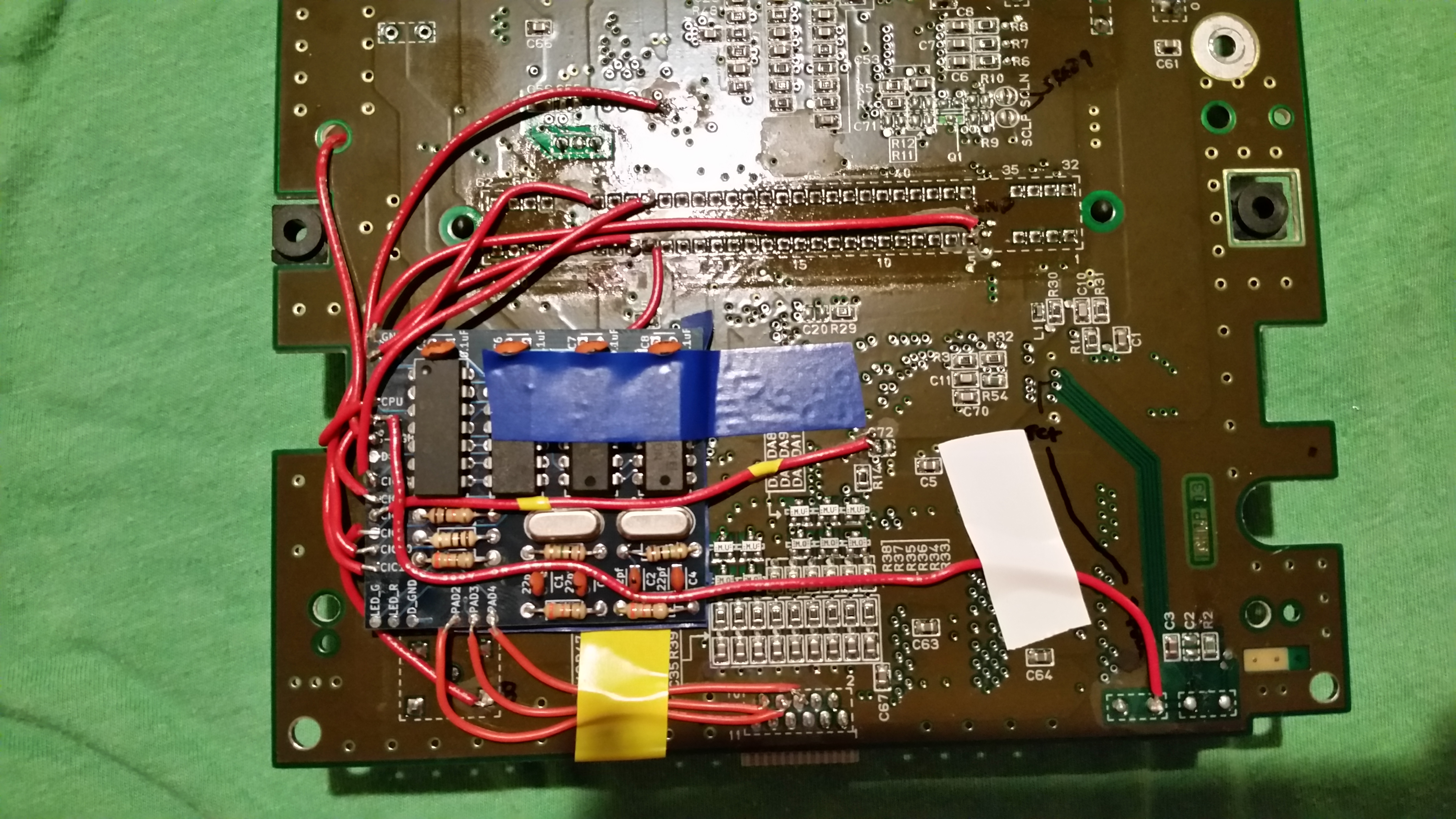

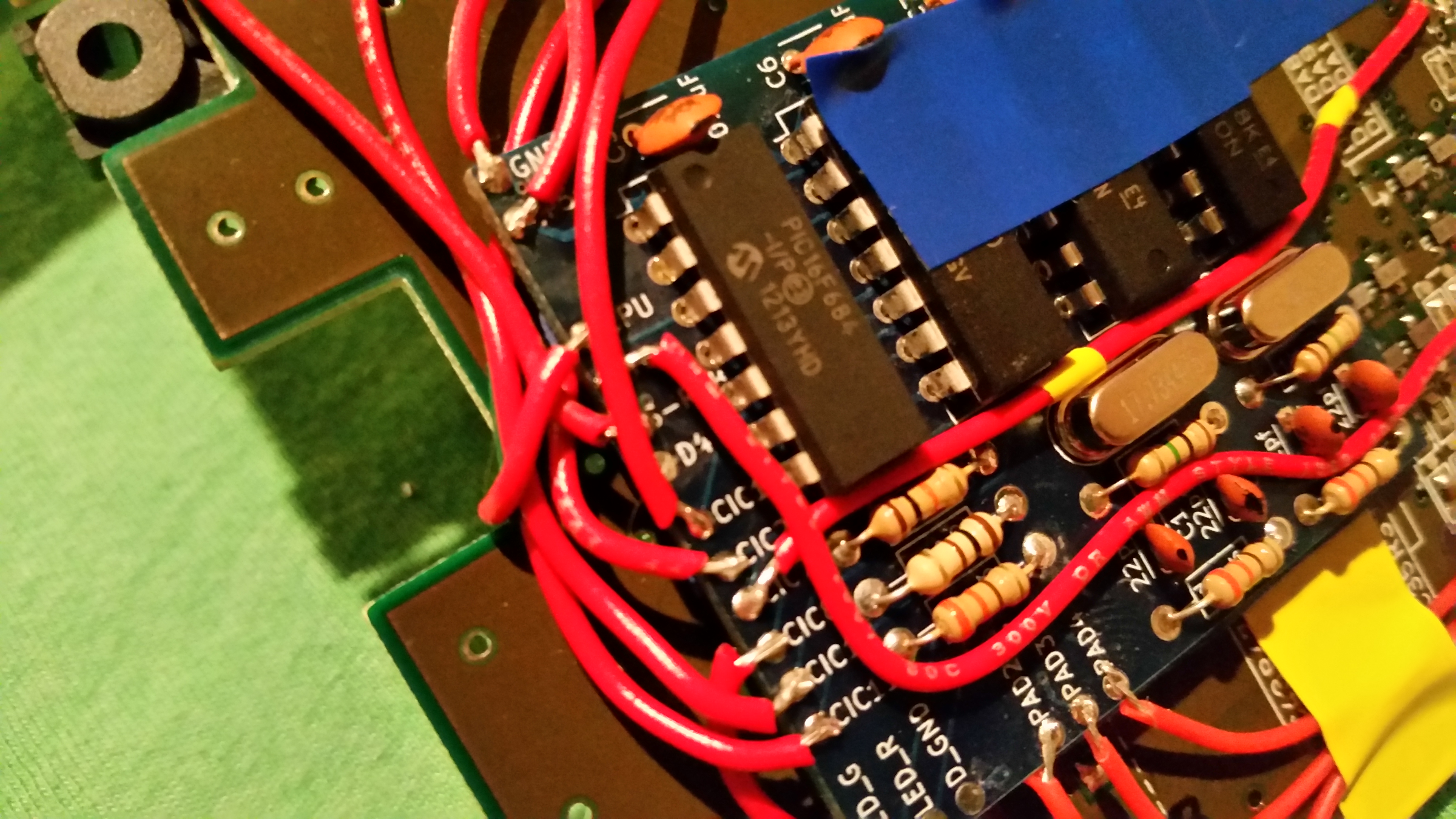

    Hi again everyone.
    I'm still not finished with the mod and I've run into trouble.
    I'm attaching pictures to help you diagnose. I chose to attach the super cic to the alternative points on the back of the board rather than the removed cic on the front. I have sound but no picture. What am I missing? Can anyone tell from the pics?
  19. Bad_Ad84
    1,311
    You dont need the resistor on the CIC pads - its built into the PCB.
    Have you removed the original crystal? it looks like its still installed from the solder at the back (and no pic from the front)
  20. Gredde
    Gredde Member
    Apr 6, 2016
    Okay, thank you on the resistor.
    Yes, the original crystal is removed.
    I'm going to check once more on all the contacts to make sure there is nothing touching that shouldnt be.
    Anything else you can see?
