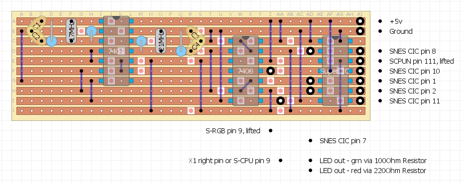

    Thanks heaps for your stripboard design Kel! Great idea, I love using stripboard. I'm not using an IGR in my mod, so I've borrowed your design and tried to redo it minus the IGR. Have triple checked it, just want to run it buy you guys before implementing. Cheers!

    Should work ;) (I have printed it out and checked it)
  18. kel
    kel Spirited Member
    Aug 13, 2012
    103
    No problem Palthe, I'm glad it helped you make your redesign without IGR. I'm sure your redesign will help others too that don't want to include IGR like yourself.
    It looks like it should work to me it also.
    I did notice a few unnecessary wires and breaks but nothing that would cause any problems.
    Wire N,E - N,J
    Break R,E & R,J
    Break AB,C & Wire AD,A - AD,C
    You may also want to Change text "X1 right pin or S-CPU pin 9" to "TC1+ or S-CPU pin 9" for anyone that would like to use it with a SNES mini. My fault as I still haven't got around to changing it myself yet.
  19. Palthe
    Palthe Newly Registered
    Jul 14, 2014
    Thanks Kel, I noticed the wire NE - NJ myself shortly after posting, but missed the other breaks and wires. Looks like i wasnt thinking creatively enough, forgot AA,A - AA,C would supply 5v to both chips. Might provide an opportunity to compact it further :) Will tidy it up with your suggestions.
    Thanks again!
