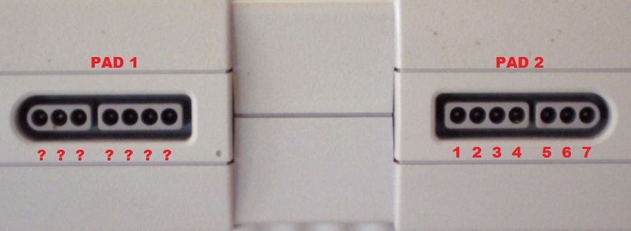

    For the keypad connections, in the German redscorpion & thix diagram, you can see the image from a key pad port 2, not pad port 1.
    I’ve attached a image with the diferences between both ports,
    In these case, Can you confirm me the pinout for pad port 1 related with this image?
    Many thanks!!
  10. Bad_Ad84
    1,311
    pad 1 is 7 6 5 4 3 2 1
    The instructions are just showing you the pinout of the connector.
