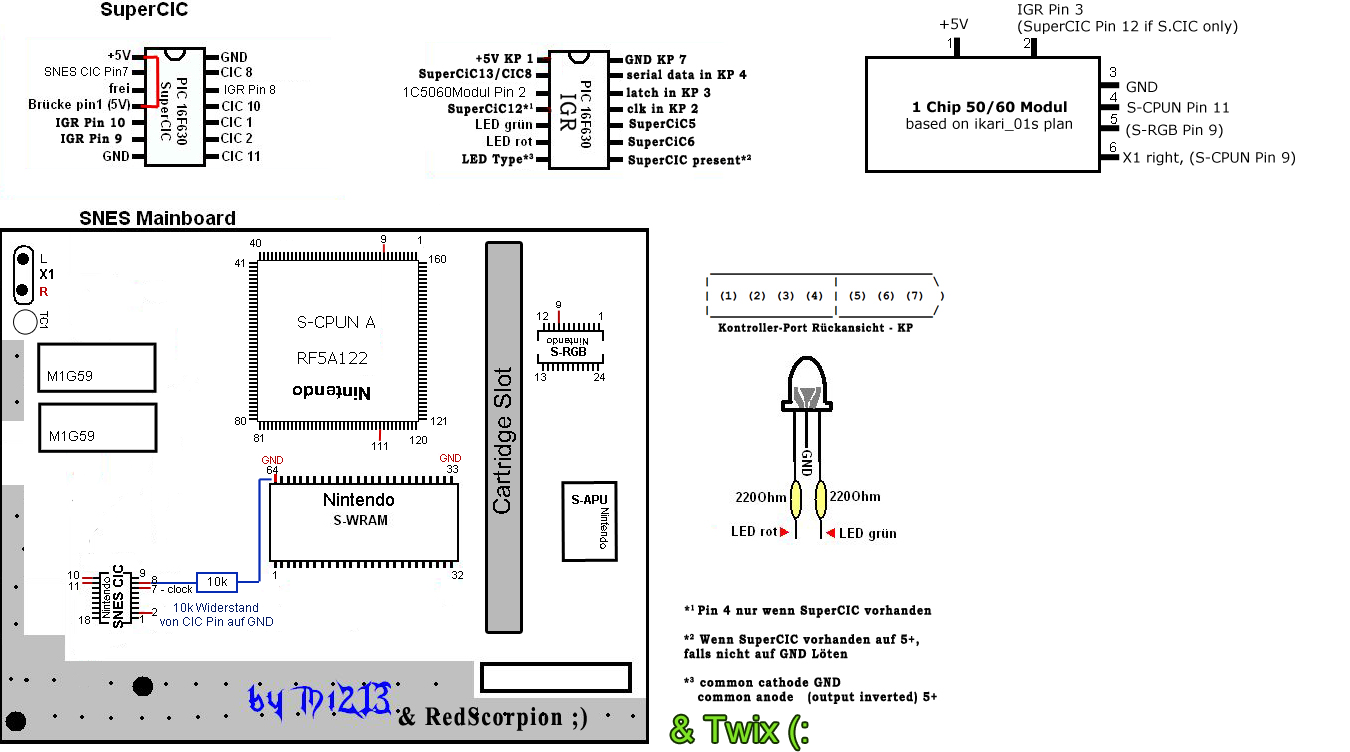

    ^ will do, thanks for the advice!
  2. Bad_Ad84
    1,311
    disregard what i said, use the v2 diagram which covers that
  3. keropi
    keropi Familiar Face
    Feb 2, 2011
    1,068
    64
    oh cr*p, I need to fix it then since I used the image posted here (v1)
  4. Bad_Ad84
    1,311

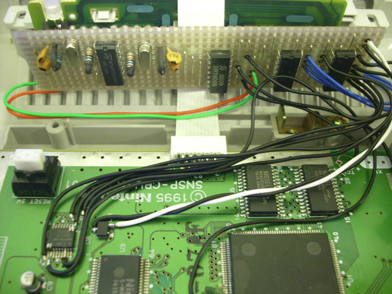

    I have just (as in, 20 seconds ago) just finished and tested this mod. Works fine using v2. I will post some pics in abit
  5. Bad_Ad84
    1,311
    Just to point out, I did the IGR mod at the same time.
    Pictures:

  6. keropi
    Feb 2, 2011
    1,068
    64
    thanks for the pics, I never thought of installing the 50/60hz with this orientation :)
    and the IGR connections that are on the mobo is a great idea too, will do the same!

    wow, had a good look at that German forum link, the v3 diagram is the one with the floating pins and the v2 diagram is the one with all pins in use on the 74HCU04... the v3 is supposed to be a "simplified" version according to translation ... I don't really see much of a simplification TBH, you just have 2 solder blobs less... :eek:ffended:
  8. Bad_Ad84
    1,311
    V2 is exactly the same as ikari's original schematic.
    V3 has some differences and shouldnt have floating pins.
    Also, Ikari's original (v2) is what I used and it works fine
  9. keropi
    Feb 2, 2011
    1,068
    64
    yeah I'm going with the v2 too, I just spent some time now to actually check the differences and was amazed to see that v3 isn't really that simplified... meh
    at any rate, thanks again Bad_Ad84 for the heads up! :smile-new:
    edit: as a sidenote I have corrected the following diagram, the original had wrong GND points on the S-WRAM chip, this one is correct since pin 64 is GND , not pin1 ...
    edit2: and here is for reference the diagram for the 50/60hz switch that is based on ikari01's design and leaves no floating pins like Bad_Ad84 pointed out, I can confirm too that it works perfect

    well, today I installed the super-cic + igr mods too, here is my spaghetti snes:
    I will continue tomorrow with the 50/60hz switch installation, I hope it works LOL

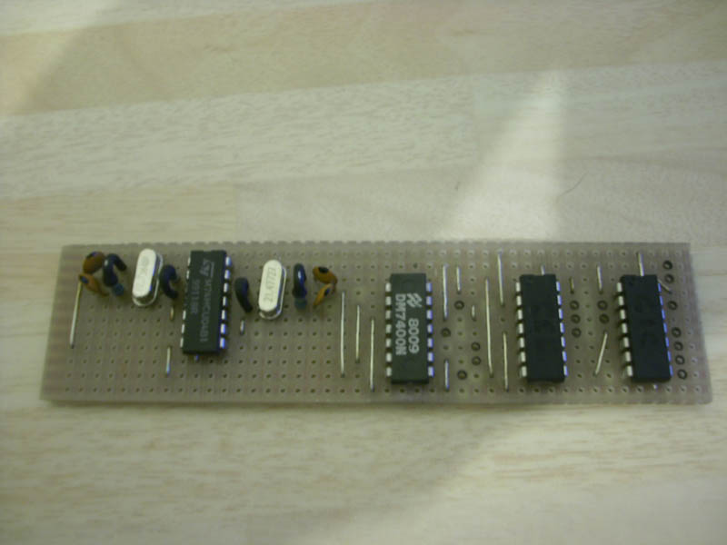

    For anyone that wants to do this mod to their 1CHIP SNES but can't be bothered to work out which pins connect to what, I have made an easy to follow stripboard design.
    I've left a spare line each side of the crystals on purpose to avoid the legs of the upright resistors from accidentally touching the crystals outer casing and shorting out.
