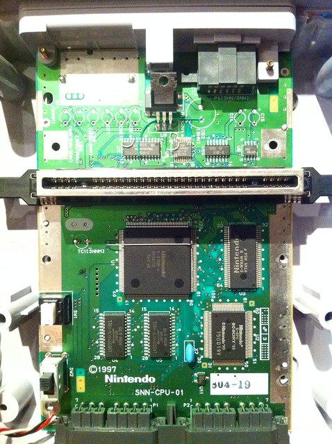

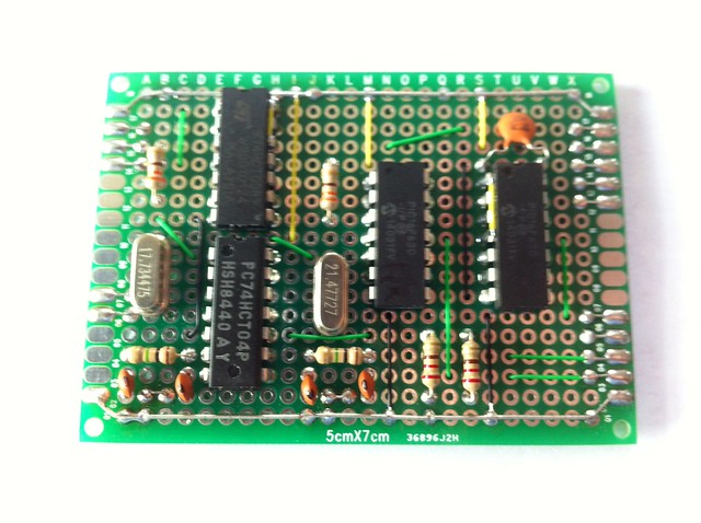

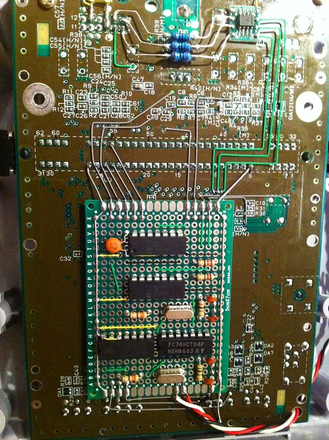

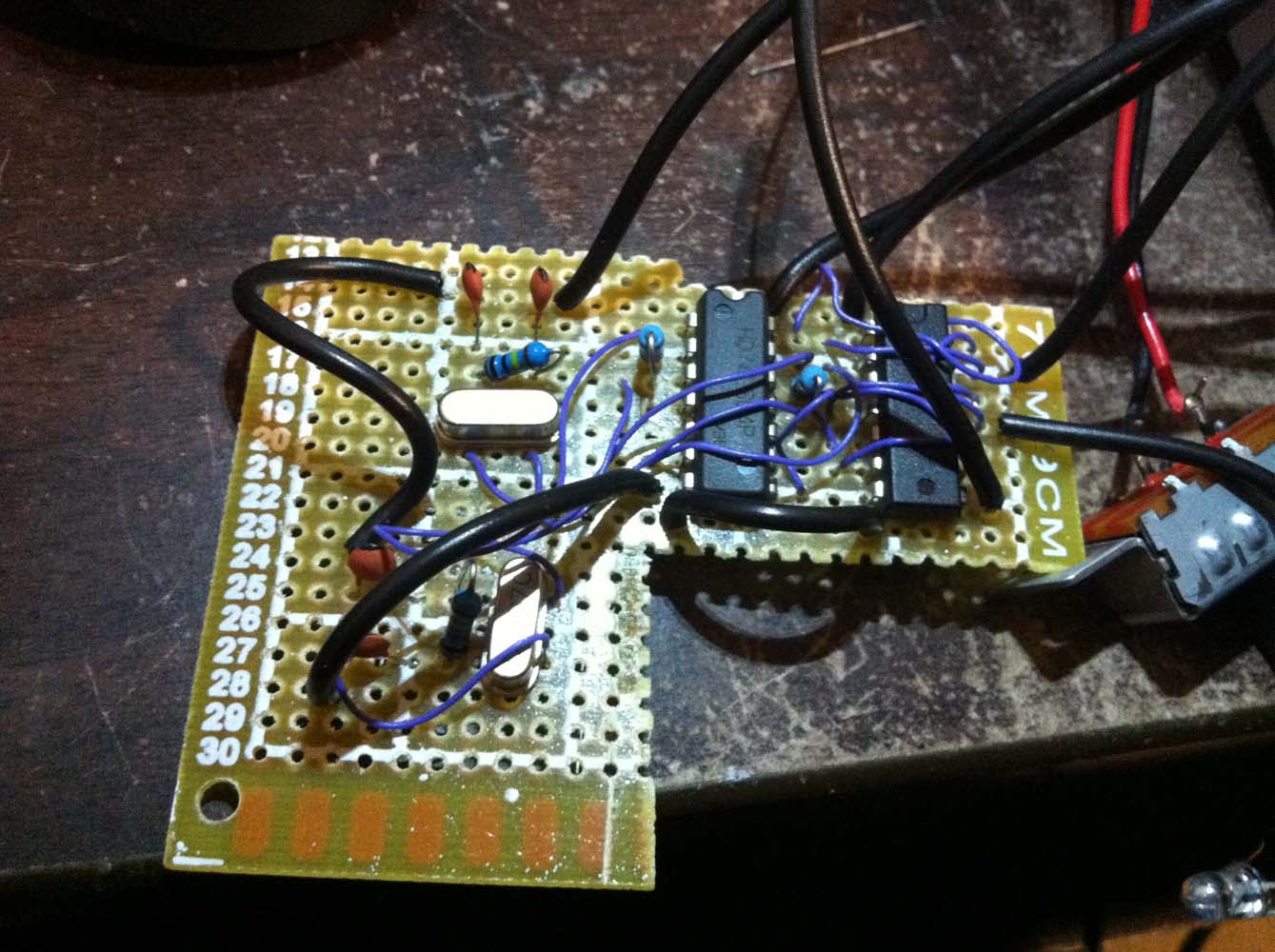

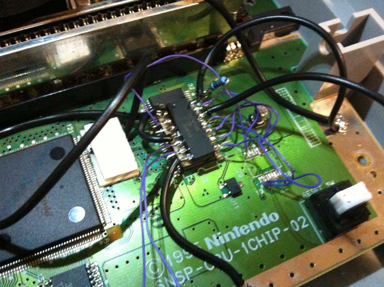

    Hey guys,
    Finally got around to trying this mod out. I have done heaps of normal SNES's using the CIC.
    Now I get nothing happening. TV flicks but I do not get a display and the AV icon stays on screen. This normally happens when I try an incorrect region cart in a non-modded console. I am suspecting its something to do with the SuperCIC.
    The reason i say this is that the tri-led does not even switch on at all. The console is getting power and the SuperCIC chip is getting 5v. What could be the issue here? I have buzzed out all points to the CIC. I am getting 5v from the voltage reg. I have written a second PIC and same issue.
    Should the LED's light up by just giving power to the PIC? I am sure that this is the case.
    Below are some pics of my 50/60 board and also the PIC wiring. Please help!! :)

  7. Mamejay
    Mamejay Robust Member
    Sep 19, 2010
    258
    I have done more testing and now I am completely stumped. I used one of the PIC's I programmed in another SNES and it worked fine so this is not a PIC issue.
    I found on the working one that you need at least CIC pin 7 connected to the PIC as well as power and ground to get the LED running. I tried this on the new one and sometimes it came on and a lot of times it did not.
    I tested the voltage of the working console and it is running at 4.97V. The non-working one is running at 5.12V. Could this cause an issue?

    Just a couple of things. For the IC's I am using a 74LS04P and 74LS00N
    Could this be causing the issue? Please be kind as I am not great with some of this stuff.
  9. borti4938
    borti4938 Robust Member
    May 8, 2014
    205
    64
    I'm not quite sure, but on the picture it seems to me that Pin2 of the PIC is connected to Pad8 of the CIC. This should be Pad7, of course!
    However, you may use alternative points at the cart connector for pad 1, 2, 7 and 11.
    - Pad 1 -> Pin 55
    - Pad 2 -> Pin 24
    - Pad 7 -> Pin 56
    - Pad 11 -> Pin 25
    This might prevent additional errors.
    Have you measured the clocks output on X1? It might happend that the 74LS04 prevents the crystals to start their oscillation...
    Best
    Edit: I've seen the cables to Pad 7 and 8 are crossed - sorry for my mistake... However, you can test your clock circuit without being installed to the SNES... You have to connect Vcc and GND as well as a switch at the input of the S-CICs signal. If you switch the input to Vcc, you should have 17.734MHz at the clocks output, and 21.477MHz if you switch to GND.

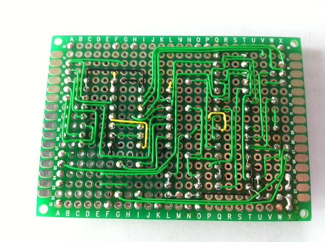

  13. Mamejay
    Sep 19, 2010
    258
    OK. So I rebuilt my circuit using Kel's perfboard layout minus the IGR and SuperCIC. I found a 74HC04 on a junk arcade board and used that. Success!! What a nightmare this one was. Probably as I have never done one before. I must say it work seamless just like the normal SNES models.
    Not sure if my problem was the 74LS04 or the way I setup my board. Anyway live an learn.
    Thanks guys for the help

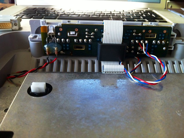

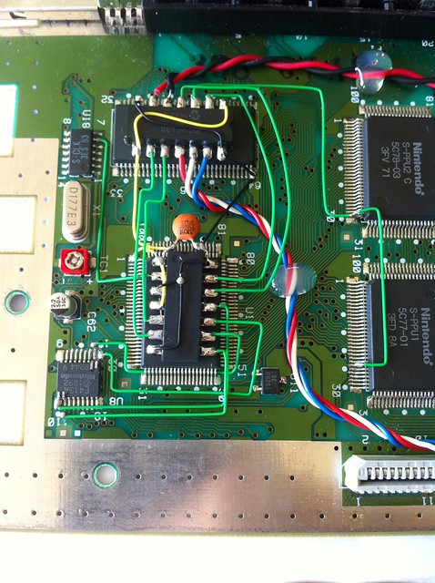

  15. cam
    cam Member
    May 7, 2014
    Hey,
    I would like to share my experience here with everyone :)
    I did order SuperCIC + IGR for a PAL SNES from Bad_Ad84 (for those wondering, everything is included - even a cap to put on SuperCIC power pins which wasn't mentioned in any pages I read about this mod)
    so huge thank you to sir Bad_Ad84 for the programmed chips AND, of course, thank you to Ikari_01 for all the work he's done to get this SuperCIC working!
    [​IMG] [​IMG]
    Next on the list is SNES mini I got in May :)
    EDIT: The wonderful news is that my Secret of Mana cart is working very fine now on this PAL SNES! It wasn't working with the adapter for NTSC/NTSC-J games.
  16. borti4938
    May 8, 2014
    205
    64
    Great clean work - I like that :D
    But I was wondering about the cap. Why use a cap at the SuperCIC and not at the IGR. At the IGR it is even more important as this PIC uses the internal clock...
    BTW: The "cap-problem" is something I've never thought about although it is commonly recommended in digitial circuits to use ~0.1uF caps at power supply pins. That's why I changed my entire PCB designs a few weeks ago after I've seen it in Bad_Ad84's designs. Thanks to him at this point for open my eyes for that problem :D

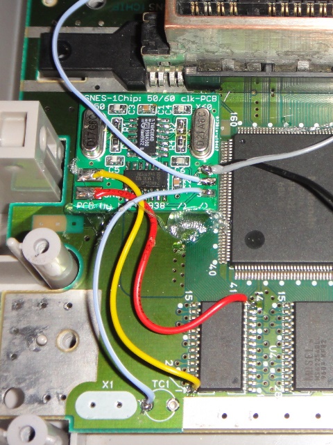

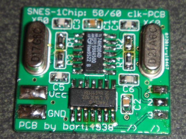

    Can't wait to see your work with the SNES-mini ;) Will you use the entire PCB of Bad_Ad84 or do you solder everything on your own? Another opportunity is to use just a PCB for the clock switching network like this one here I made for another project of mine:
    1 - is the mode-input
    2 - is the inverted mode (for the S-RGB if someone wants to use it)
    3 - clock output

  18. cam
    cam Member
    May 7, 2014
    Hey,
    I did connect it to ground, I believe I made the mistake while I was drawing the wiring scheme, Thanks for pointing that out! I just did notice that I forgot a wire as well... (SuperCIC 13 to CIC 8). Will modify this tonight.
    I used to mod Wiis and PS2s so I had time to get used to solder with AWG30 wires and I like to make it clean because in case of complicated wirings like I used to do on Wiis (was around 30 wires) it is easier to troubleshoot ;-) By the way I do like your PCB design, I would have done something like this if I had access to what's required to manufacture it.
    Regarding the mini console, I'm waiting for a few parts to arrive before I start on it. I plan to make a PCB design of my own (like kel) and solder everything to it (50/60hz 1 chip mod + SuperCIC + IGR) and I'll try to put it on the left side of the board. I will take pictures of it and share it here.
    EDIT: Just tried to change the clock with reset button and it was not working because of the missing wire. I had issues also on PAL games (as Borti3948 said - blue screen) at first start of the game but I still could play the game.
    I did fix both issues and now it's all good! Thanks again :)

    Here is the pcb that will go in the SNES mini :)
    Is just have to solder it now, I'll post new pic when done with it.
    EDIT: pictures with pcb soldered to motherboard :) I couldn't confirm CIC pin7 on the cart connector so I soldered it on the CIC.
    I removed every cap of the motherboard to change it all for brand new ones to extend the console's life. Just need to solder the new ones and put back heatsink and everything should be fine.
