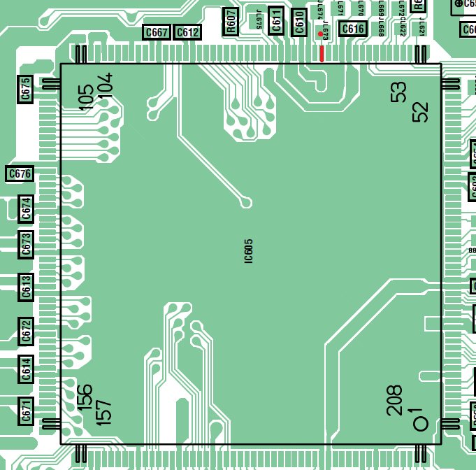

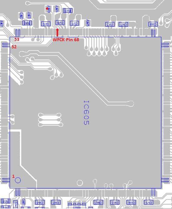

    Gate I assume is WFCK which is point 59 (JL673 point) on 3000 machine on IC605 (same ic that has the SX point) on a 39001 is pin 68 (also JL673). MM3 has pin 5 labeled as GATE and that is WFCK on the PSOne so I just looked up the same point on the ps2.

    65
    If WFCK is "GATE" then this is it on a 39001

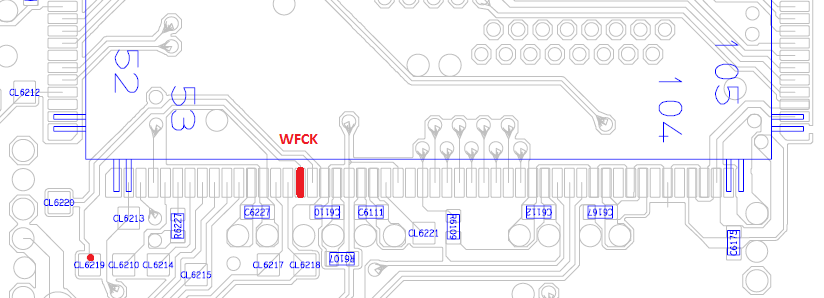

  8. Apexseal
    Apexseal Spirited Member
    Aug 15, 2016
    131
    65
    Here's V10 (GH-026) WFCK

  12. Apexseal
    Aug 15, 2016
    131
    65
    V9 WFCK Seems the same as 39001...

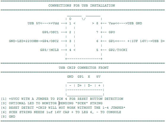

    Bored... Gonna try a 4 wire install on a PSX to see if it boots them all too... Actually 3-wire LOL
  19. Apexseal
    Aug 15, 2016
    131
    65
    It worked LOL... Have a great weekend!
  20. Apexseal
    Aug 15, 2016
    131
    65
    Here's the pinout I'm using just in case you want to try it:
