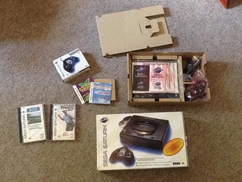

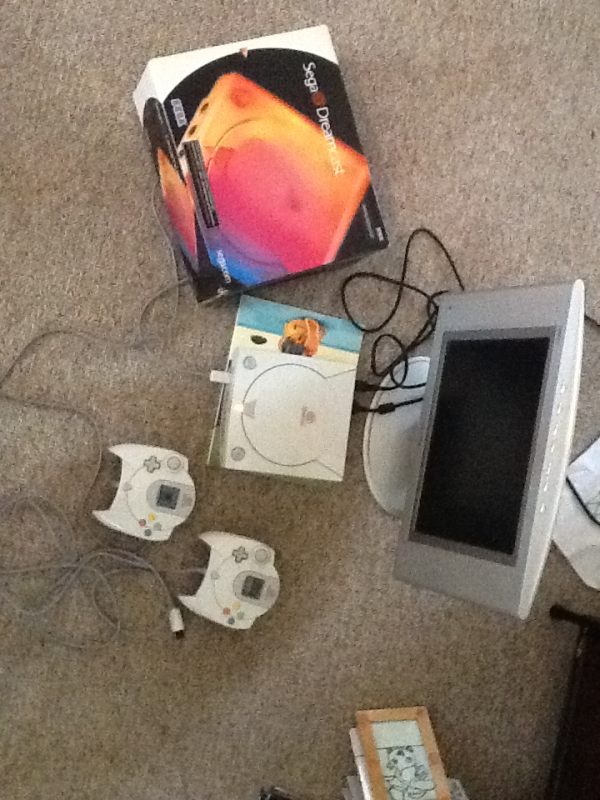

    Whilst everyone's feeling the love for Model 1s; it was my birthday a few weeks ago, and I told my wife I'd like a Dreamcast (I sold my last one when we were broke a few years ago). Sure enough the day rolls around and she presents me with this:
    I'm totally happy with this, but she loves a surprise, and half hour later she pulls out another big box, you know, big like console boxes used to be in 1995...
    Like new launch console, she got it off a guy who is a golf fanatic, he was housebound for a while and his wife bought him this, pretty sure it might have had less than 2 hours of use ever.
    Not rare of course, but I was super, super stoked! Of course it's sporting a modchip and a 4-in-1 now and making up for 18 years on inactivity.
