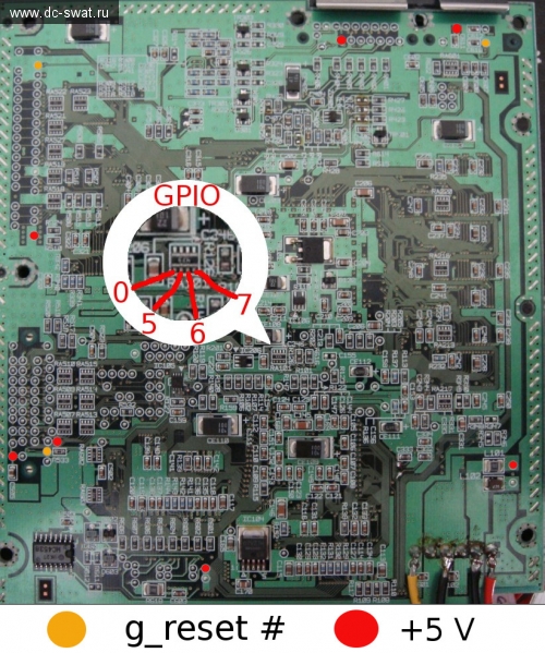

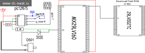

    Apparently there's a new bios available that allows you to load Dreamshell directly from the HDD instead of SD card. I've looked around on the SWAT site, but I can't seem to figure out what's going on. Here's the link to the thread on SWAT, but I don't understand Russian.
    Here's the thread on SWAT: http://www.dc-swat.ru/forum/thread-2217.html
    Here's a link to the instructions and diagrams to modify the bios mod to enable this: http://www.dc-swat.ru/blog/hardware/988.html
    This must be a VA2 motherboard in the above picture as I've got a VA0 and VA1 sitting in front of me. Here's a picture of my VA0 board (it's the same location on the VA1)

    95
    Confused about.
    "This must be a VA2 motherboard in the above picture as I've got a VA0 and VA1 sitting in front of me. Here's a picture of my VA0 board (it's the same location on the VA1)"
    whats the point of your image?

    The location of RA101 seems like a different location on the boards I have.

    Both boards have the same layout. Perhaps you are confused because that pic from the tutorial has a magnified image (that one in a white circle)?

    Well.. Shit... How did I not notice that. I just thought it was circled.. I guess there's no reason for this thread now. I feel like an idiot.

    How do you flash pic12f675?
  7. GillBert
    GillBert Spirited Member
    Jul 26, 2012
    101
    39
    You have to get a cheap programmer like this one or if your PC has a RS232 serial port connector you can build your own.

    Am i right in thinking that this is a bios replacement to boot dreamshell w/o the use on a sd adapter as well ?
  12. kai
    kai Member
    Oct 7, 2012
    I think this is going to allow us to load dreamshell directly from the HDD if you have the IDE mod installed. So the SD card should not be needed if that is correct.
  13. Kappa
    Kappa Peppy Member
    Aug 12, 2014
    346
    35
    ahhhh, great i can finally put this dreamcast to use

    this is interesting. So now I have to make JDM programmer. I think i have to make one now.
  19. alex81
    alex81 Rising Member
    Mar 27, 2010
    74
    You don't need programmer now.
    Now wee can flash boot_loader_unlock_G1.bios on dual bios mod and boot dreamshell directly from hdd w/out gd-rom drive and run game from hdd
