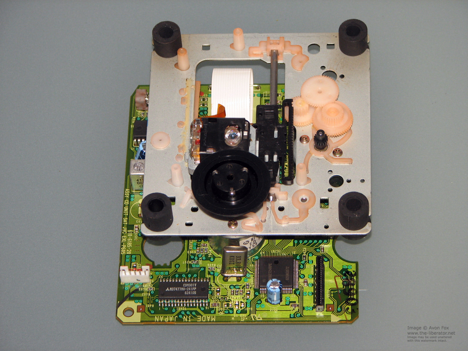

    i mean the side where the laser eye is.....................
    you can see in the below pic at the bottom left theres a chip there , this drive is a 32 Pin

    There is a photo of the machine on page 3 of this thread - it's using what looks like the JVC EXL-P605 drive and it's 32 pin. I just checked the cable on one of the machines I have here and it's 11.6cm long.

  8. TriMesh
    Jul 3, 2008
    2,324
    No - the pitch is too narrow.
    If you get really stuck, I can pull one of a scrap machine and send it to you, but it might take a while to arrive. If you don't mind having a grey reset button, I can send that too.
    Edit:
    And, as the other poster pointed out, the Saturn cable has the contacts on the same side on both ends.
    I just checked, and the full specs are as follows:
    Length: 116mm
    Stripped length: 4.5mm (each end)
    Contact orientation: Same side both ends
    Pitch: 1mm
    Overall width: 22mm
    On this cable, the precise marking is:
    E66085 (RU) AWM 2896 80C VW-1 BANDO-S
    (RU) = UL component compliance mark, like an inverted RU
