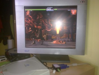

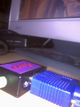

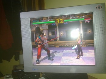

    Hi! I have the same problem! the led doesnt work for me (only the first time :nightmare:) , but vga works fine on my old monitor (My actual monitor only have hdmi), also doesn't support 15Khz, but i can play some games like Soul Calibur with a backup of DC-X or similar.

    Beharius said in PM that maybe he was sent 3.3v LEDs instead of 5v, so the LED probably died. Personally I prefer no lights, I have enough devices lighting up my room.

    2 possibilities, leds are of poor quality or they are 3.3v and must be wired with a resistor (like 150ohm) if so probably mixed the bags of 2 types(3.3+5v). It's weird because I tested them several times in different setups before sending.
    I apologize for the inconvenience I may have caused... Later models will be equipped with a resistor for sure.
    You can send it back for a repair, or diy... requires a led, resistor and hot glue to fix it properly.
    Sometimes small details we missed cause serious problems...
