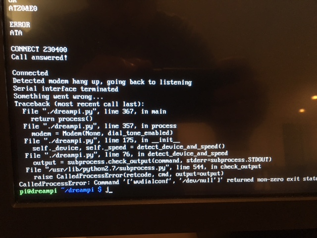

    Ok, I tested it and it failed fairly quickly. From the logs, it looked like it was hitting the timeout, so I extended it to 30 seconds and it seemed to work. But I haven't had enough time to check all the games, or do my usual battery of multiple tests.
    I did check 4x4 Evolution, and it went through all its servers... master5.4x4evolution.com then 4, 3, master -- before it finally got to master2.4x4evolution.com -- which is the only one that's up today.
    After that, the Dreamcast-Talk Chat Lobby did actually load!
    Update: I was able to do 2 calls in a row, after changing the time-out -- although it shows an ERROR on every call, it's not terminal. However, when I hung up the second call, it crashed trying to "go back to listening" right after "Serial interface terminated"
    Screen grab attached, since ssh into the Pi isn't working for me for some reason right now.
    I've got to get to work, but I'll try to do more testing tonite, and see if that error reproduces.

    Sigh... looks like there will be a 0.991 then!
    It looks like your modem doesn't like me appending "&E0" to the reset command, or at least, doing it more than once. I'll send it as a separate command. I'll up the timeout as well which I was supposed to do this time but forgot.

    @Jon Could you run: "git reset HEAD --hard && git pull -r origin master" from the dreampi folder and tell me if everything now works fine? (That command will wipe out any local changes)
    I don't want to make another release and then find out it still doesn't work :p

    Worked 7/7 with no interventions. I'd say we've got a winner.
