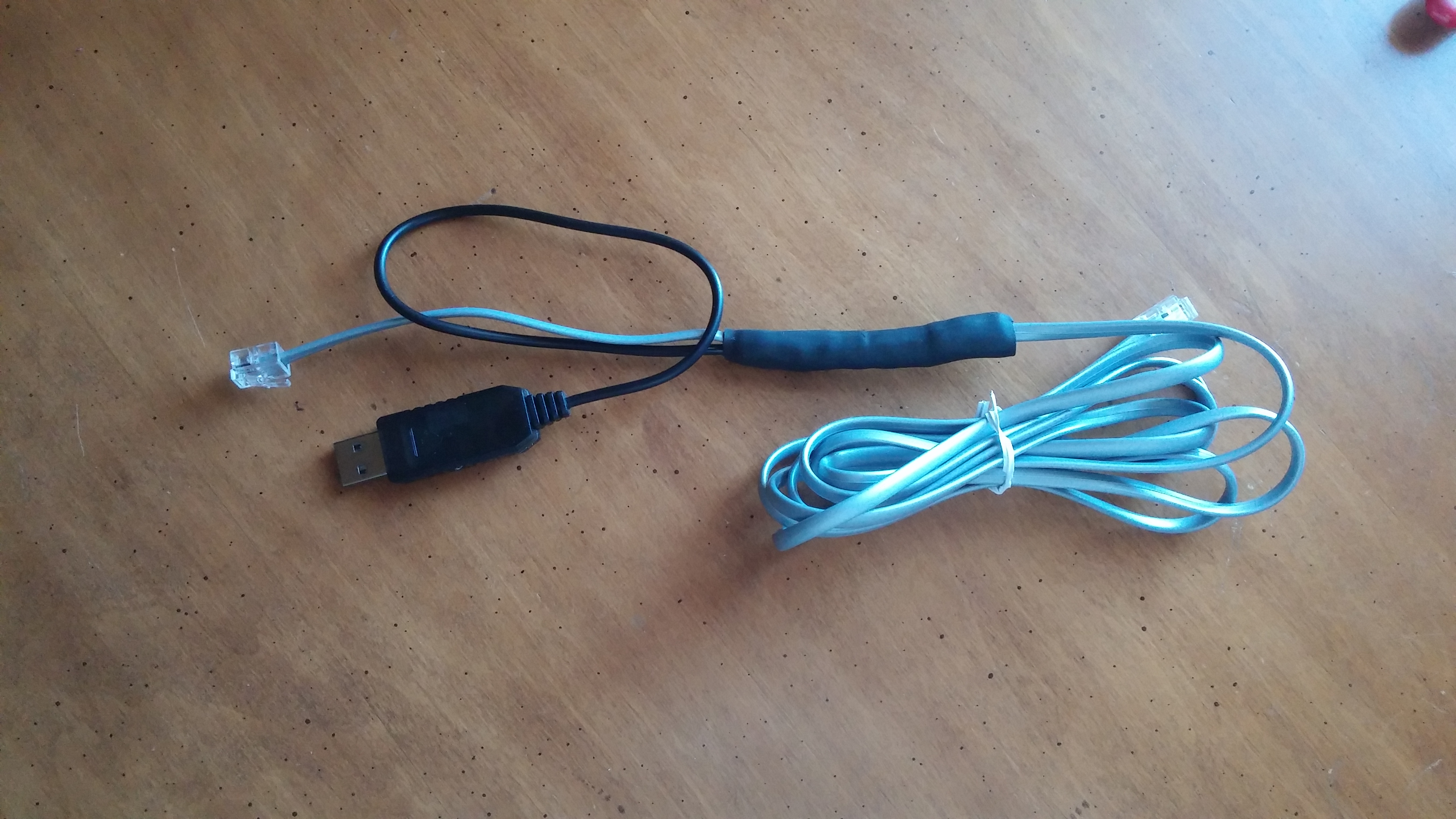

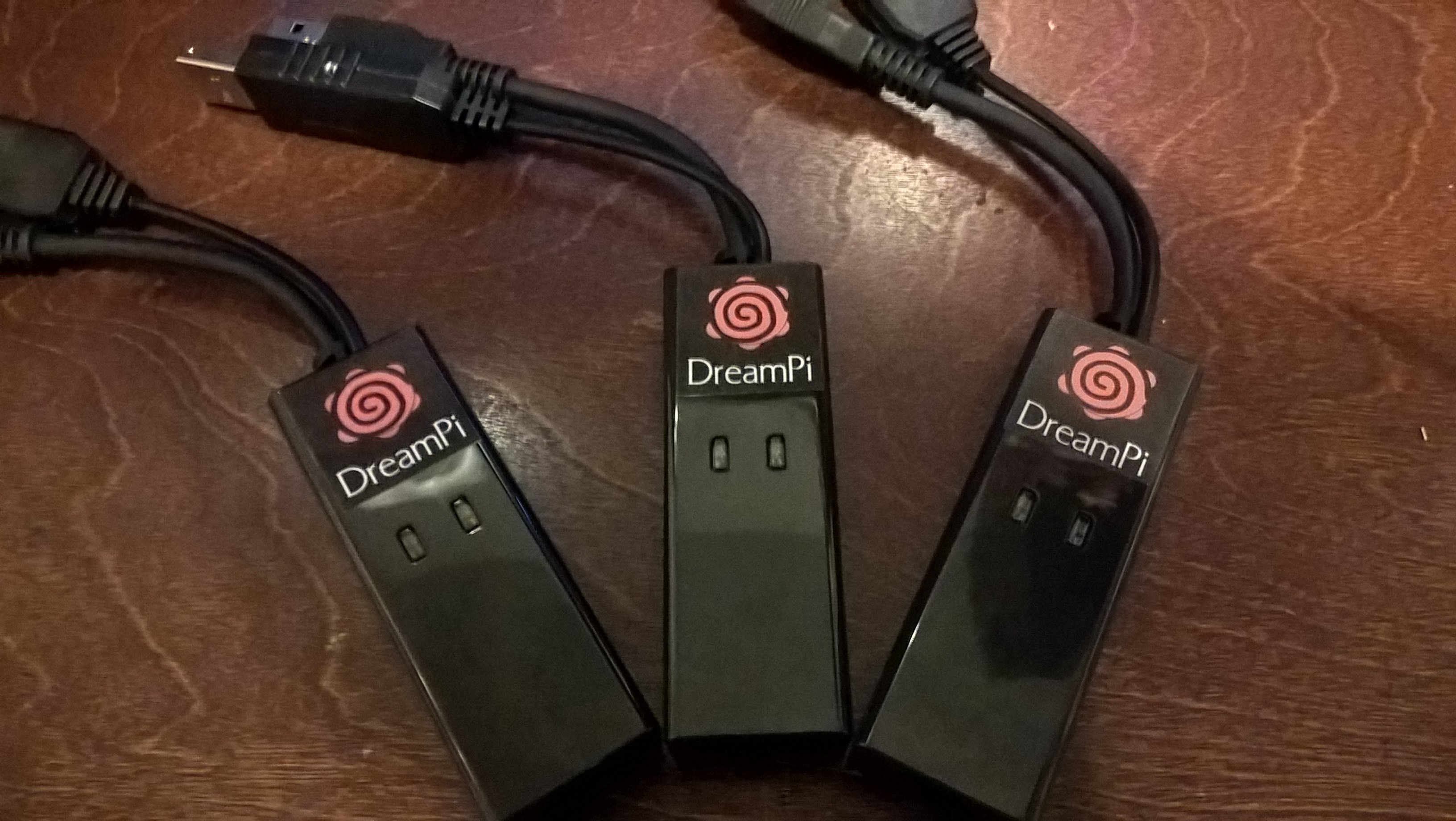

    Thought I'd point out now there are some slightly more elegant solutions for dreampi's Line Voltage Inducer now :)
    I think these are some really neat solutions to the Line Voltage inducers
    LVI built into Modem - Created by Tact on dreamcast-talk
    And PCWzrd13 made this one on dreamcast-talk
