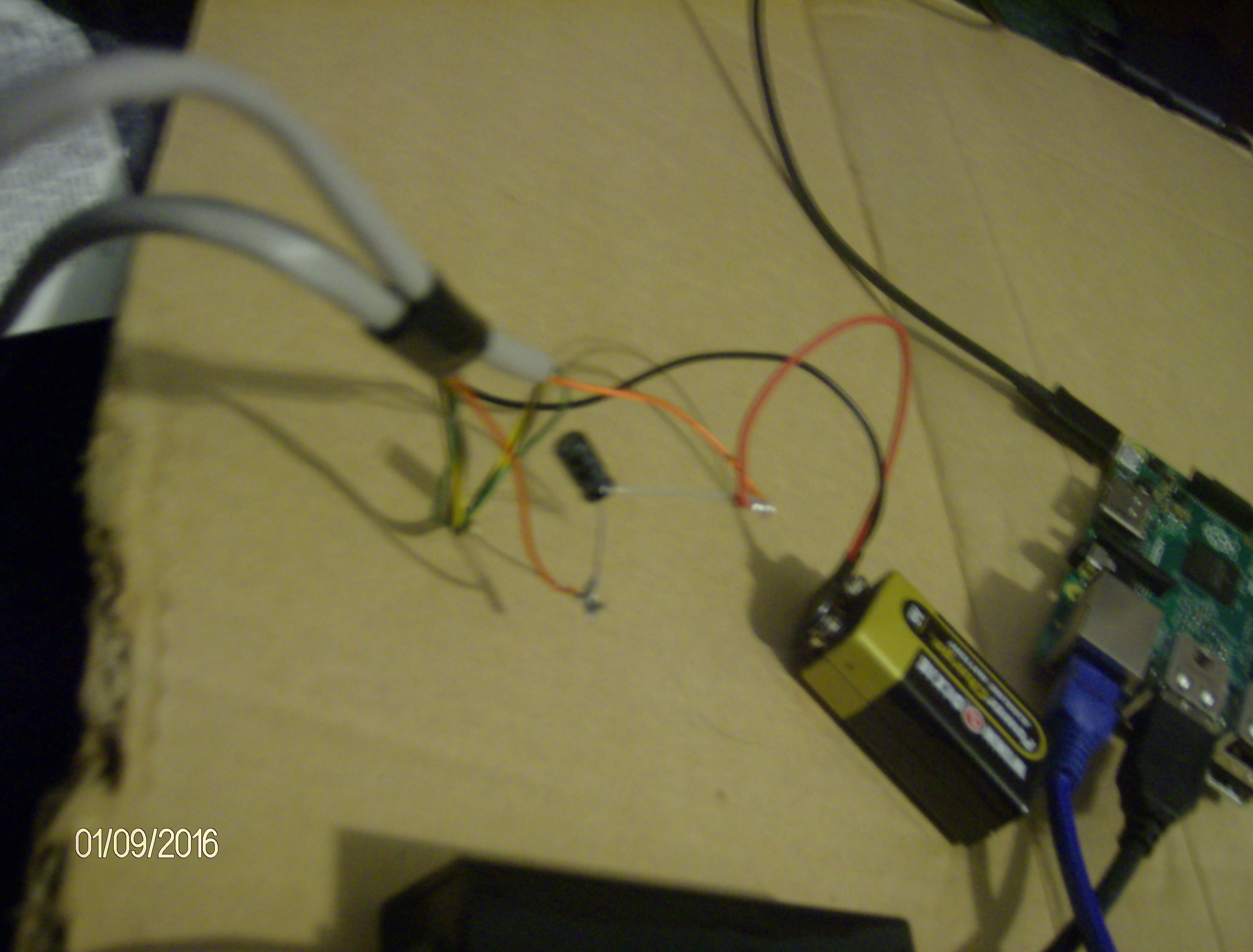

    And even after getting the expropriate parts, it STILL gets stuck on the dial tone, 330 resistors .47 uf capacitor, tried with 2 different batteries after resetting numerous times, every single time it failed on dial tone generation, (@Jon, if you ever start making line voltage inducers rather than selling the whole kit, you have at least one probable buyer), here is a blurry picture of my dreampi and line voltage inducer just in case i did something obviously wrong, though i followed the instructions to the best of my understanding

    Hmm, I can't quite see where the negative wire is going to, but I guess it just goes to the resistor and then to the other leg of the capacitor? I can't see where the resistor is though...
    These are my suggestions:
    1. If you have a landline telephone, connect it in place of the dreamcast and then turn on the DreamPi. When both lights come on you should be able to hear the dial tone down the phone.
    2. I don't think that it matters, but maybe try reversing the polarity of the battery (e.g. swap positive and negative)
    3. Potentially try wiring 2 batteries to form 18v input. This is necessary for PAL, but it might actually just be necessary for some USB modems. Test this with a cheap landline phone before your DC, I don't want you blowing your modem, especially as you have a 330 Ohm resistor and I've only tested 18v at 380 Ohm.
    As for manufacturing line voltage cables, I'll have an announcement on this over the next few weeks ;)

    ok, the problem im guessing is just the phone line cable itself, its well over a decade old, and when i went to 18V because we don't have a landline, nothing changed, ill build another line voltage inducer soon, as for polarity, i rearranged the parts to look exactly like the example photos, and as stated, nothing happened differently

    It's also possible you have cold solder joints somewhere in the inducer. Since your wire you're soldering to is orange, maybe that isn't the wire that handles the electricity. I think they're supposed to be red. Try another newer phone line

    thats the camera being stupid, its actually a red wire
