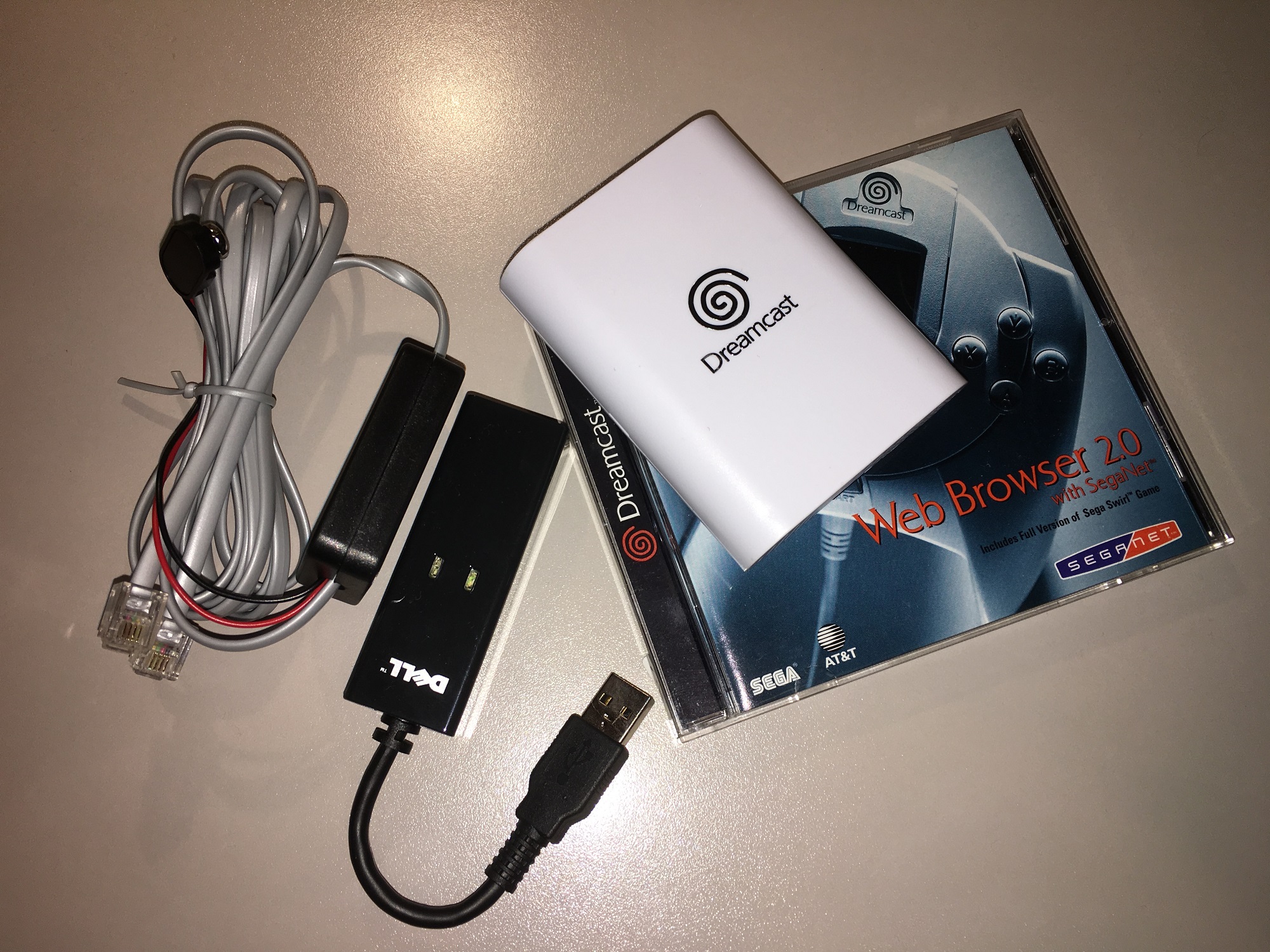

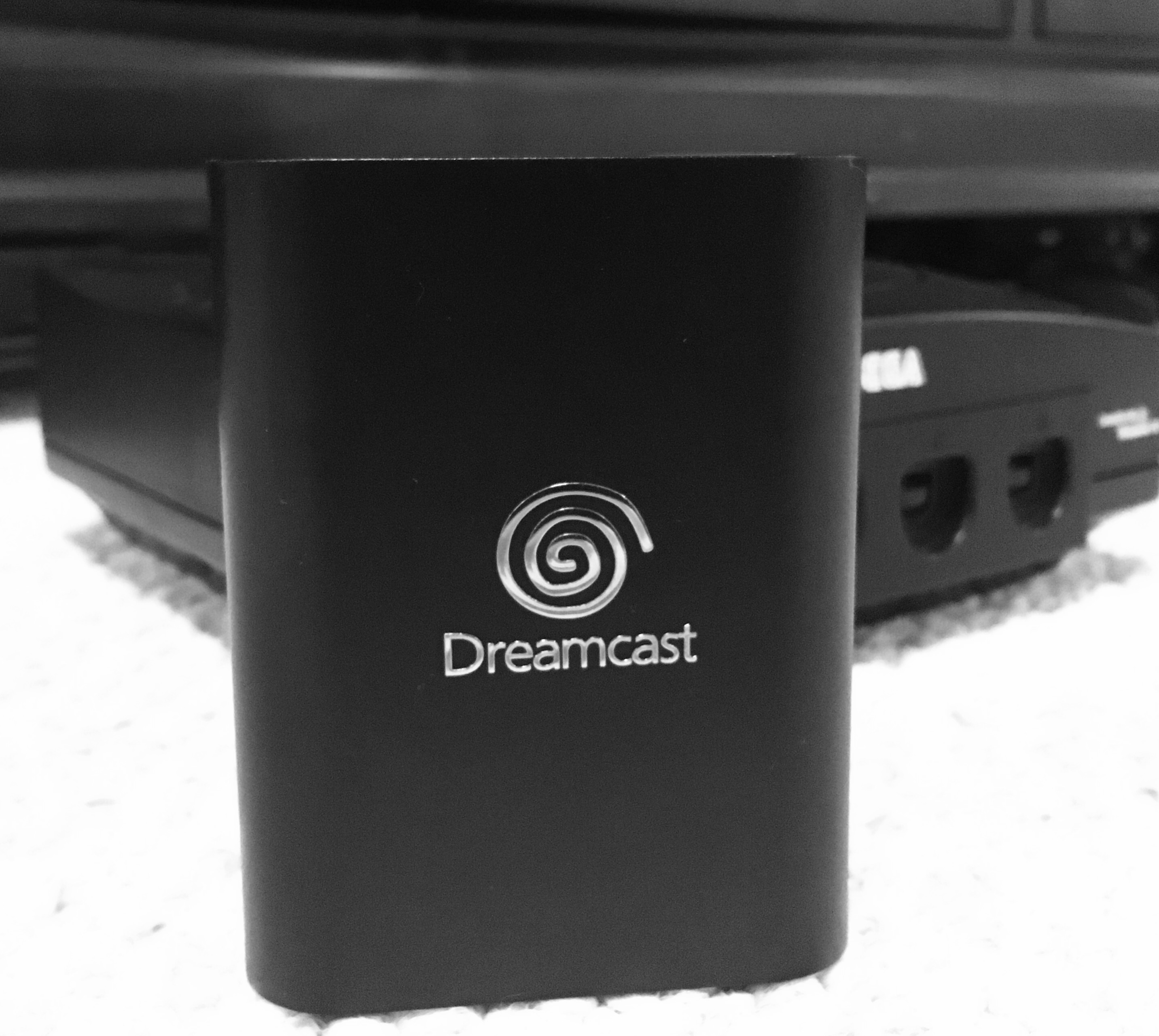

    Building a Nice Looking DreamPi
    Here's what my final product looked like. I made them in white and black, and I think both looked pretty awesome. The voltage inducer is decidedly un-awesome, but the end resulted didn't look horrible. The best modem to use is a Dell RD02 modem. My full shopping list is below. I also shipped a Browser Disc (PlanetWeb 2.0) and the attached Quick Start guide with every kit I sold.
    Building the Voltage Inducer
    This is a pain in the butt. I made a walk-through video here, that should hopefully augment the instructions found here.
    You can build a version of this same inducer that does not need a battery, with the same instructions, but using a 9v "wall wart" power adapter instead of the battery clip. It works perfectly, although it does introduce another power supply!

    Parts List
    Good quality parts make a difference. So does construction. See my video link above on how to assemble a solid voltage inducer...
    I included a battery, browser and USB cord, but not the required 2.1 amp USB power adapter, and was able to consistently build these for just under $90 in about 25 minutes. Shipping in the US fits perfectly inside a $6.50 Priority Mail small box. Sold for $110 shipped after eBay takes $10.4 in fees, and you'll do just a little bit better than break-even.
    Troubleshooting the Build
    The two most common problem symptoms are easy to troubleshoot:
    - Do both modem lights come on after the Pi boots? If not, run the script in --no-daemon mode and look for errors. The most likely (non-obvious) cause is an incompatible modem.
    - If both modem lights come on and there are no errors, but the Dreamcast still complains/won't connect, do yourself a favor and find an old corded phone that you can plug into the voltage inducer to listen for a dial tone. If you can't hear an audible dial tone, your voltage inducer is borked.
