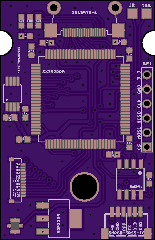

    I worked on my shuriken mod for the wii over the weekend. It works but I'm getting a little bit of interference/noise. I'm guessing its a my wire length. These wires are a little big longer than my pluto setup. I'm going to go ahead and try to make a custom flex cable.
    Had to notch the part of the ground plane on the AV connector for the HDMI board to fit. I had to de-solder the AV connector to be able to get a good looking cut.
    All wired in ready for testing :)

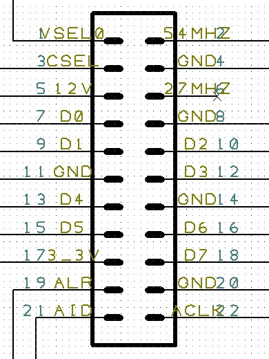

    You could try adding a few additional ground lines between the signals to reduce crosstalk.

    I've got the board redesigned with a different connector. I'm also going to route the 54Mhz clock on a separate shielded IPEX cable.
    Now I just need to hunt down a solid ink printer to be able to make some good flexible pcbs.
    This design uses a different pinout than the shuriken v3 for the data points. Just to make it easier to route to the flexible cable connector.

    Yer i think unseens right if you look at the orginal connector
    there are no more then two digital lines before a ground signal D0/D1 then ground, D2/D3 then ground etc etc. I would suggest doing pairs of two digital lines between gnd signals so if that helps.

    You are unseen are both right. I've already sent my board out to oshpark yesterday but since I'm going to build a flat flex cable, I can add a ground planes onto that :cool:

    You may still want to add ground traces between every few signals. UltraHDMI does the same thing. Also, UltraHDMI does not have a full ground plane on the bottom of the flex, but rather a few traces. I think Marshallh did this, because if the ground plane becomes big, it becomes difficult more difficult to solder the pads(?).

    @Helder
    This is what the flex cable/pcb will look like. Not final design but very close to this.
    Yes you are exactly correct.
