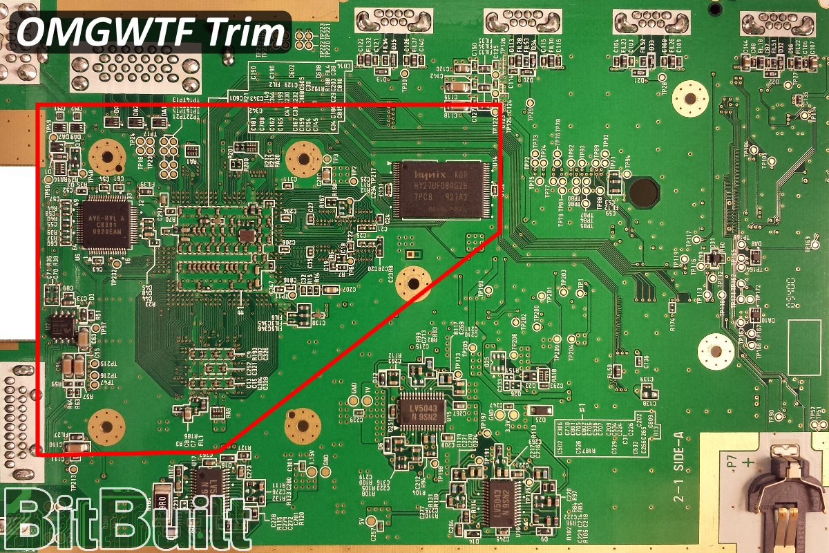

    Also another semi serious issue, is the wii revisions. I know of at least two different main board layouts:
    My motherboard looks like this:
    Then there is this one:
    Might be possible to make the flex cable work for both revisions if I make it long enough and be able to be bent.
    Does anybody have any pictures of wii mainboards that aren't these. Specifically the non gamecube port ones.

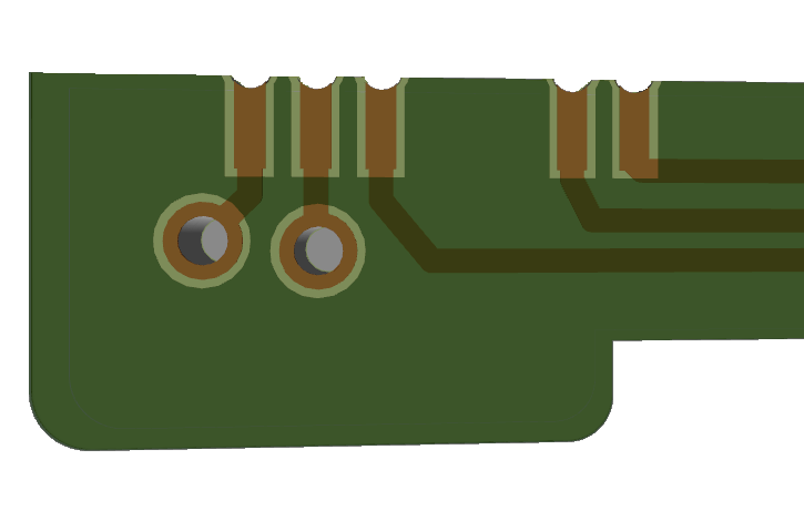

    Well it seems my notches were not deep enough to be practical in real life:
    But with a small file I can notch it better like I intended, now I will need to edit the board to have deeper notches so it comes out as intended.
    citrus3000psi likes this.
