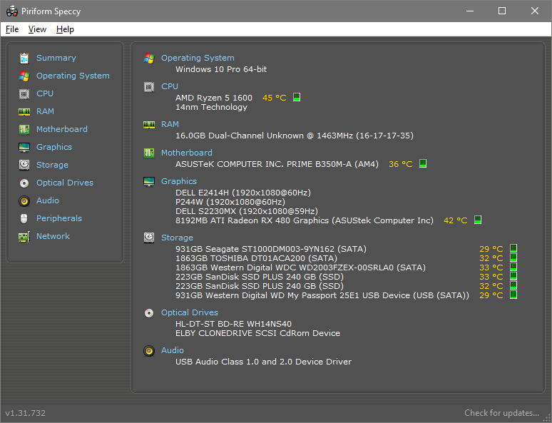

    Specs if interested
    Zant likes this.

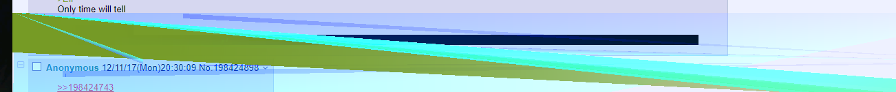

    Small discovery, not sure how impactful it is but I'll mention it
    Decided to kill Windows Shell Experience from my processes (which restarted on its own as I later saw), and the moment my GPU started doing it's GPU stuff on all 3 displays some form of corruption happened.
    Once loading into my game it did it's usual freezing/screen resetting. I want to stress that this is the second time I've ever experienced this corruption, the last time being about 5 months ago (which i incidentally had recording at the time it happened, I can link that footage if anyone wants to see it).
    So I guess give it to me bluntly. Card dying or not.
    Secondly, should I yell at Asus once more since the first RMA, the one they told me "everything is fine".

    Then I guess I'll do that over the next few days.
    Here's that video while I have the moment
