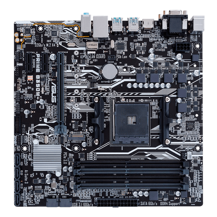

    Prime B350m-a

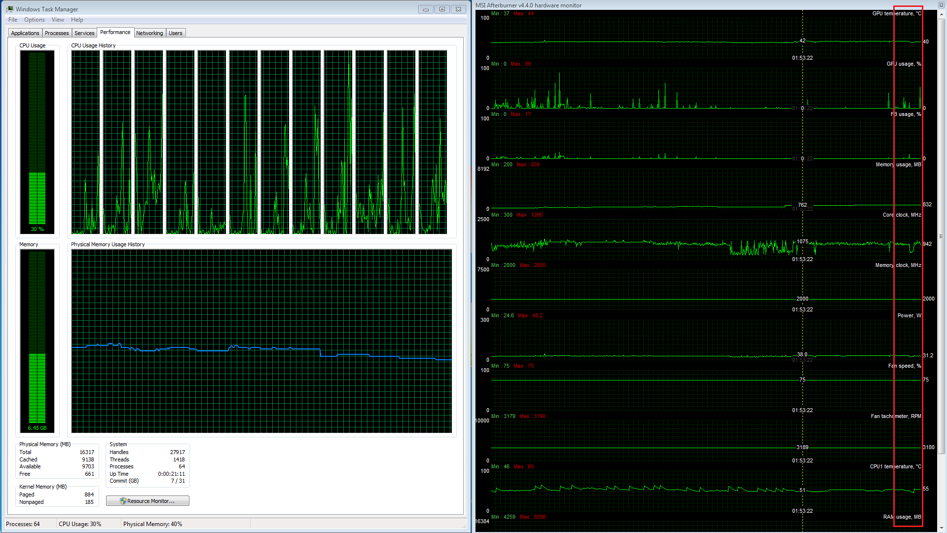

    Got win7 installed (god bless disc drive). Installed chipset, installed, whatever else I needed to get things running. Played a match of league to see if it would happen and it did but was resolved far faster than win10, affecting it maybe for 2 seconds instead of 10, only affected the game's monitor (middle of 3) as opposed to all of them as well. No full reset for the display either.
    I didn't setup logging but I did keep some monitors open in case it happens. In the red area is when it happened. Im mainly looking at the GPU usage spike and the core clock dip.

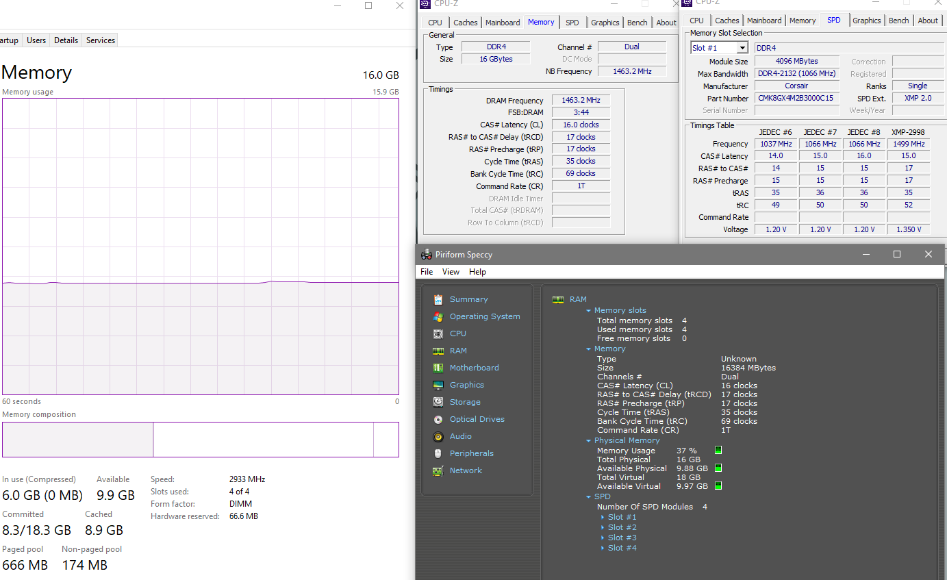

    This might be due to the debloat stuff you mentioned. It says on their page that it hasn't been tested with the Creators Update, and that future updates might cause issues. Is running that really necessary? Your computer is newer than mine, and my PC runs Windows 10 plenty fast without any of that. If you absolutely have to have that, then you may have to just deal with the OS being a glitchy, unusable mess. Is it really that surprising that modifying the OS in a non-standard way might cause problems?
    Unrelated to that, what speed is your memory? That screenshot on the first page says 1463MHz, but that isn't a normal speed, and it seems like it should be higher than that.

    Not sure what the issue is with those readings honestly. It's 2 sets of dual channel DDR4 3000Mhz ram. It's clocked to 2933 right now (I have not tried going to 3000 but might sometime). Bios says 2933, Windows says 2933, Speccy doesnt, CPUZ doesnt

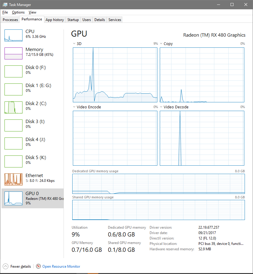

    At long last, it finally happened once more. This time I remembered task manager has a GPU section with the latest updates on win10 and saw this
    While playing I do have videos playing in the background as noise, which could explain the spike on decode when displays returned
    Anyone have input as to what might be going on here (also that disk usage, possibly part of the issue?)

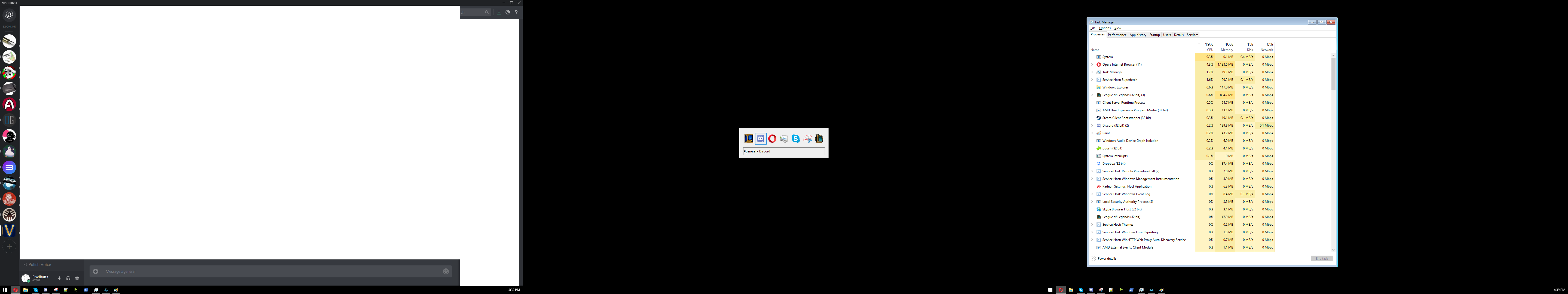

    Another update, been a while and just mere moments ago it acted up again, but instead didn't recover as expected.
    This time, I was left with the middle monitor totally stuck on black (with the task selection being the last thing it got), the win10 theme turned full black and aero disabled (broke), something was trying to restart, but I'm not overly sure what it was.
    Had to do a full reboot to fix this. Pic below is the screenshot I got as it happened (edited out discord because I wanted to).
    I'll be trying out a new motherboard, and be seeing if this issue still persists.

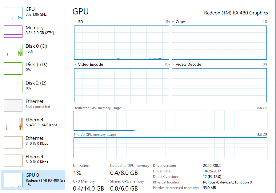

    Noticed your AMD driver was a month behind, probably not the problem but still.

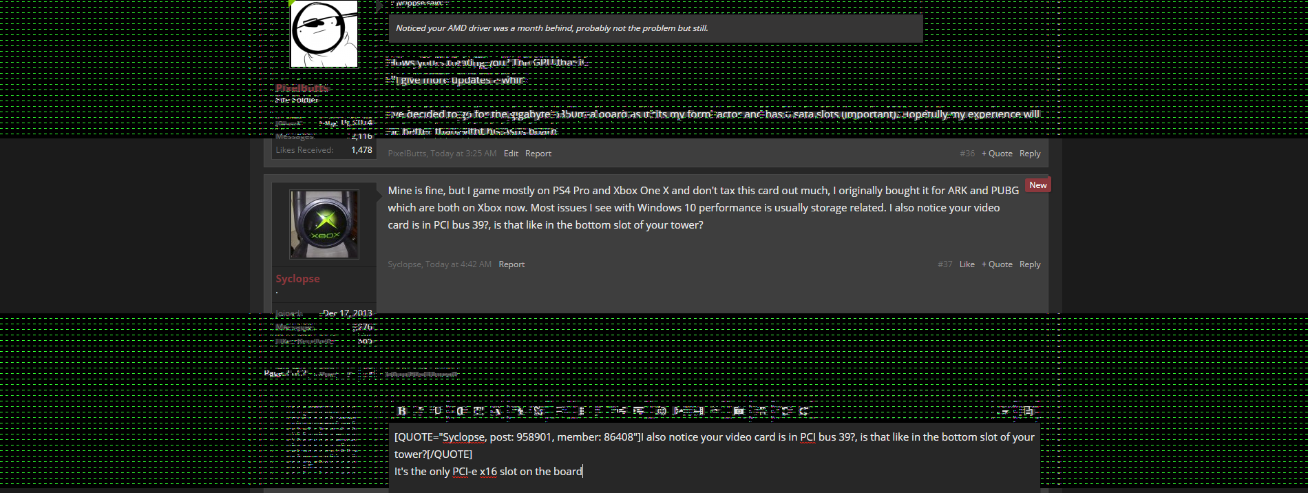

    Mine is fine, but I game mostly on PS4 Pro and Xbox One X and don't tax this card out much, I originally bought it for ARK and PUBG which are both on Xbox now. Most issues I see with Windows 10 performance is usually storage related. I also notice your video card is in PCI bus 39?, is that like in the bottom slot of your tower?
  18. PixelButts
    PixelButts Site Soldier
    Aug 19, 2014
    2,665
    1,808
    It's the only PCI-e x16 slot on the board
