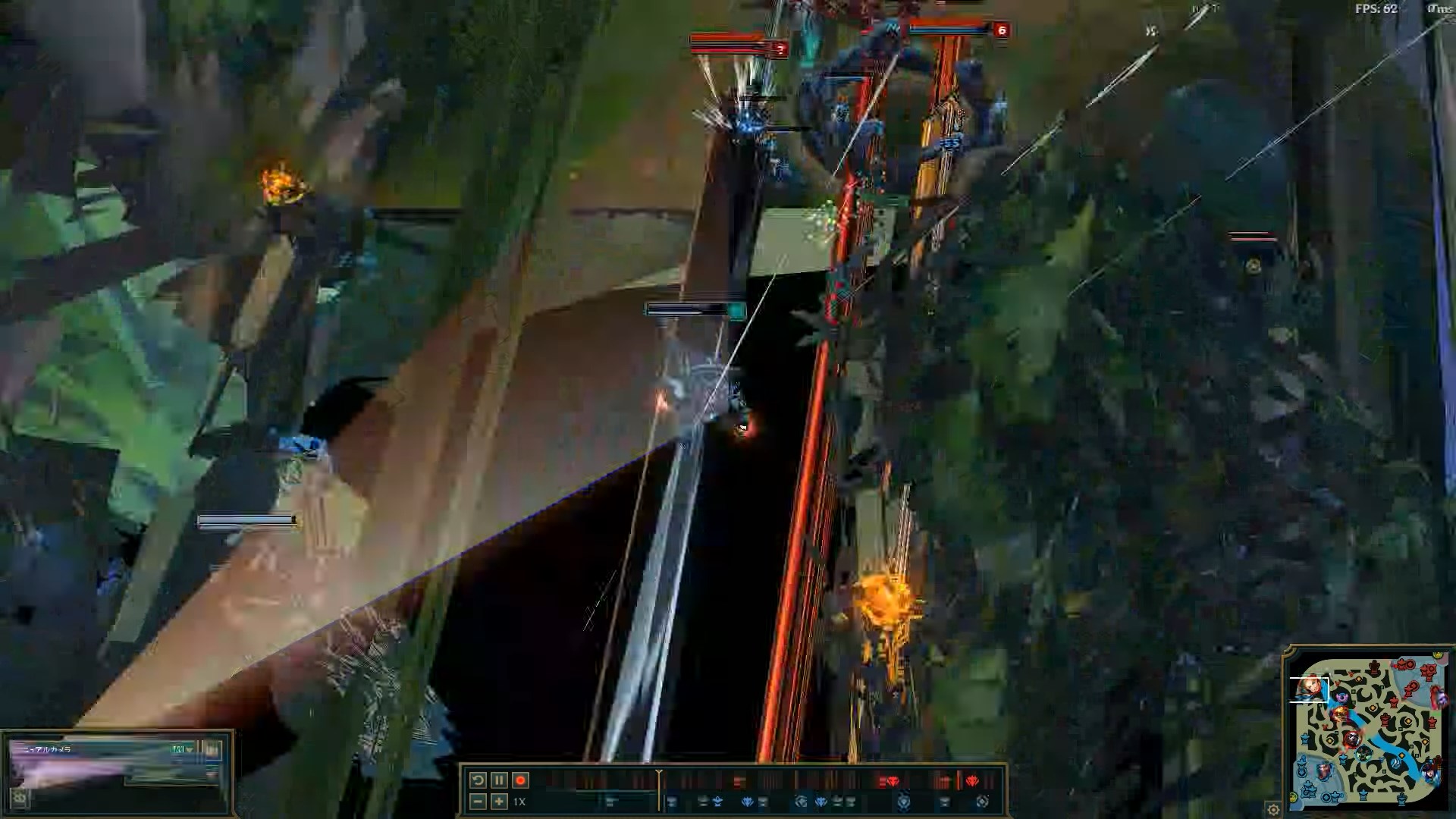

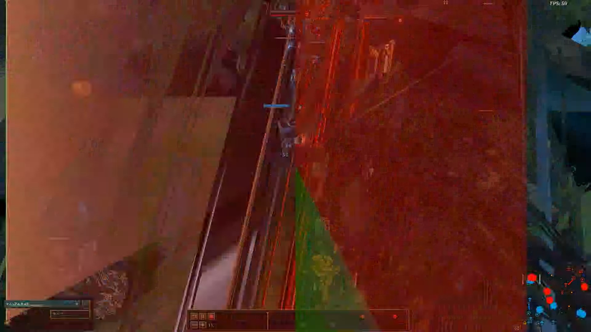

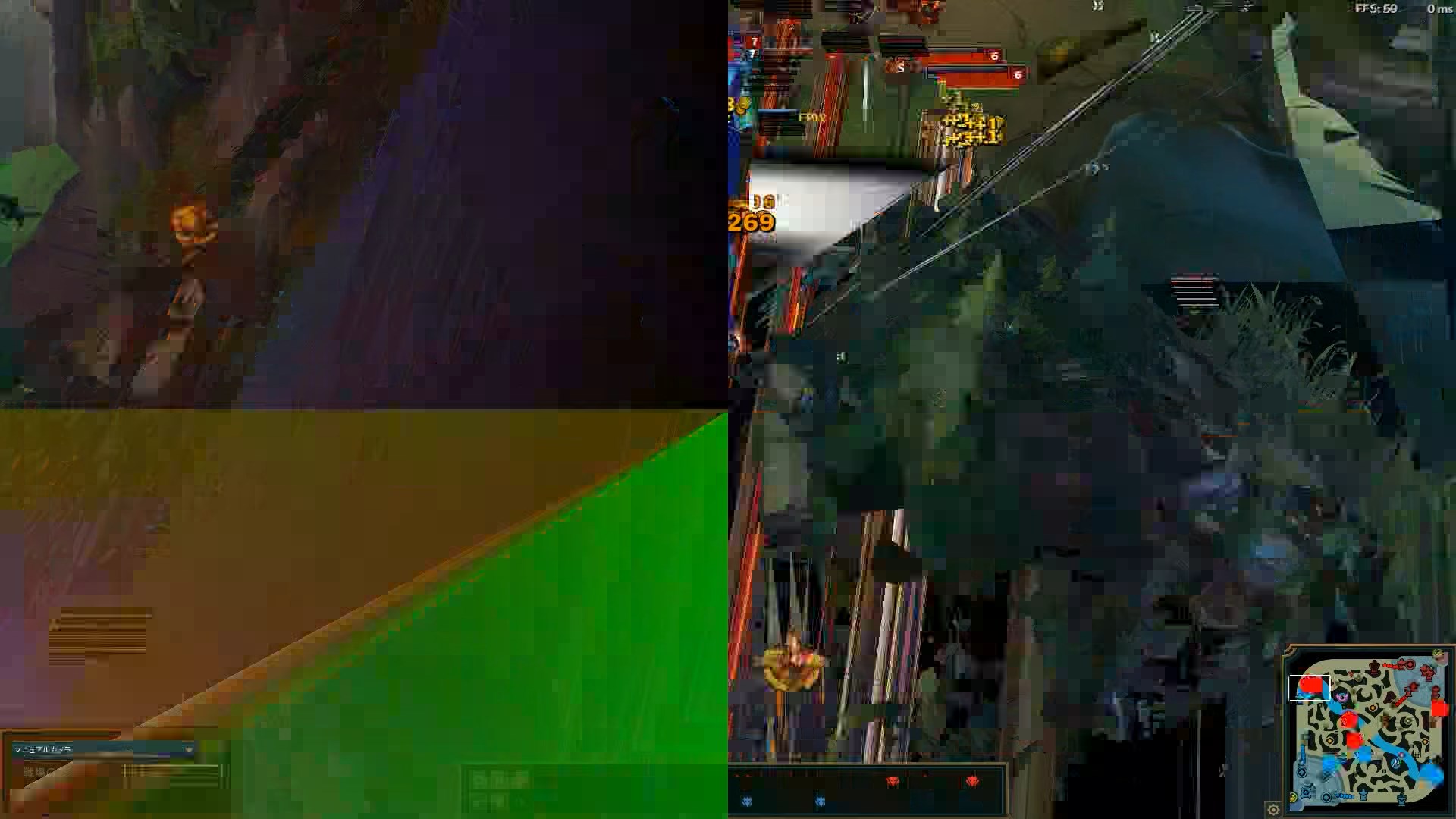

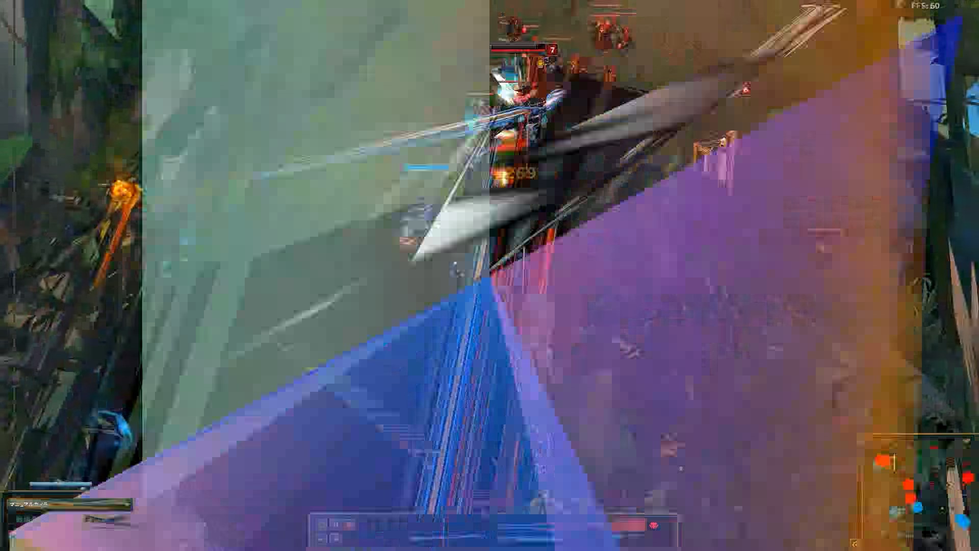

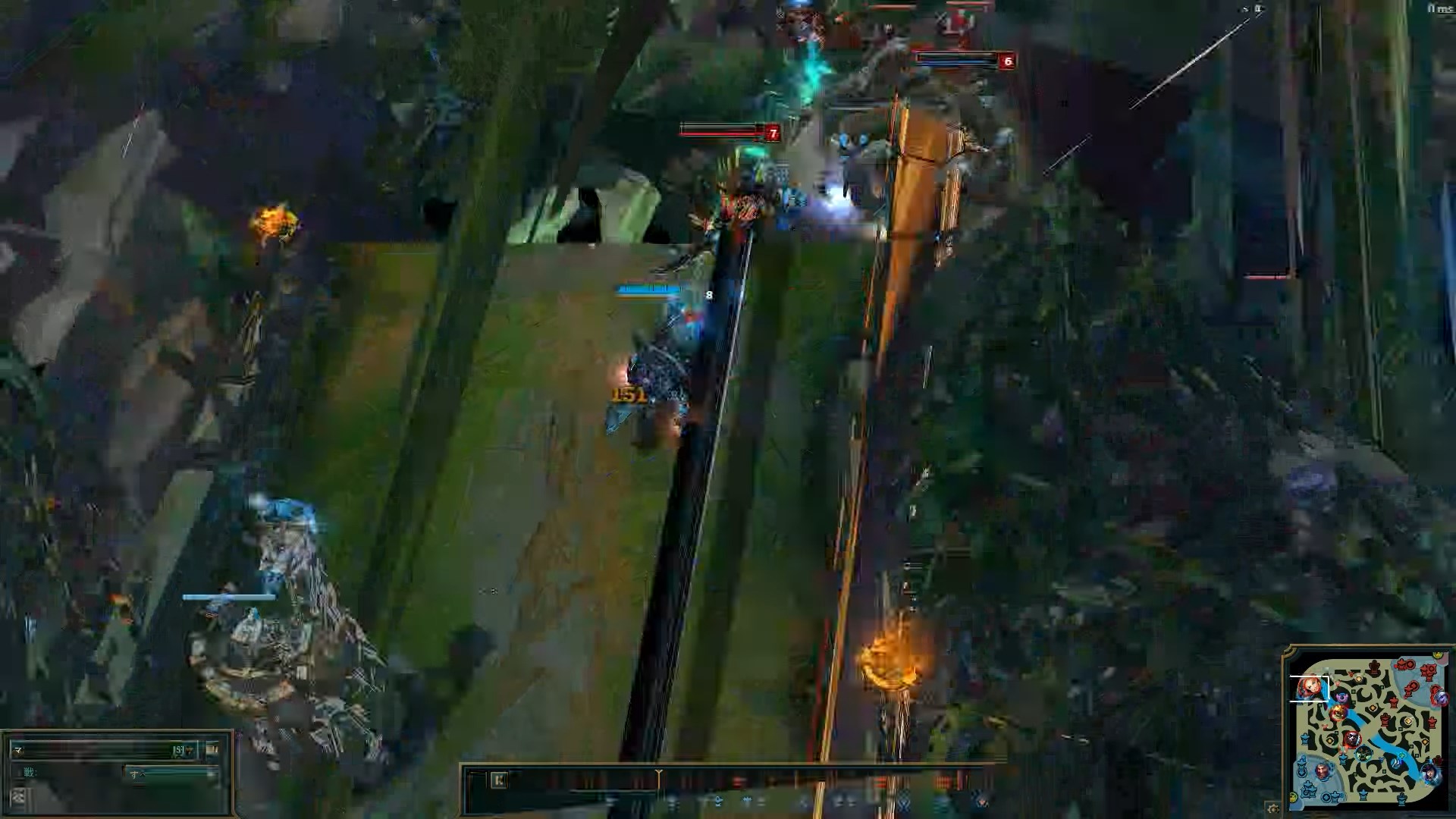

    Some good images (from a video) of one time in the first month of issues which I feel justifies something being wrong GPU wise
    When your GPU just stops.webm_snapshot_00.10_[2017.12.27_17.52.25].jpg When your GPU just stops.webm_snapshot_00.10_[2017.12.27_17.52.35].jpg When your GPU just stops.webm_snapshot_00.12_[2017.12.27_17.52.46].jpg When your GPU just stops.webm_snapshot_00.12_[2017.12.27_17.52.54].jpg When your GPU just stops.webm_snapshot_00.12_[2017.12.27_17.53.03].jpg

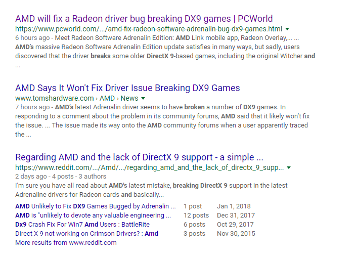

    Interesting news that showed up last night. Apparently there's some issue going around for AMD users where games using DX9 break, similar to the way I've been putting up with.
  20. la-li-lu-le-lo
    I thought you said your 750 Ti was doing the same thing.
