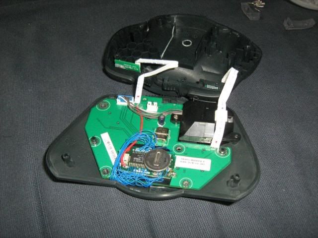

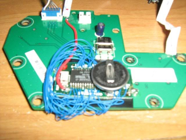

    I opened the controller yesterday and it turned out that ique controller are nothing more (or less) than n64 controller :D
    So decided to integrate an controller pak to it since it will be usefull when playing third party games. Can't swap between many memory pak but since I alway get my memory pak corrupted for some reason now when I unconnect them (don't know if it's the memory paks pin that are too used or if my controllers connectors are too used...) I try to avoid swapping anyway with regular controller..
    Sorry the pic are not very nice :/
