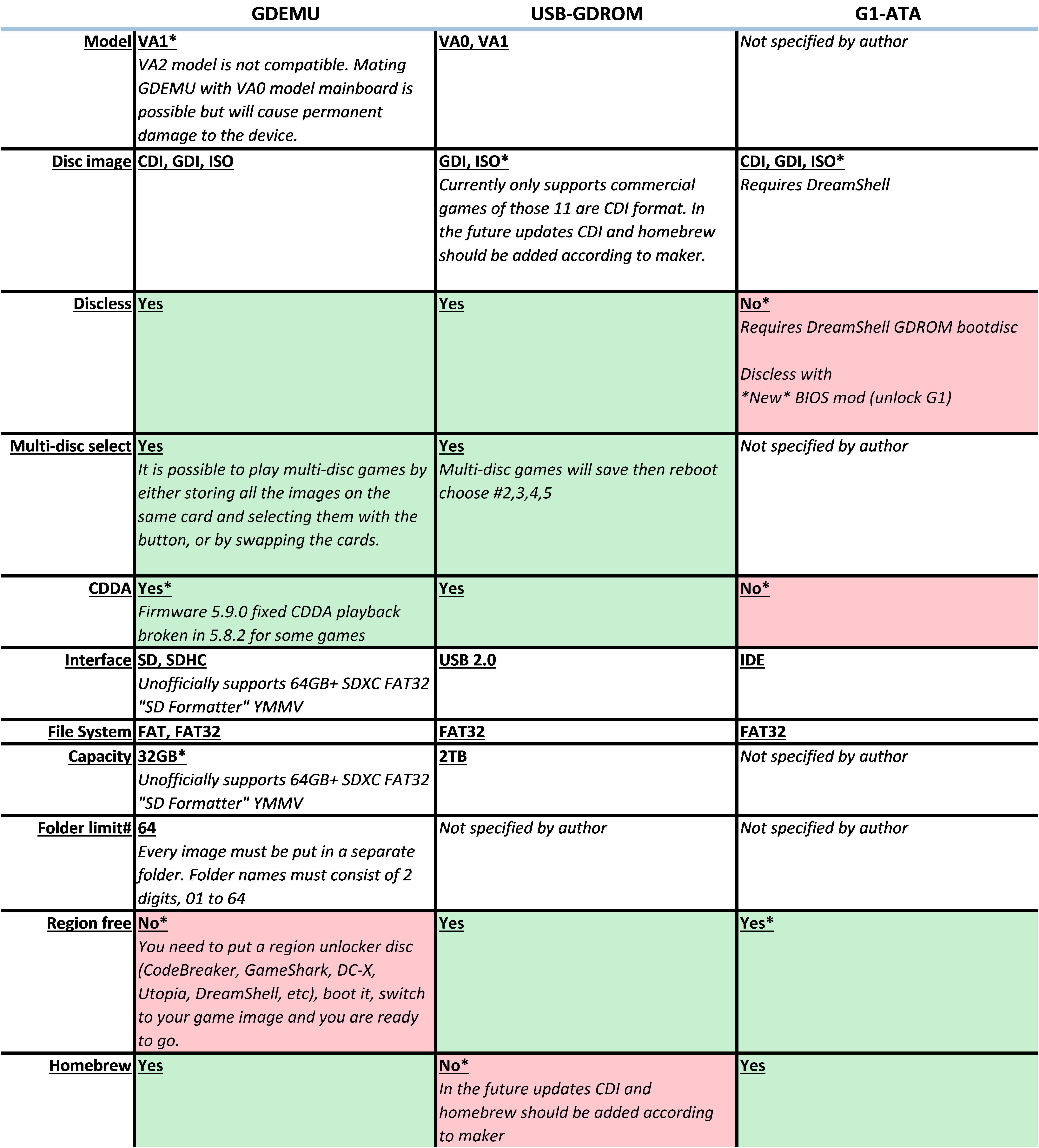

    Great comparison chart, very helpful! Lack of CDI support on USB-GDROM stinks because most of the ISO's easily obtainable are CDI not GDI!

    CDI is coming to USB-GDROM. I don't know the ETA.
    There was some guy working on a complete GDI set with Mega links but I can't find it now.

    Interesting to see it all laid out, but I had to go to Facebook to get the link.
    And it was a Google Doc.
    With embedded comments within the spreadsheet that I had to hover over to see.
    Thought I might do the folks who didn't want to go to Facebook a favor, downloaded the .xlsx file, moved the comments into the body of the cells, reformatted it, and captured it as a picture.
    Here ya' go, don't shoot the messenger, I just copied the fellow's spreadsheet verbatim...
    (Original source: https://docs.google.com/spreadsheet...4nSqRoRfm6fvQflxjv1tCGpVEU/edit#gid=420741251 - - link may be dead if you are visiting this forum from your time machine in 2060 or whatever...)

  8. kai
    kai Member
    Oct 7, 2012
    Dreamshell does have experimental CDDA support that has worked on the couple of games I have tried.

    Disc image: CDI/GDI/ISO/CSO
    Discless: with ANY BIOS mod
    Multi-disc select: not supported yet
    CDDA: partially supported (works in not all games yet)
    Interface: IDE or SATA with adapter
    Filesystem: Up to 4 partitions on disc, FAT 12/16/32 (+LFN, +can use spaces), Ext2 (can't run games from it, but DS can use it in core)
    Capacity: Just limits for filesystem - 4 partitions up to 2TB each. In sum 8 TB.
    Folder limit: Just filesystem limit
