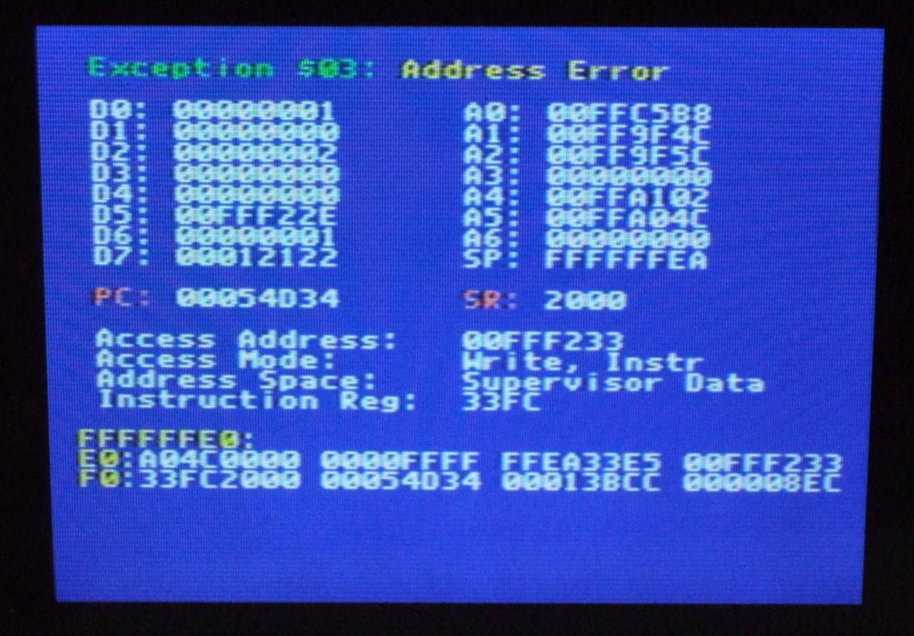

    Hi KRIKzz.
    MEGA-EVERDRIVE It arrived.
    Although the blue screen came out, is this a thing of MEGA-EVERDRIVE?
    PLAYGAME > ULTIMATE MORTAL KOMBAT TRILOGY((2710-2783) UMK 3 (HACK 13) PATCH 1)
    MEGA-EVERDRIVE > OSV2 Firm3
    and
    SWORD of SODAN >not work.
    UMK3 >not 6Button mode.
  8. KRIKzz
    KRIKzz Well Known Member
    Apr 5, 2010
    1,672
    not all versions of UMK3 supported with real hardware. version 4411 should work, 4978 probably also
    don't know about SWORD of SODAN. probably bad rom or something like that
  9. 8413
    8413 Active Member
    Jun 22, 2010
    25
    Thank you reply. I play NOMAD(NTSC-U) & Multu-MEGA(NTSC-J) SYSTEM.
    Sword of Sodan Work. >In-game Menu OFF
    UMK3 6Button mode Work. >In-game Menu OFF
  10. StoneAgeGamer
    StoneAgeGamer Intrepid Member
    Jul 8, 2010
    651
    Glad to see you get it working.
    The manual for the Mega EverDrive thats on KRIKzz's site actually does state that turning off in-game menu is suggested for some games because they are not compatible when its on.
