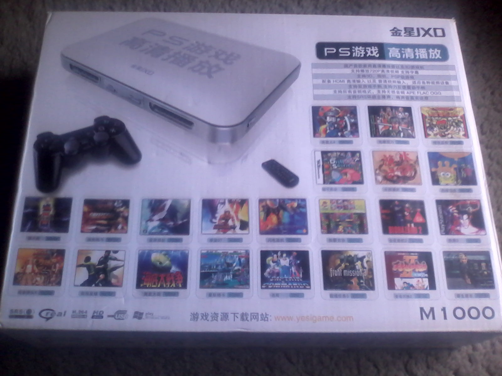

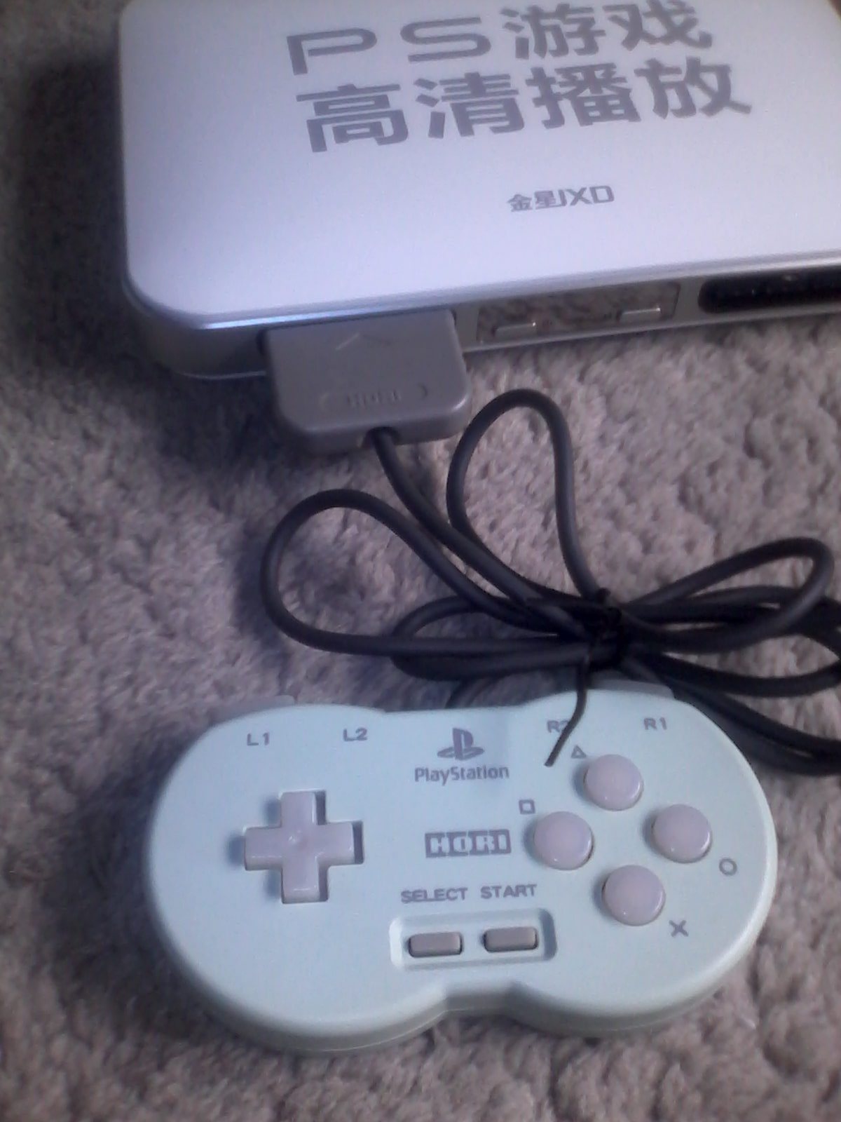

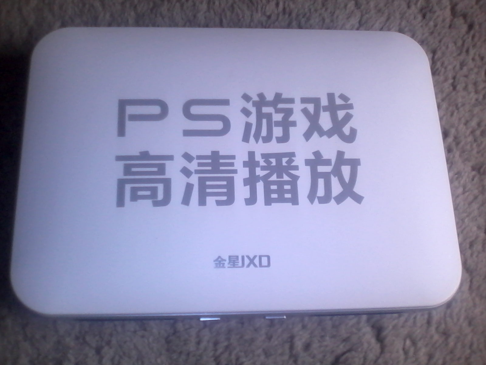

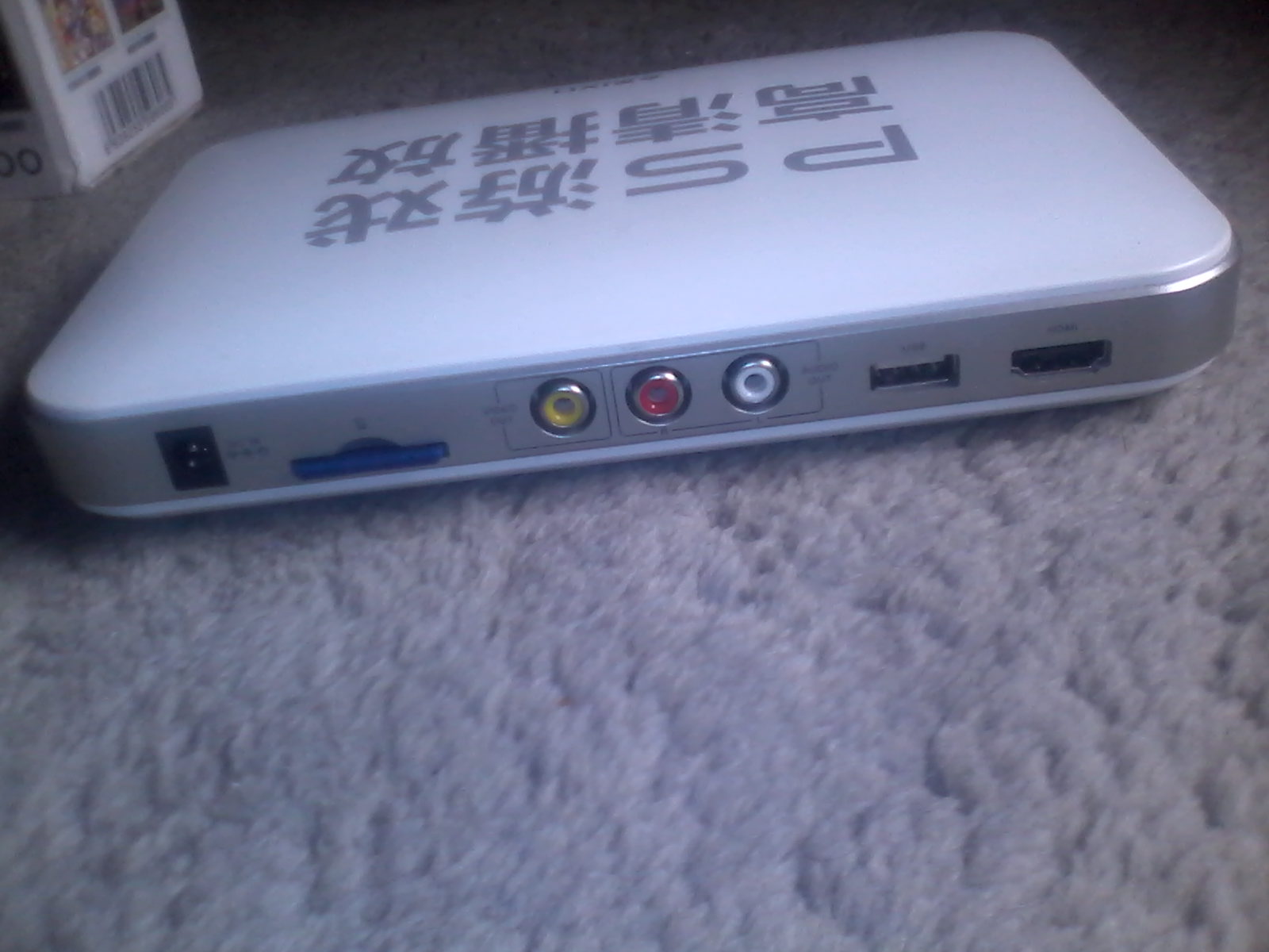

    JXD M1000 BEST CONSOLE I have one that I bought on dealextreme, there is also the JXD 3000 handheld ps1, it's been that was released this console!

    Why buy a system like this when there's, for example, the psp with CFW that doing the job way better?

    So how are the games running on it, and is it in fact emulation based?
    ps. love that controller!! <3
