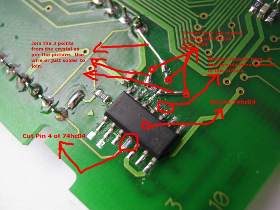

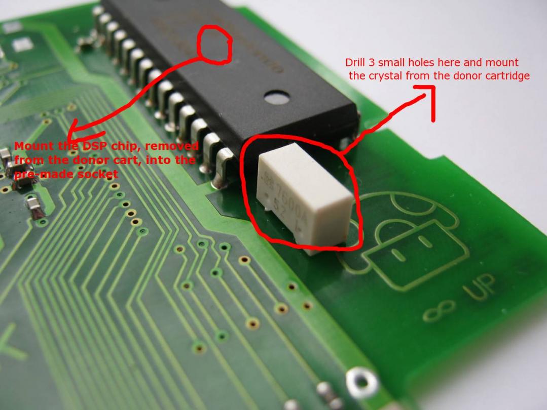

  4. Mamejay
    Mamejay Robust Member
    Sep 19, 2010
    258
    OK,
    For all of those people that want to add the DSP chip to there cart have a look at the attached pictures. It was juts a very quick job and I used the original pictures that Krikzz has posted. Just added some comments of what to do.
    Please ask any question if you have any. I am more than happy to help get this working for you.
  5. KRIKzz
    KRIKzz Well Known Member
    Apr 5, 2010
    1,672
    by the way, boards v1.4 use modified design where dsp instalation is much more easy. just need unsolder quartz crystal (white thing with 3 legs), dsp1 and dip 74hcu04, and solder them in everdrive

  7. KRIKzz
    Apr 5, 2010
    1,672
  8. seganerd
    seganerd Member
    May 2, 2011
    I see...
    Haven't got my cart yet since they're sold out but wanted to see how it was done to know if I should order an everdrive with pre-installed dsp or if I could do it myself :)
    So it's only those 3 components from a used game with dsp chip, no other resistors or something?
    Also does it matter if everything comes from a PAL or NTSC cartridge? I'm gonne use the everdrive on a PAL snes.
    If it's not to much to ask could anyone link me a picture of 1.4 board? Tried to google but couldn't find any, I guess that's the one that'll be sent to me when I order :)
    Thanks a lot for all your answers, made everything much clearer!

  9. Mamejay
    Sep 19, 2010
    258
    PAL parts will work just fine. I am in PAL land and got it working fine. I had to buy the 74HC04 from the internet but from what Krikzz was saying you can use the one from the donor cart on the new 1.4 board revision.

  11. seganerd
    seganerd Member
    May 2, 2011
    Hi!
    I have finally gotten my SNES Everdrive (rev. 1.5) and it's pretty straight forward how to implement the DSP-1 chip with the two extra components... my only question is: does it matter how i solder the quartz crystal since it doesn't tell exactly how to solder it onto the board (upside down)?
    Thx in advance!
    Apr 5, 2010
    1,672
    you can solder crystal at any side

  15. ssj4jaxmazon
    ssj4jaxmazon Rising Member
    Nov 29, 2010
    70
    Hi krizz soz to be a pain but I have a bit of an issue, I have recently got my super everdrive and I have installed the dsp1 chip however no dsp1 game works and reading this thread I have noticed that other stuff can be installed. Do I have to install the white block on my everdrive for the dsp1 chip to work and is there anything else that needs installing? if so can I get these parts from my super mario kart game which I got my dsp1 chip from?
    btw I think I have the latest board V1.5
    thanks
  16. KRIKzz
    Apr 5, 2010
    1,672
    need to install white thing and 74hcu04 IC
