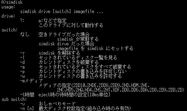

  5. GaijinPunch

  6. GaijinPunch
    10,999
    75
    drive:
    ?: Assign "a:" etc. Run on this drive.
    switch:
    Nothing on an empty drive, simdisk will be stationed there.
    on a simdisk drive, imagefile will be set on the simdisk
    -r release simdisk
    -l list disks which are set
    -d delete current disk
    -a delete all set disks
    -p disallow writing to current disk
    -w allow writing to current disk
    -m media assign media
    -t time wait time for eject
    sub switch:
    -v verbose mode
    -n maximum number of disks
  7. caius
    caius Rising Member
    Jul 17, 2007
    66
    Many thanks for this perfect translation! どうもありがとう.

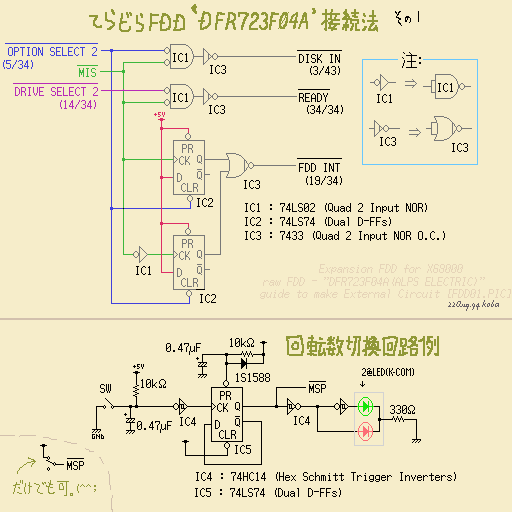

  14. caius
    caius Rising Member
    Jul 17, 2007
    66
    I know , I'm asking often for small translations here but how can do otherwise?
    This one, please:
    ただし、この回路はテラドラFDD用のものですので、他のFDDで使用すると
    きは、「DRIVE SELECT と MIS の論理積を READY に返す」部分の回路は必要あり
    ません。それ以外は同じ回路で動くとおもいます。
  15. cypherpunk
    cypherpunk Active Member
    Jan 2, 2012
    43
    This is going to be very rough, since it is using electronics jargon that one is not taught in school, so if this is very important to get right, please get a second opinion. :)
    Direct Engrish translation:
    "However, even though this circuit(?) uses Teradora FDD, while using other FDDs, "Drive Select and MIS logic gate(?) returns READY" section of the circuit(?) is not necessary. With exception of that it is the operation (use) of the same circuit(?), I think."
    Engrish to English translation (might lose nuances, since I am not an electronics guy):
    "This circuit uses Teradora FDD, but when using any other FDDs, the part of the circuit, where DRIVE SELECT and MIS logic returns READY is not needed. Otherwise it's (like using) the same circuit, I think"
    (Last sentence can be interpreted two different ways depending on missing context, which is why there are brackets there)

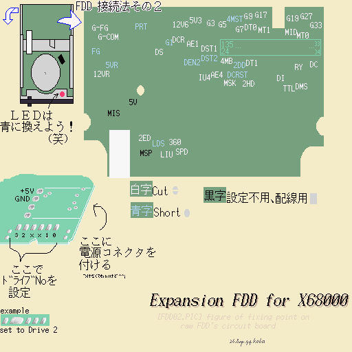

  16. caius
    caius Rising Member
    Jul 17, 2007
    66
    Yes, thanks!The second translation (engrish to english) makes sense to me.
    The last one, please, then I will disappear:)
    図中の MIS は、FDDの基板上から、「メディアが入っているときにL」にな
    る所をさがして接続してください。
     図では、ドライブ番号2に設定することを想定しています。それ以外のIDを割
    りふる時は、その番号の OPTION SELECT, DRIVE SELECT を使用してください。
     (5/34)のような表記は、テラドラFDDでない場合は(あまり)意味を持ちません。
     さて、この回路で何をしているかというと、
     「MIS の立ち上がり/下がりエッジを検出したら、FDD_INT をアクティブ(L)
    にする。また、OPTION SELECT が来たら MIS を DISK_IN に返し、同時に FDD_INT
    をHに戻す」
     ということをしています。
  17. cypherpunk
    Jan 2, 2012
    43
    Again, please get a second opinion from another translator, especially if you end up soldering or doing anything, that might destroy expensive hardware based on these directions. I tried to translate them into more natural English right away, so something that I thought was irrelevant might have been lost in translation. Italic in the brackets, are alternative translations for the preceding words or phrases, while in brackets are bits assumed from the context.
    With respect to MIS on the diagram, please look for connection from the upper substrate (layer) of the FDD's logic board when (there appears) a message "Insert media into L"
    Comment:
    Sounds rough, but I am not sure how relevant the bit about MIS is to the rest of the sentence (or what it stands for), so keeping it in event that it's important.
    On the diagram, it is assumed, that you connected (set up) drive #2. When assigning (calculating) drive's ID, please use that drive's OPTION SELECT (and) DRIVE SELECT.
    If (what you are using is) not Teradora FDD, writing that looks like (5/34), (often) have no meaning.
    Comments:
    Is 5/34 referring to a diagram or a photograph?
    (often) is not implied, and is in the text.
    Any way, I'm saying that what you're doing with this circuit, is this:
    When (the system) detects failing edge/rising edge from MIS, FDD_INT activates (triggers) (L). Then MIS returns from OPTION_SELECT to DISK_IN, and at the same time FDD_INT returns to H.
    Comments:
    上がり/下がりエッジ is literally lowering/rising edge, but I think that author is talking about a signal going low/high
    Same caveat about 回路 (I translate as "circuit", might be also "system") as in the previous post
    HTH, HAND.
  18. caius
    caius Rising Member
    Jul 17, 2007
    66
    Domo arigato again for this precious translation!
    Yes, 5/34 is referring to this diagram:
    And I can't understand what is this MIS signal in other FDDs than Teradrive.You can see the MIS signal on this scheme of Teradrive logic board:
    Yes, I understood this part, it explains how the INTERRUPT signal works on X68000 computes.
    The ideal would be a whole translation of the document but , I know, I'm asking too much:smile-new:
  19. cypherpunk
    Jan 2, 2012
    43
    Would the interpretation of
    "This circuit uses Teradora FDD, but when using any other FDDs, the part of the circuit, where DRIVE SELECT and MIS logic returns READY is not needed."
    as
    "If your FDD drive, is not TeraDrive FDD, it doesn't have MIS and DRIVE SELECT lines"
    make sense?
    The way I am thinking, ALPS TERADRIVE DFR723F04A floppy drive is a 3 mode drive (720K, 1.2MB, 1.44MB), and MIS most likely is some sort of media insertion notification, based on the diagram. Catch, of course, is, that 1.2MB mode is not a multiple of 720K, so the drive needs to be told (or needs to tell host PC), that it is reading 1.2MB floppy (since rotational speed of the drive will be different, and likely size of read blocks + blocks per sector allocation will be different too). Since majority of the PC floppy drives are 2 mode (720K, 1.44MB), is it possible, that a 2 mode floppy drive would just not have this circuitry?
    1.2MB support in 3 1/2 drive is a 5.25" drive legacy, I'd guess?
    Coincidentally, here is a fellow, that has ALPS TERADRIVE DFR723F04A floppy drive in a Sharp X68000ACE Xellent30s computer, which tells me that those drives were pretty generic things, albeit not working in PC compatible computers out of the box. This site seems to be saying, that if you solder on the 4 pin power connector at the indicated spot, you can use it with a PC (Just be careful not to short the +5V line).
  20. caius
    caius Rising Member
    Jul 17, 2007
    66
    I don't know.I think MIS signal is needed also in FDDs different than Teradrive.If you look at that scheme , MIS signal is involved also in generating the "DISK IN" signal so when the author says "when using any other FDDs, the part of the circuit, where DRIVE SELECT and MIS logic returns READY is not needed" he refers to the only part of the circuit where "MIS" and "DRIVE SELECT2" generate "READY" signal and not to that where "OPTION SELECT 2" and "MIS" signals produce "DISK IN" signal.Don't you think so?
    Yes, it's a 5.25" drive legacy
    They will also generic drives but, nowadays, they seems really impossible to find....Please, ask to your fellow what he thinks about and if he has other info, maybe he can help us to understood that circuit.
    Last thing: Are you interested (since you know very well japanese languages) in translations of some techinical documents for X68000?We could collaborate also with the help of the guys on NFG forums.
