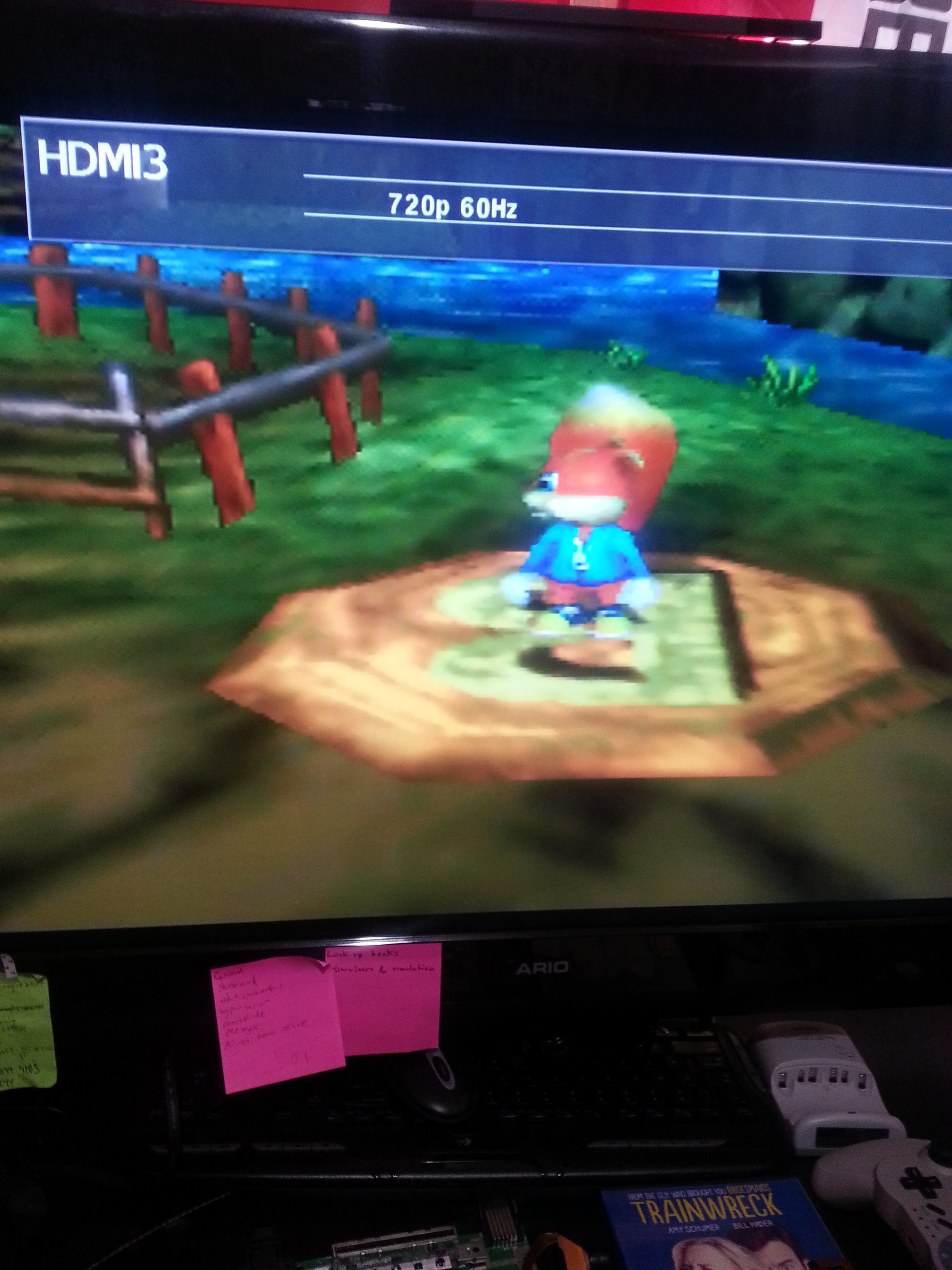

    I just instlled my second board and i get no errors. Im still messing with options but so far quality looks same if not worse could be my tv and settings. My first install had a short on pin 11 then on pin 17 then after resoldering and rechecking it wont post on analog or hdmi. I still have 6 more installs to go.. any one else on here doing installs? 20151129_150402.jpg

    This looks correct to me. Most N64 games only output at 320x240, so the image is low res to begin with. And then there is also stuff like dithering which will be noticeable on a HDTV. Imo, this mod is mostly interesting if you want to play N64 on a HDTV.
    You could give Pokemon Stadium a try. It has nice 640x480 menus, so it will look better.
    Also, you could give sharp pixels a try. It will scale the image with integer values, so the scaling will not blur the image.
    About your first install: do you have a multimeter? You should check for shorts. If you short pin 12 (dsync) you will definitely have trouble getting video output.
    Also, retrorgb posted a review: http://www.retrorgb.com/ultrahdmi.html
    Probably interesting for everyone, but you can also compare your picture quality to his screenshots.

    I fixed the first install and yeah it looks better now that ive messed with settings, thanks
