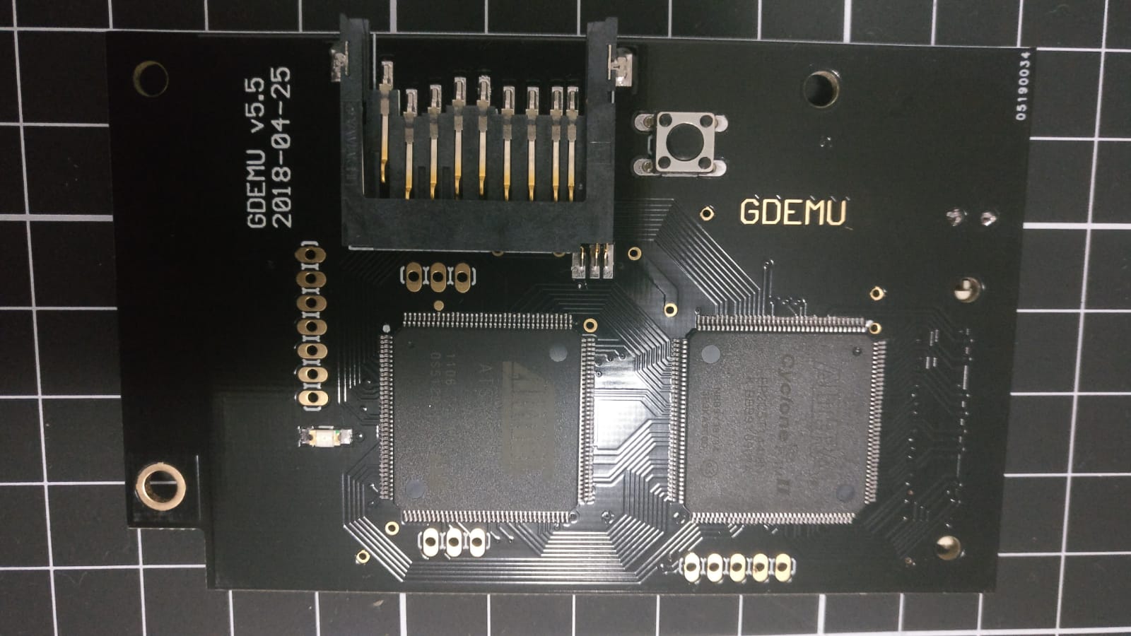

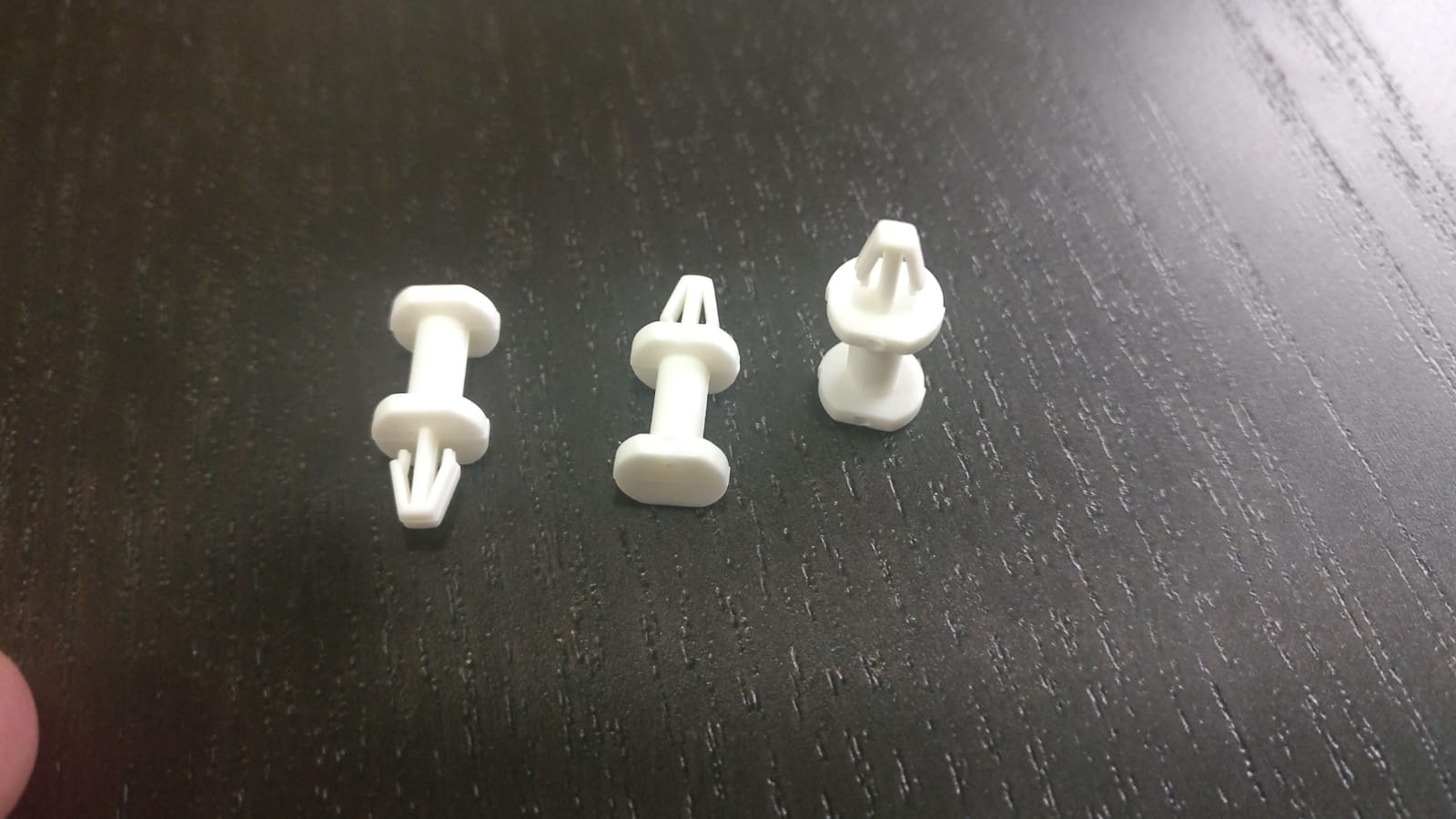

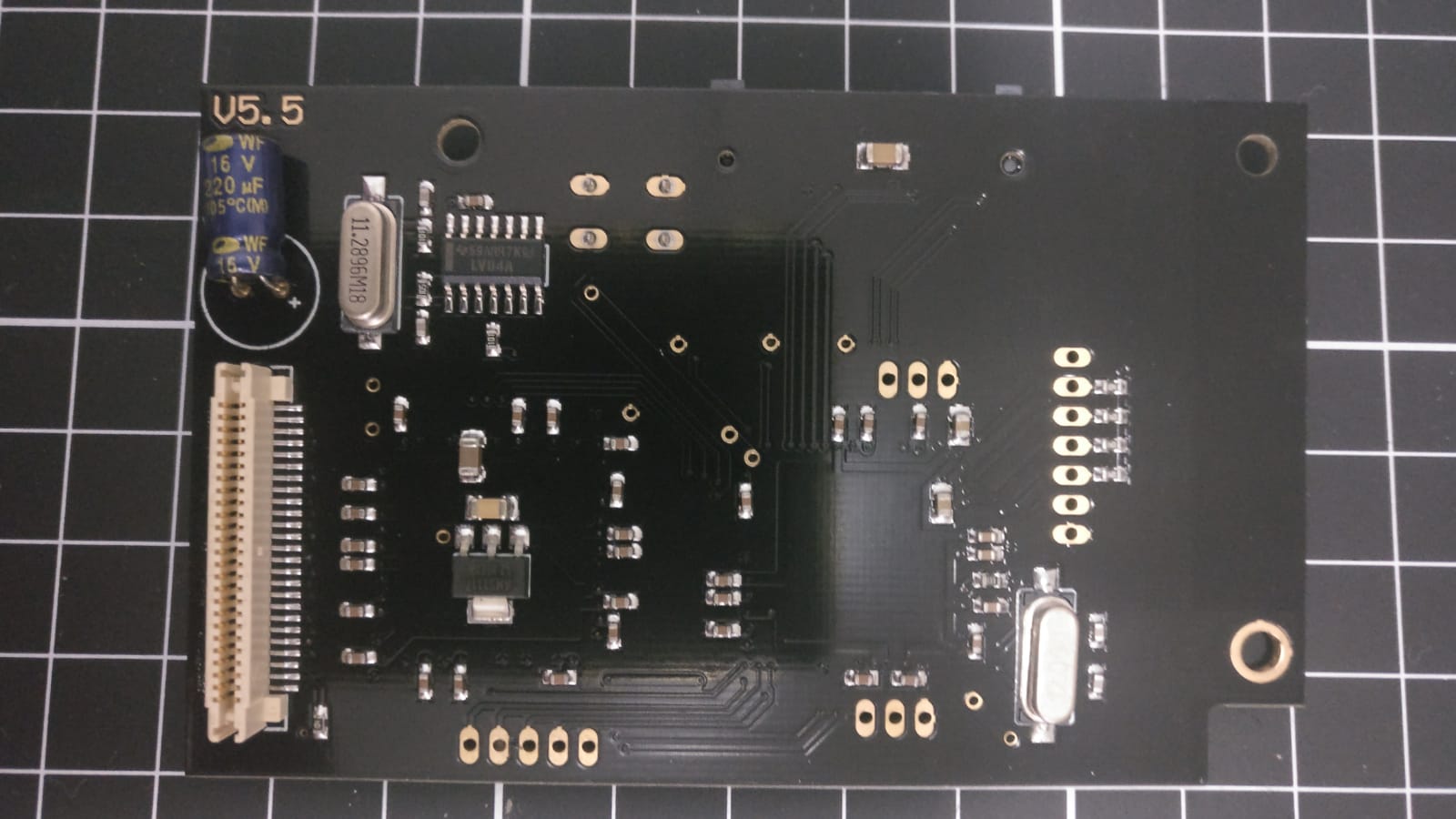

  16. Teddy Rogers
    Teddy Rogers Spirited Member
    Aug 31, 2014
    125
    I have a genuine v5.4 GDEMU and a bootleg v5.5 GDEMU (that arrived today), see the photos below. From my very brief look I can't physically see any differences between the two. In the parcel that arrived there are three plastic pegs/pins for securing the board to the Dreamcast. They don't look like they will do the job too well and I don't know if these are the same type of pegs sent with new genuine GDEMU's. From memory my board came with a plastic sleeve and screw(s) to secure to the Dreamcast where these bootlegs look like the board simply sits on top. My GDEMU is currently sitting on a 3D printed mount.
    I have not plugged in or tested the board out yet. I'll probably do that next week and see if there are any performance differences between the two. I will test a few SD cards and see if there are any formatting, compatibility, size issues, etc. I don't know what differences exist between v5.4 and v5.5 boards whether hardware or firmware related and if that will have any affect on things.
    Shenmue_Trilogy and Anthony817 like this.
  17. truemaster1
    Nov 10, 2015
    512
    226
    lool at the actel chip in both there are diference there. no there are no diferences in 5,4 5,5

  20. krisk77
    krisk77 Peppy Member
    Jul 20, 2012
    351
    49
    The clone has a more black glossy finish, uses a slightly different version of crystal oscillator, capacitor (different voltage rating) and FPGA chip, etc. The pegs are not the same size of the original one sent with the official board and they are shipped with 2 300ohm resistors (1 spare) for the 12v/gnd psu.
    Also, heard they dont sit flush with the 3D printed trays, as the PCB is also slightly thicker, yet that needs more confirmation.
