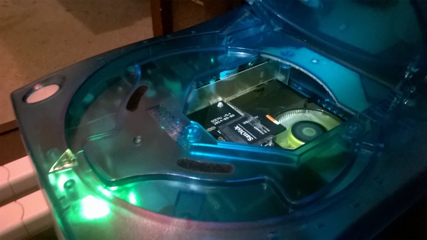

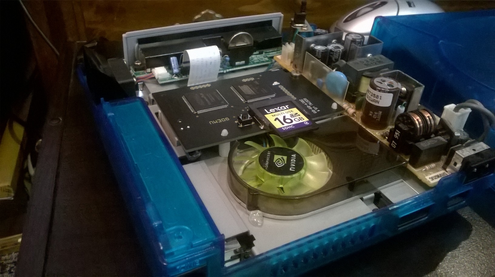

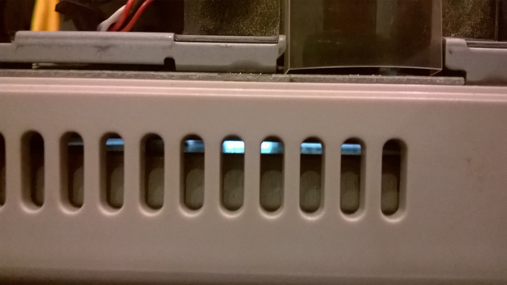

  20. TacT
    TacT Member
    Sep 18, 2015
    Does that resistor really help the 12v and keep the psu cooler? I don't really have a problem anymore. I like your duct work there, if you notice most of the air from the back vent was designed to go underneath the gd drive and above the cooling plate for the cpu/gpu so I assumed the psu didn't get much airflow to begin with. but here's what I did I happened to have the perfect fan on an old small graphics card.
