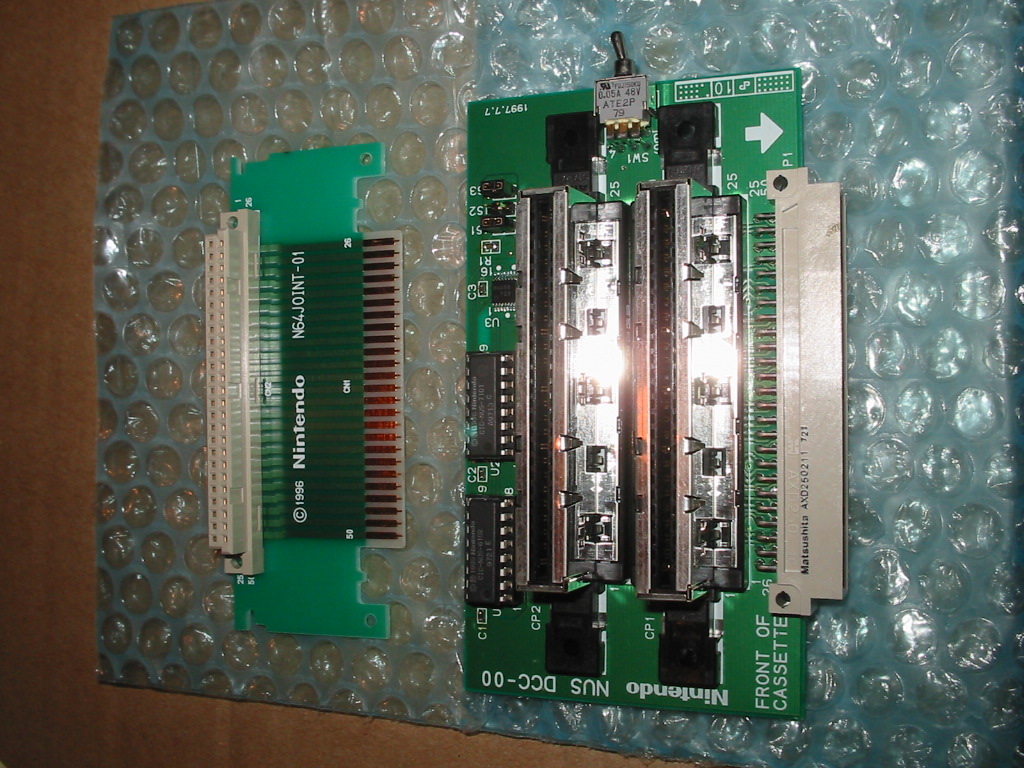

    Since you seem knowledgeable about this stuff, maybe you could answer a question that's been puzzling me for a while - I used to have a 64DD dev setup, (Partner 64 + 64DD dev drive) and there was a piece in with it that I couldn't work out the purpose of. It was basically an adapter that went into the N64 and let you plug two cartridges into it at once - this appeared to be an official Nintendo product and had some chips (including a CIC) on it. Initially I thought it was for plugging in both the Partner 64 and the IPL cart, but the instructions didn't mention it at all and said to connect the IPL cart to the socket at the top of the Partner 64. I think the marking on the board was "NUS-DCC" - but unfortunately I don't have that setup any more and I can't find any photos.
  10. Kao
    Kao Gutsy Member
    Dec 30, 2010
    458
    307
    Is it this guy in the bottom right?
  11. TriMesh
    Jul 3, 2008
    2,324
    Yeah, that's it - it was just strange because it was in the box but not mentioned anywhere in the documentation

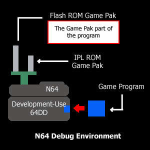

  12. Barc0de
    Oct 29, 2005
    11,205
    The NUS-DCC (Dual Cartridge Connector, if I recall) is used in order to have two carts inserted in parallel. One slot would hold the Initial Program Loader for development (loaded in the Flash ROM or as part of a combo game, such as F-zero X) and the other would be the Font and Sound sample cartridge (IPLROM). From what I understand, it was used for debugging/testing games in scenarios where Partner was not used, on dev DDs (Which don't contain any ROM).
    e.g : Distributing the game or IPL to the testing team on regular flash carts + the corresponding blue disks
    The Font+Sound+IPL are combined (and modified as to certain memory offsets and a few other bits) in the retail DDROM.
    Hope this solves your question TriMesh.
    takensorryuser, alecjahn, Kao and 3 others like this.

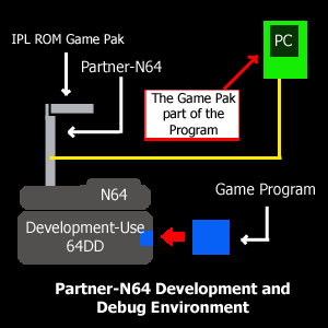

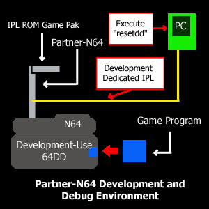

  13. Barc0de
    Oct 29, 2005
    11,205
    I've attached some old media that illustrate this point.
    Disclaimer: I don't own the rights to these images.
    DS2 likes this.
  14. TriMesh
    Jul 3, 2008
    2,324
    Thanks, that makes perfect sense now. I guess it was supplied with the development drive, but the docs I had were for the Partner64 + DD setup, which didn't mention it because it's not needed in that configuration.

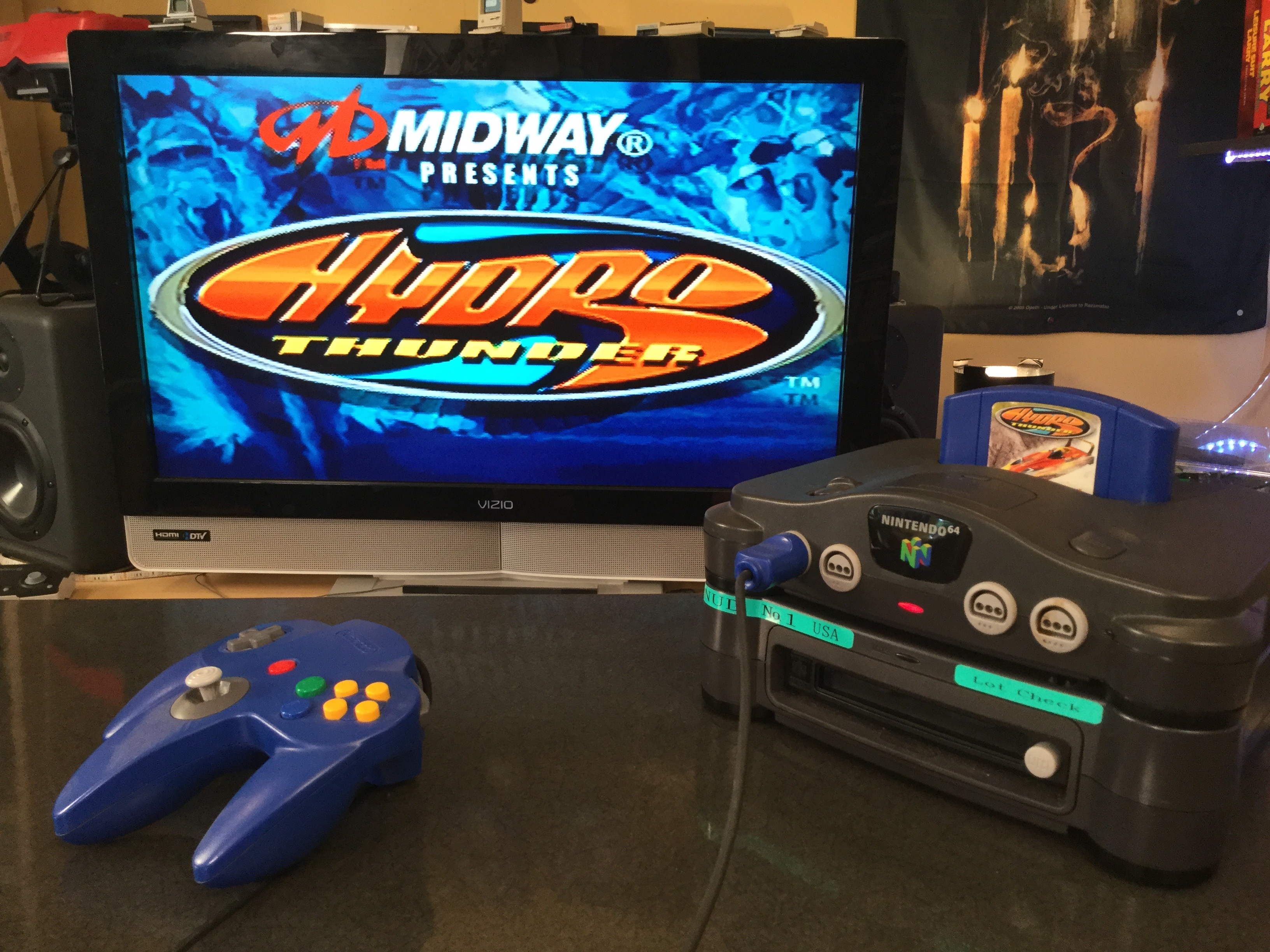

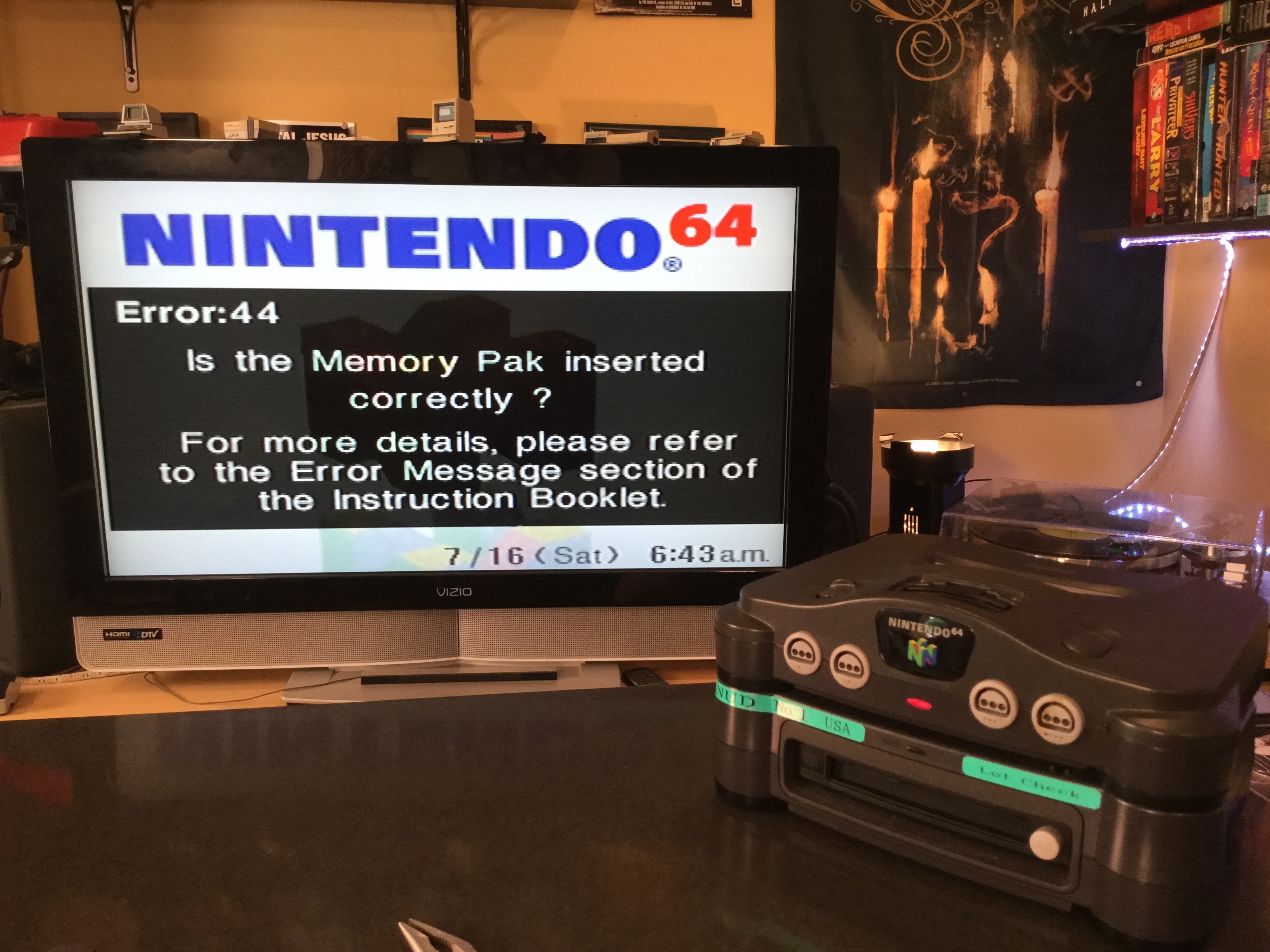

    I've had a couple questions about the unit. Specifically:
    1) Have I tried booting the unit without the memory expansion and just a Jumper pak? See error screen below
    2) Can you run US cartridge games with the drive attached (yes, see screen low)
    Kao and SubDrag like this.

  20. LuigiBlood
    LuigiBlood SNES and 64DD Savior
    Sep 21, 2009
    171
    139
    Why the hell didn't I get emails even though I've put this thread on watch...
    Anyway that disk on eBay can be empty. Just to watch out.
    About the NUS-DCC: We used that to dump the DISK cartridge by putting that and a 64drive to dump it using the IPL dumper.
    Anyway, @PostedOval, keep us posted about any news about your disks and the dump of the US IPL ROM inside your 64DD.
