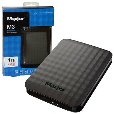

  20. sigarette
    sigarette Newly Registered
    Jan 31, 2015
    I use hdd
    HD USB3 2,5" Maxtor 1TB M3 Portable Black extern retail
    detail
