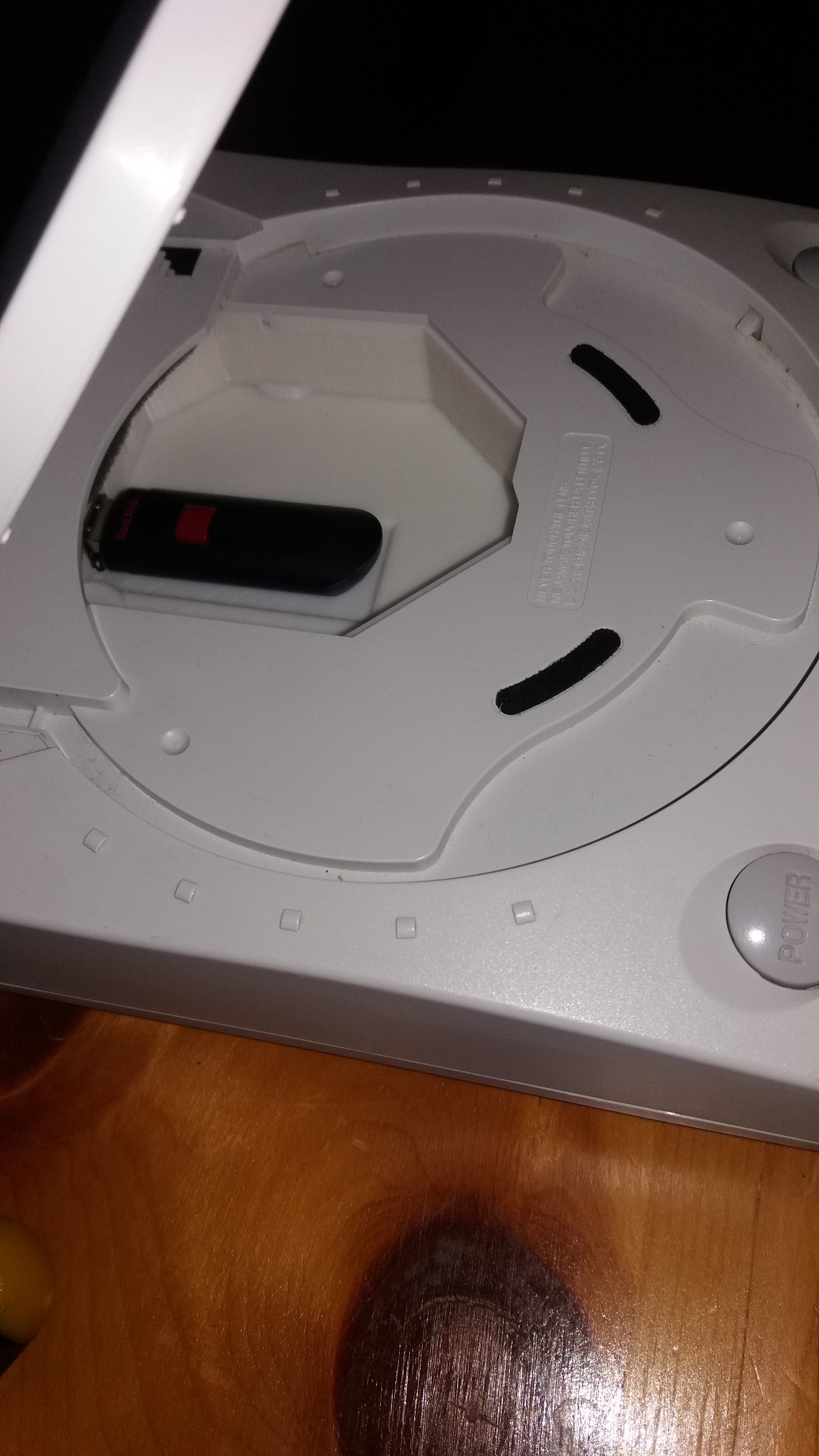

    I finally got around to working on a part to finish out the drive bay around the USB port.
    It snaps into the top shell where the GDRom would normally sit, then put the system back together and now your system isn't open to lose a drive in.

  5. Joe Szymkowicz
    Joe Szymkowicz Member
    Jan 17, 2016
    That looks REALLY clean. Nice work!

  7. Collingall
    Collingall Robust Member
    Jun 13, 2016
    210
    131
    I will be willing to sell them, I need to make a few changes so larger USB disks can fit. I also want to put a slot in to store an extra drive in the case.
    I'm also working on a version that will support a 2.5" hard drive.
    Edit: I got it to work with my largest USB drive and put the storage slot in for an extra USB drive.

  8. RXShorty
    RXShorty Rising Member
    Apr 19, 2016
    50
    That looks awesome!
    The lid switch still works with this?
  9. Collingall
    Jun 13, 2016
    210
    131
    Yes it does. This part only sits where the plastic from the original GDrom drive was. So it doesn't interfere with anything else inside.
