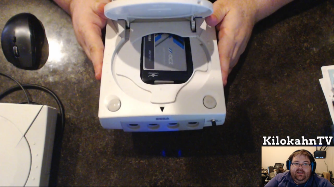

    Here is mine and it feels fine.
    RXShorty likes this.
