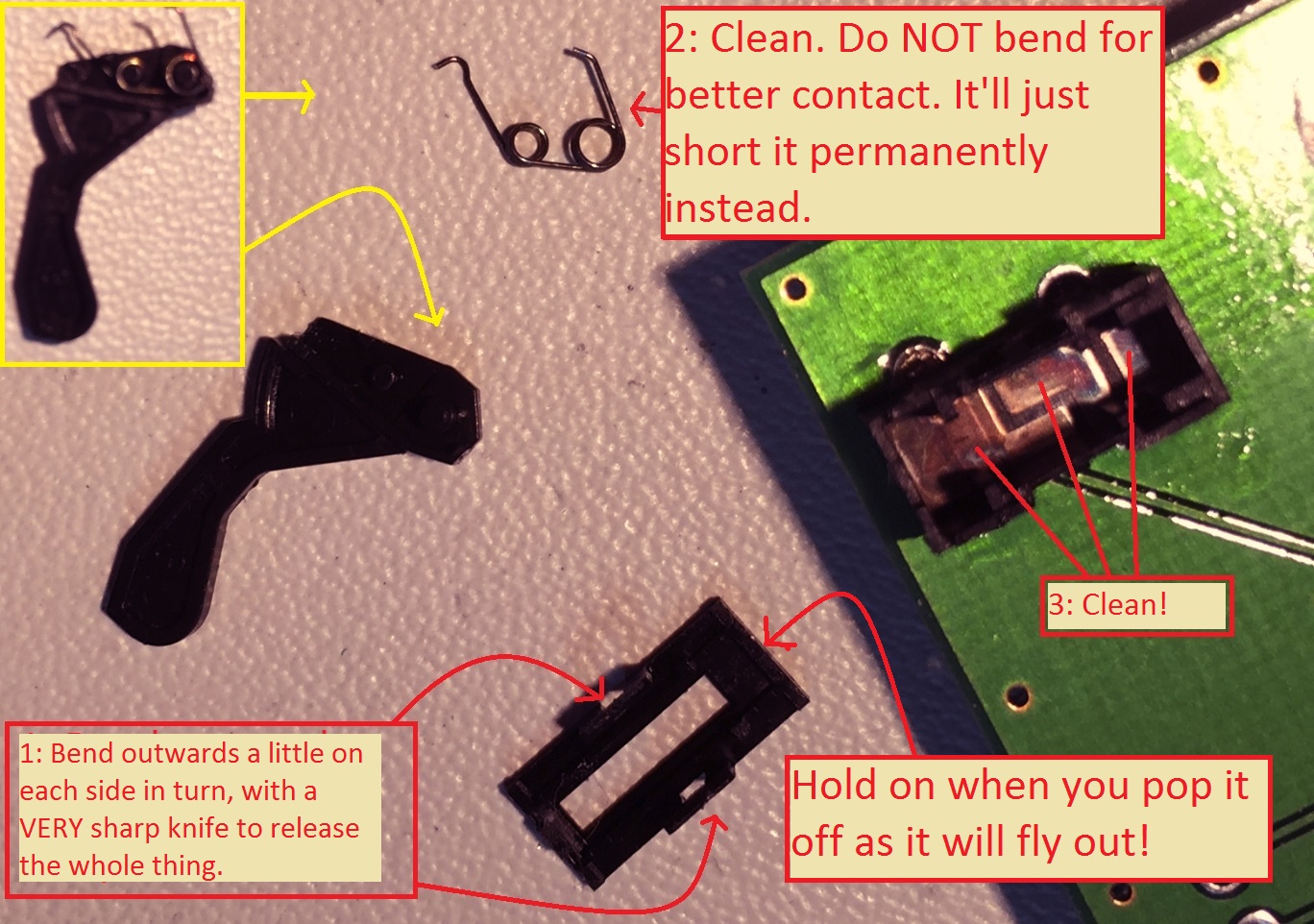

    Edit: Never mind. I think my switch is bad. If I hold it a little to one side, it works but sometimes it gives no continuity on the multimeter. Managed to get it to work once but giving it a little nudge to the side =(
    Edit2: I managed to open the switch and clean it with isopropanol (IPA). Works like a charm now! Made a little instruction.
    http://www.grandis.nu/images/DreamCast_CD_Switch_Clean.jpg

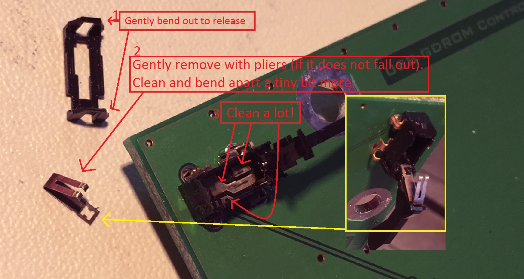

    So apparently there are two types of switches (at least). Here is how to clean the other type.
