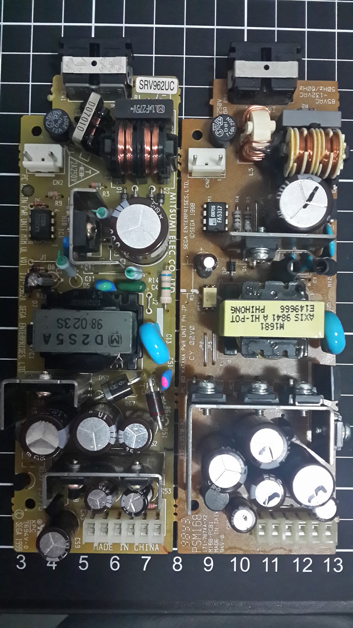

  12. Teddy Rogers
    Teddy Rogers Spirited Member
    Aug 31, 2014
    125
    I can show you how different they look...
    Ted.
    shengoro86 and BLUamnEsiac like this.
  13. Bad_Ad84
    1,308
    It quite clearly shows the accepted input voltage and its well within spec.
    You lot seem to be making a mountain out of a mole hill.
    And showing 2 PSU's made by different manufacturers doesnt show anything FYI.
    americandad, Shinebi and skyway1985 like this.
  14. skyway1985
    Jan 23, 2014
    543
    130
    lmfao jap psu says what? 135v!? lol
  15. Bad_Ad84
    1,308
    I think thats the US one, but its still plenty within the 100v of japan.
  16. skyway1985
    Jan 23, 2014
    543
    130
    BadAd thats the japanese one.
  17. Bad_Ad84
    1,308
    Doesnt really matter, they will both have a similarly wide spec of power they accept.
    skyway1985 likes this.
