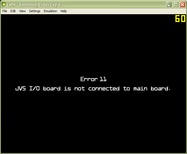

    Does anyone recognize these ports?
    http://pastebin.com/Ac1fgPWz
    Not sure what these are...

    No idea at the moment. I can try to check it next week though, I have lots of port documentation at home (currently at my parents).
    If they are only on chihiro games I'd assume it's the baseboard communication.
    You don't really need it in the beginning though (might be necessary if games are not cracked?) - I just checked in my own emulator and I ignored all port i/o. I still got to a point where I had the Chihiro logo showing up.
    Could you provide a backtrace with detected function names? Also, when does this happen and what happens if you ignore these?

    I don't believe the functions have names, but I can probably still give you the stack trace.
    What I did was add some code in the exception handler to skip over the privileged instructions. These start getting executed somewhere after JvsEEPROM_Write is called and when I ignore them, nothing bad seems to happen. Right now, the game is trying to register an shutdown notification with a DPC. I can easily get passed this, but after that I don't know what's going to happen.
    EDIT: Skipped passed the privileged code and added all the necessary JVS functions, and now I'm getting Direct3D initialization stuff. Now I'm just stuck on one function where the stack trace is utterly useless...

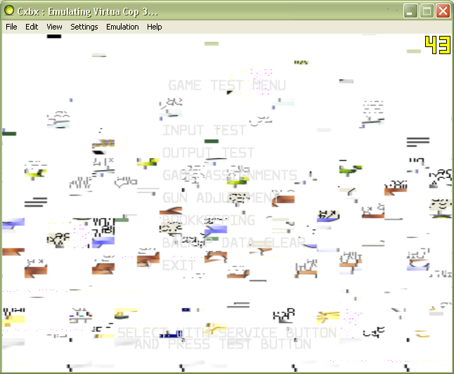

    Okay, got the test menu to show. After receiving the parameters from XLaunchNewImage, it started showing this. The garbage on the screen behind the text is just a result of the render target not being set/cleared properly (AFAIK). The menu does work, but will crash upon exit and it's an internal crash that I've never been able to fix because my debugging skills suck.
