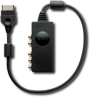

    Youll need those cables :)

    Ah balls... I'll have to order some, will 3rd party ones work for it?

  14. bennydiamond
    bennydiamond Gutsy Member
    Aug 24, 2011
    476
    180
    Not at all, you can get generic cables on ebay and other sites. Be advised that these cables do not offer digital audio out...Only regular stereo analog.
    For that you will need a Xbox HDAV component pack. These are more rare and cost more. Also, you have to supply your own component cables (male to male).
    So if you don't have a sound system that takes in digital audio in (TOSLINK) you should take the regular cables as they are a way cheaper solution.
    I have both and the regular cables produce picture quality as good as the HDAV pack (tested on 480p and 720p).
