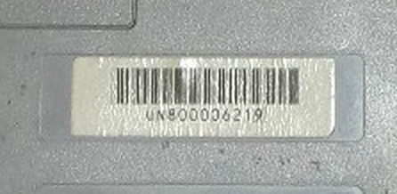

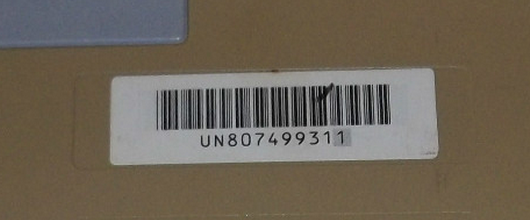

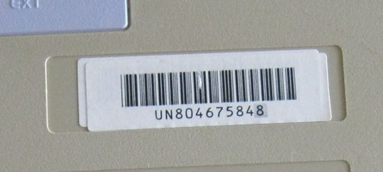

    I've seen some serials starting with UN8, anyone knows what these are? They often have another sticker under the serial number so I assume they're official refurbs but I don't know what board is inside.
    If no one knows I may get one and find out. Is it normal for them to replace the entire board, or will it just be whatever the original board was, with repairs?
