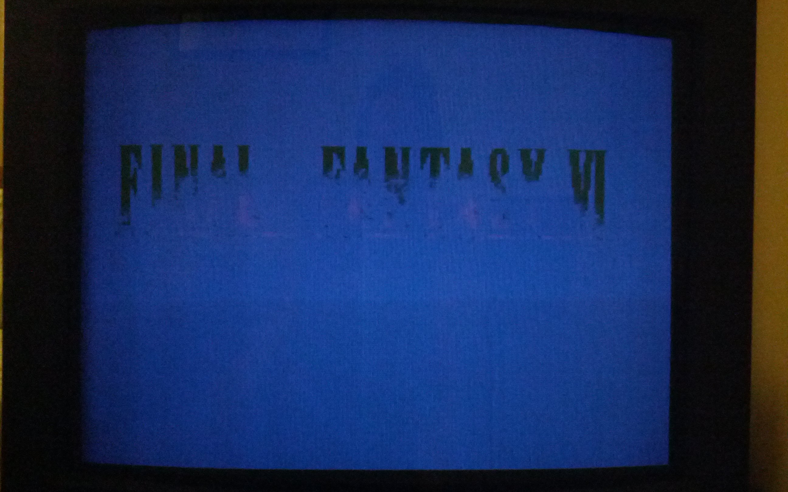

    Whoops! Very hard to see otherwise. Seems like a few also...
    I blame the TV haha

    Just got in a USA SNES from ebay. Serial # is UN320962590. Board revision is a 1CHIP-03. Minor display glitches in Demon's Crest and Super G'NG confirmed from my own library. I'm hesitant to buy the older original boards like the CPU-01 because they are starting to fail with corrupted graphics. I have two older console revisions that have screwed up scaling and rotation now from old age. I suspect this will become more and more the case as time goes on. In fact I recently had to return an older model from an ebay auction as once again, the scaling and rotation functions were corrupted. In Pilotwings, the altitude meter will be corrupted. In Link to the Past, the opening triforce will often be completely missing, and the draw bridge in Castlevania IV will behave erratically. These are some examples of console graphic corruption (not to be confused with dirty lead corruption), and the behavior will be different and unique in each case.
    Edit: BTW, my 1CHIP-03 has no visible center stripe. I did several tests, including with FF3, and could not see it. By comparison, my APU revision SNES has a blatant center stripe.
