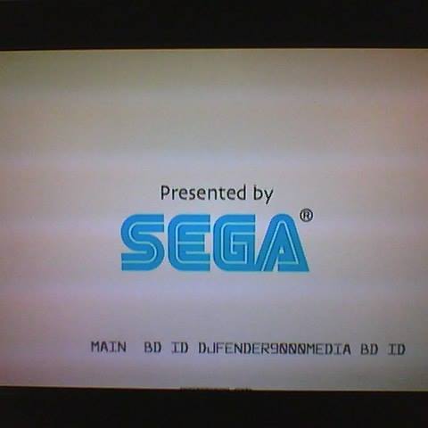

    I know I may be necroposting from beyond the grave, however I had some success specifically burning a Standard XBOX bios with the normal default.xbe instead pointed towards vc3_t.exe which solves it locking up on a stock xbox until it gets to the main loading menu, I really am intrigued as these are the games I used to play in the arcade all the time and I know how they're supposed to run :)

    DJFender: I'd rather attempt to burn / mod a Chihiro bios then, but at the moment I don't see anything different to your approach from running it normally through a dashboard?
    vc3_t.xbe also works for me on my stock Xbox and vc3.xbe works until the Sega Logo.

    did you try hammering start right before it attempts to load the Media Bd ID? or just outright patch it :D
    I'm looking into flashing the standard bios to my machine and figuring out how the Media Board sends segaboot to the main loader, but it seems to lock it up all the time (perhaps the MCPX X2/X3 difference?) I'm really intrigued at possibly emulating the missing parts with whatever at hand. I'm also interested in the progress on your launcher.

    So you patched the XBE printing code to show the board id like that?
