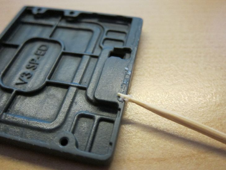

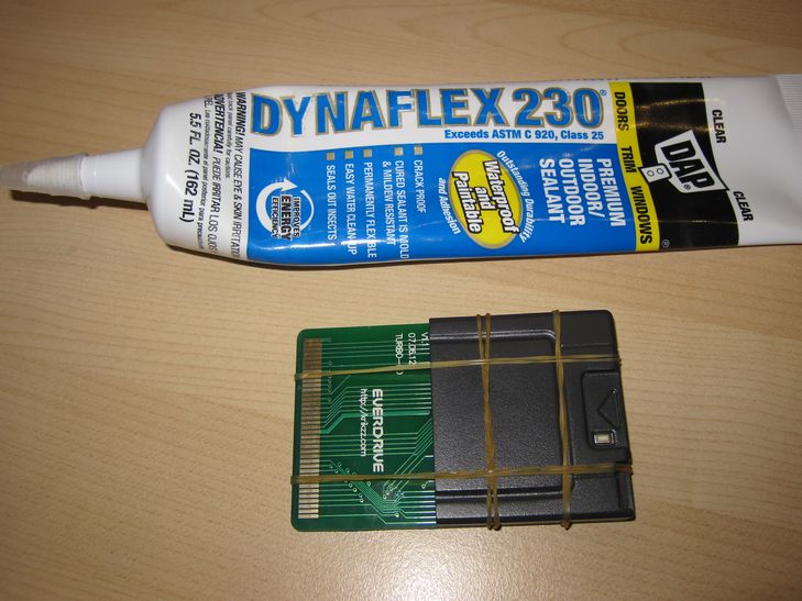

    Try using latex based "clear" caulk instead. It will take a day to dry but it's pretty secure when cured. It can also be removed relatively easily if needed with a thin blade.
    Just use a tooth pick to apply the caulk along the perimeter of the shell. It goes on white but dries clear. After you place the shell over the PCB, use a damp paper towel to wipe away any excess caulk that seep out.
    Put some rubber bands and let it dry.

    BuffaloWing, thanks for taking the time to snap photos of the procedure, and of the caulk you used.
    I <3 Visual Aid. ;)

    BuffaloWing, I'm a complete idiot when it comes to this sort of thing, so thank you for your simple guide. 3.00 later, I'll have your cover secure on my Everdrive with a ton of caulk left over for my house. Thank you!

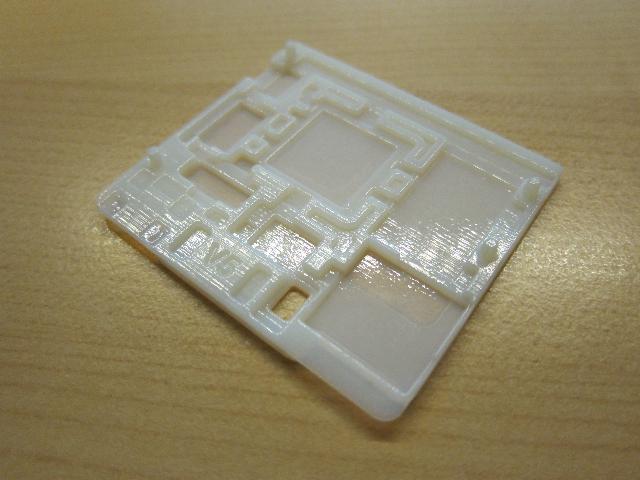

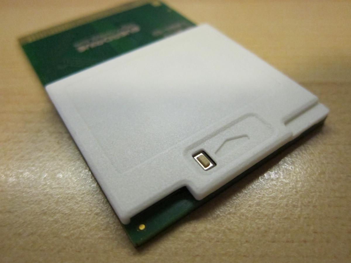

    I've been working on a "low profile" version for a while that removes the protrusion, but I recently discovered the new V1.2 PCB would not fit. Bear with me if you want this version.

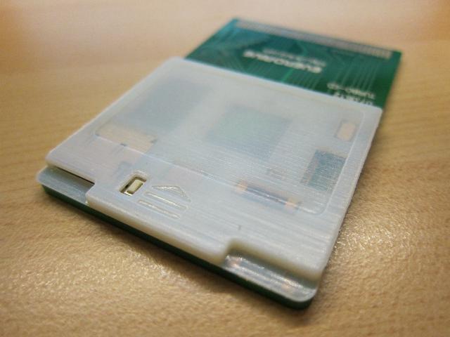

    The low profile version look pretty much like the prototype version shown below. The only difference is that the other corner is fully notch out like the microSD slot side. So both corners are exposed. This one only work on version 1.1 and 1.2 PCB. I was recently told by someone that there is a version 1.3 PCB out in the wild and it requires some modification to fit. I don't have 1.3 board nor have I seen a picture of it, so I don't know how much was changed.
