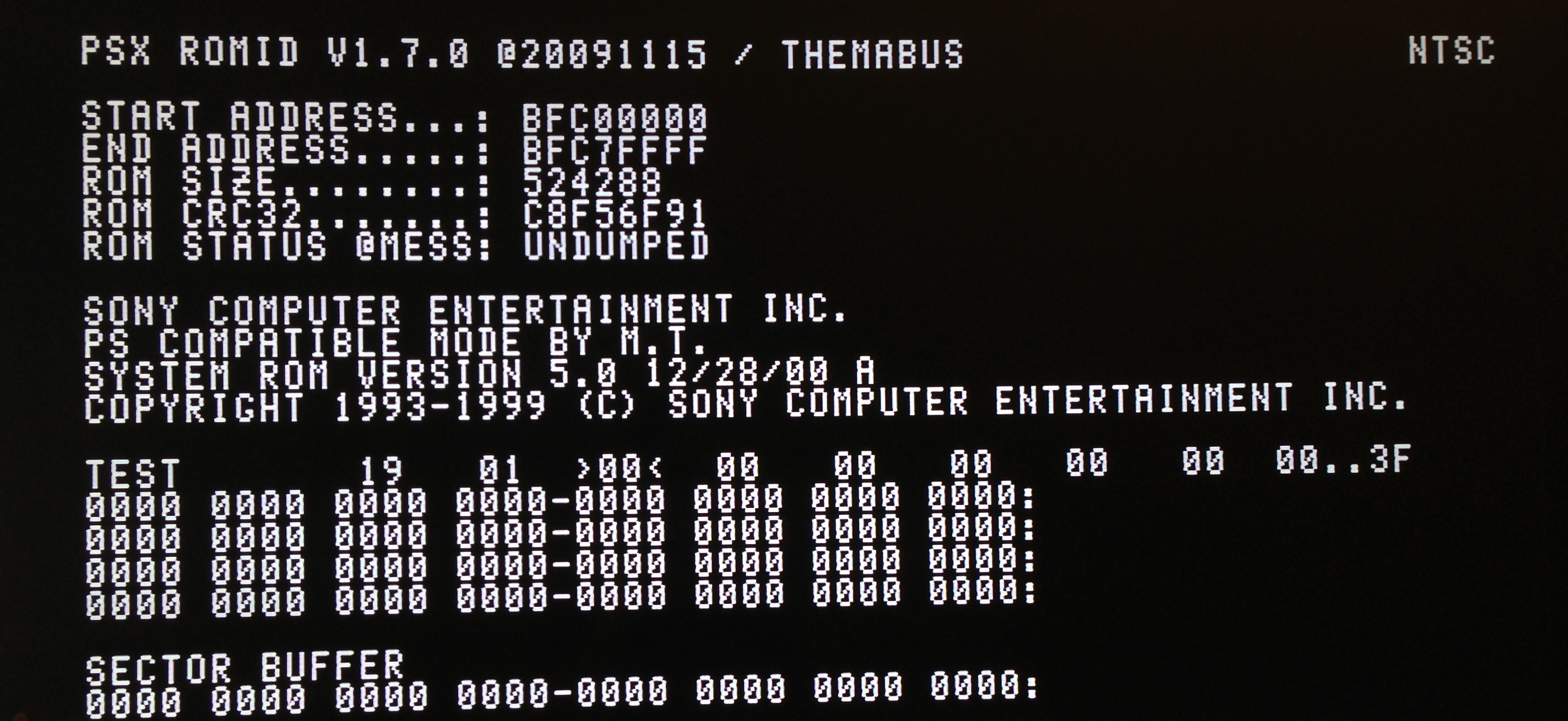

    I was curious and put the ROMID disc into a bunch of PS2 TEST, and PS3 TESTs + TOOLs and the result are all "undumped" . That's why I asked.

    Not sure if this is useful but since I have them hooked up ready so I checked them out with the ROMID disc.
    all the PS3 TESTs report the same result so I only include one pic (DECHA00A, DECHJ00A, DECH-2000A, DECH-2500A)
    It has SCEI bootstring when booting the ROMID disc
    DTL-H30101. No bootstring
    DTL-H75000A no bootstring

    @Shendo: My result posted above (the 1st pic) including running ROMID in the SLIM PS3 TEST (DECH-2000A and the DECH-2500A). All the PS3 TESTs give the same result. This include all the PS3 TESTs has been released (DECHA00A, DECHJ00A, DECH-2000A, DECH-2500A). The DECH-4000AA has been planned but has not been released so I can't test it.

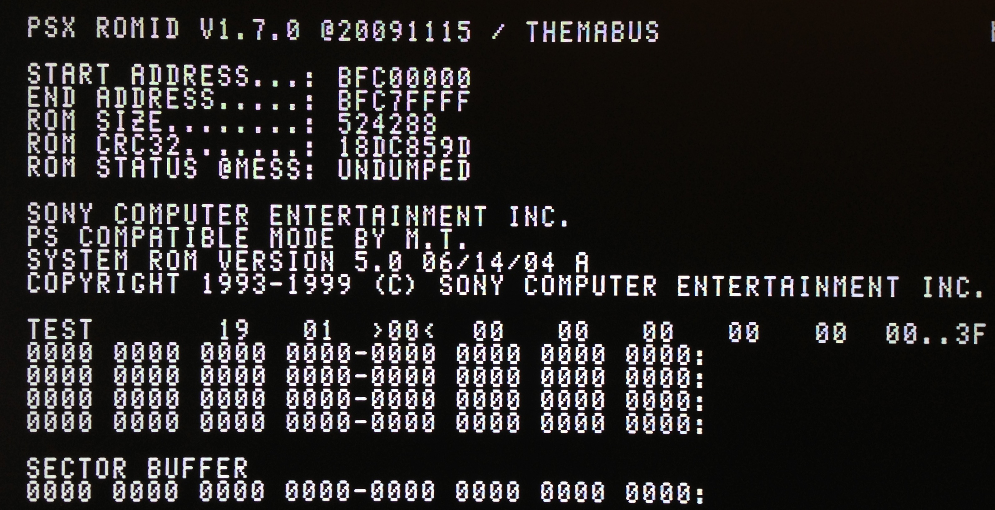

    The second pic is ROMID running on DTL-30101, a FAT PS2 TEST which is equivalent to the SCPH-3000x retail.

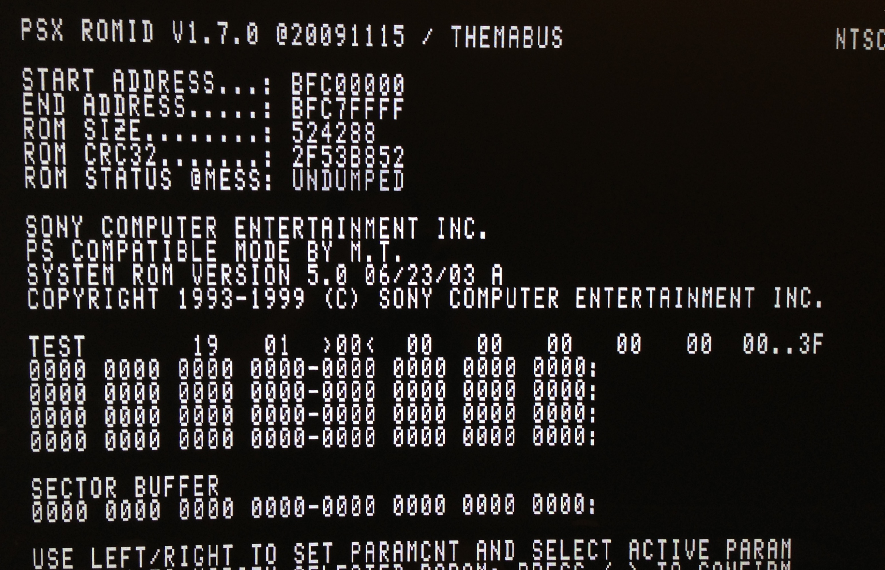

    The last pic is ROMID running on the DTL-75000A, a SLIM PS2 TEST which is equivalent to the SCPH-7500x retail. The H75000 is the latest PS2 SLIM
    If you want, I can run ROMID on all the PS2 TESTs has been released, including the DTL-H10000 (SCPH-10000 equivalent), DTL-H30000, and the DTL-H50000
