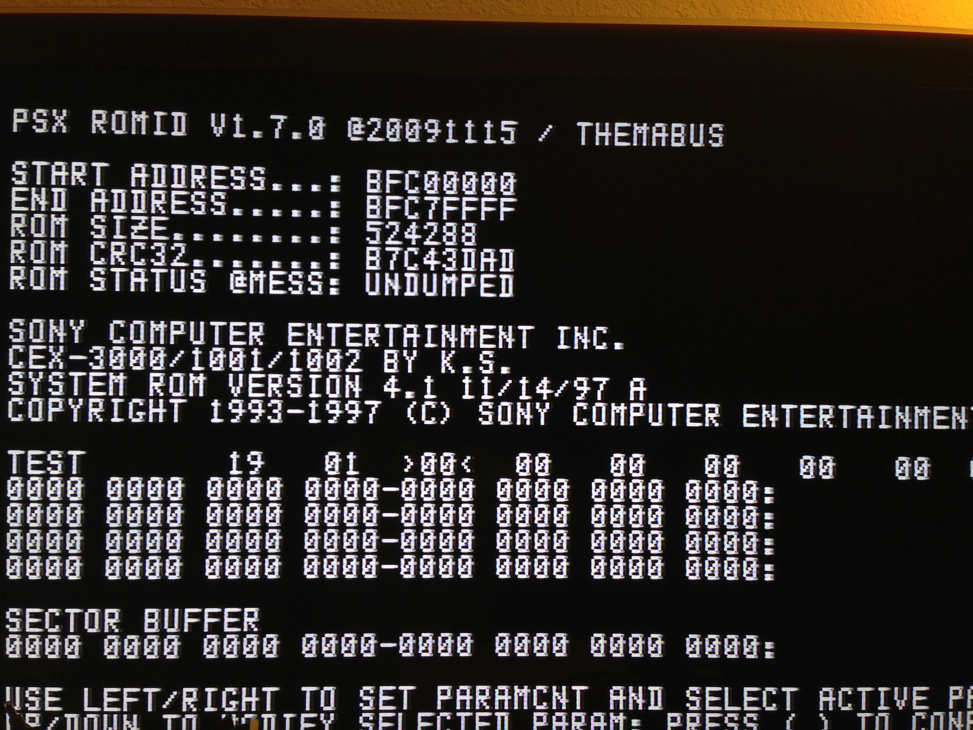

    It's got the right boot ROM for a 7501 too - the 700x series used a 4.0 boot ROM with a different kernel (CEX-7000 in the kernel line) - but I guess it had bugs since they went back to the old one afterwards.
    The other thing I've just realized is that the ROMID CD is mastered with Japanese license data on it, and obviously doesn't have any wobble groove data (since it's a CD-R) - but the 19 03 60 Dx 01 data contained "SCEA" - which is the correct territory for the CD controller, but not the disc. The only place I can think of that this might have come from is a modchip.
    Since we now know that the unit has a stock ROM, this also implies that the license string on the boot screen should always be "SCEA", no matter what disk you boot, since that's the string in the mechacon RAM - but from what I remember early on in this thread the thing that seemed unusual about the system was precisely that this string changed...
    Is it possible to check this again?
    When you boot the ROMID disc, what does it display below the "Licensed by Sony Computer Entertainment Inc" string? SCEA or SCEI?

    I think I understand what happened now. I messed up this one (9903) with another one (7000W). the 7000W's string change based on the region of the disc but it won't boot CD-R (unless you do swap trick). I'm reconfirming everything right now. It has been 10+ yrs so my memory is a bit rusty.
  15. tichua
    tichua Site Supporter 2012,2013,2014,2015
    Feb 5, 2008
    489
    I tested the 9903 with Dino Crisis 1 and 2 (Original disc). The game boots up and plays just fine. No warning screen or freezing. I don't have other games to test yet. I might need to find it on fleebay or download an iso to test it out.
    When I boot ROMID disc, it shows SCEA. When I boot NTSC-J disc, it still shows SCEA. I don't have any PAL discs on hands to test at the moment. I can look for PAL games in the attic and test it out if necessary.
    And I think I messed up. The 7000W changed the string to SCEI for NTSC-J games and SCEA for NTSC-U/C Games. I ran ROMID on it and it's shows "UNDUMPED"

    Awesome. That model (7000W) seems to be the special "10 million model".
    Myria has the same one, as it can be seen in this thread. He also noticed that the BIOS was undumped.
    Unfortunately he only posted MD5 and SHA hashes but not CRC32.
    If you dump it and get the same hash it would pretty much confirm the BIOS so it's info could be added to BIOS database on redump project.
