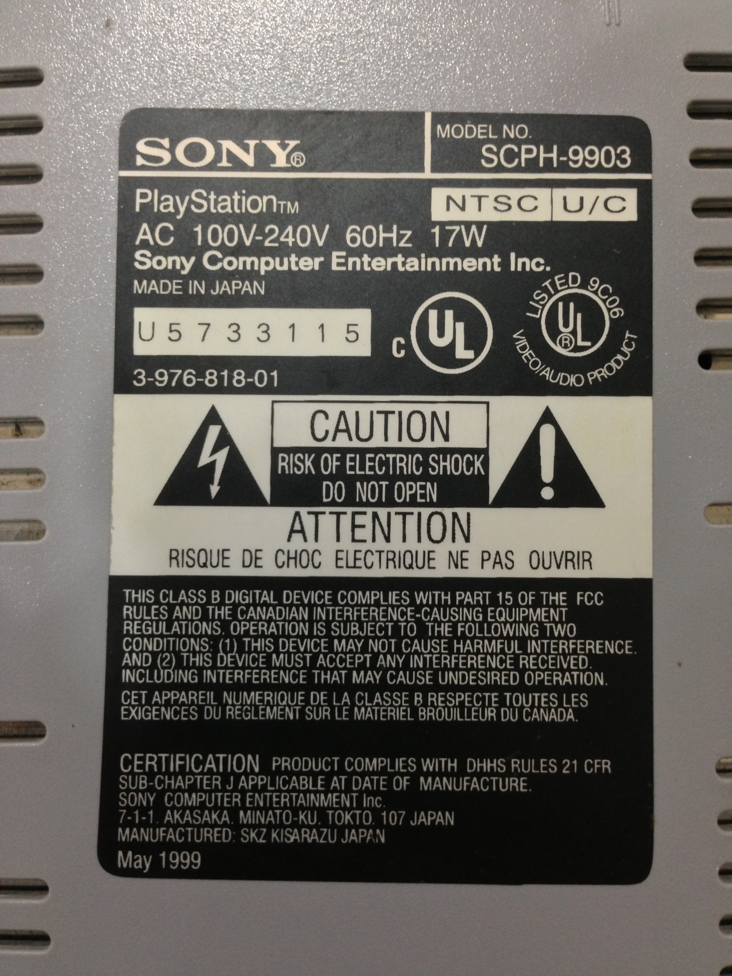

    Sounds like a dumb question since I have one in my possession but I've never seen a second SCPH-990x during the 14 yrs. Does this model actually exist ?

    There is a "Property of Sony Computer Entertainment" seal covers one of the screws and I can't break it at the moment. It does have the parallel port in the back however. If my knowledge serves me correctly, the PU-23 doesn't have the parallel port. Please correct me if I'm wrong.

    That's an odd beast just based on the label alone.
    The SCPH-xxx3 models were all Asian models. They're supposed to have English boot ROMs, but be region coded NTSC-J. The label on yours claims to be NTSC-UC.
    The standard 900x series models do NOT have a parallel port, however they do have serial ports.
    Manufacture date is correct as it falls between the 900x series and the PSone release.

    I was thinking it might be a sample model since it does boot CD-R and PAL discs. Also, It does have serial port as well as parallel port. The reason I think it's a sample model is because the manufacture date is May 1999 and there is a label below it saying "received on May 25th, 1999 by [a person name] at [name of a office]. I never seen a retail SCPH-990x that why I've been wondering for years.

    The label also says 120V-240V input. All the NTSC-UC units I've seen only have 120V on the labels

    Standard for the SCPH-xxx3 Asian models.

    I'm surprised that it says only 60 Hz. That would mean that it would not work in northern/eastern Japan, which I find quite unlikely. That's probably a labeling oversight. The difference between 50 and 60 is within most computing devices' tolerances, especially for something originating in Japan.

    It is sort of strange - all the SCPH-xxx3 units I've seen have been marked "110-240V 50/60Hz" and have been NTSC:J region coded (even though they aren't specified to work on 100V Japanese power...)

    There is an actual parallel port when I take the cover off. I plugged the Action Replay Pro into the port and was able to play cheat without any problem. So it means the port does work
