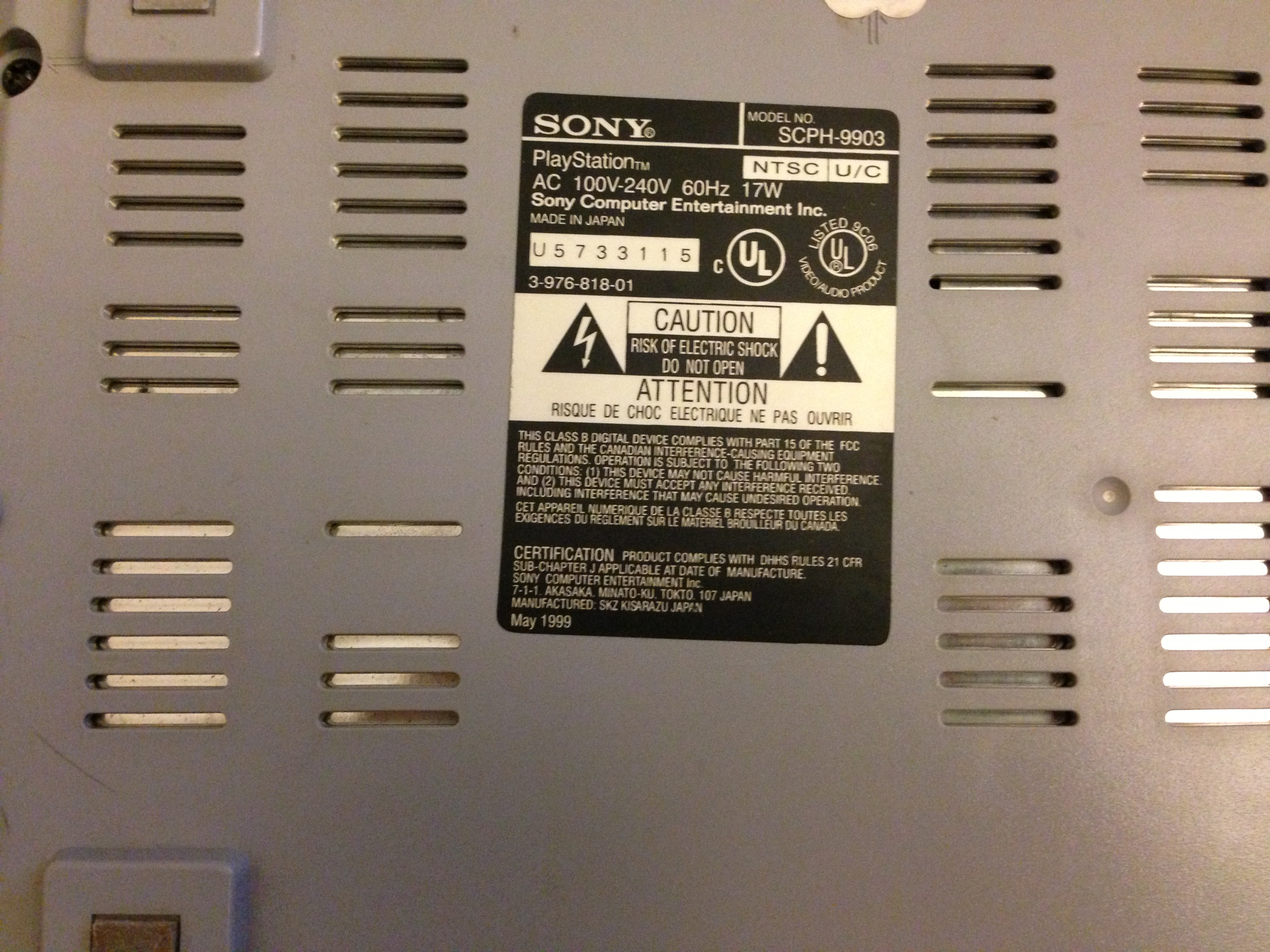

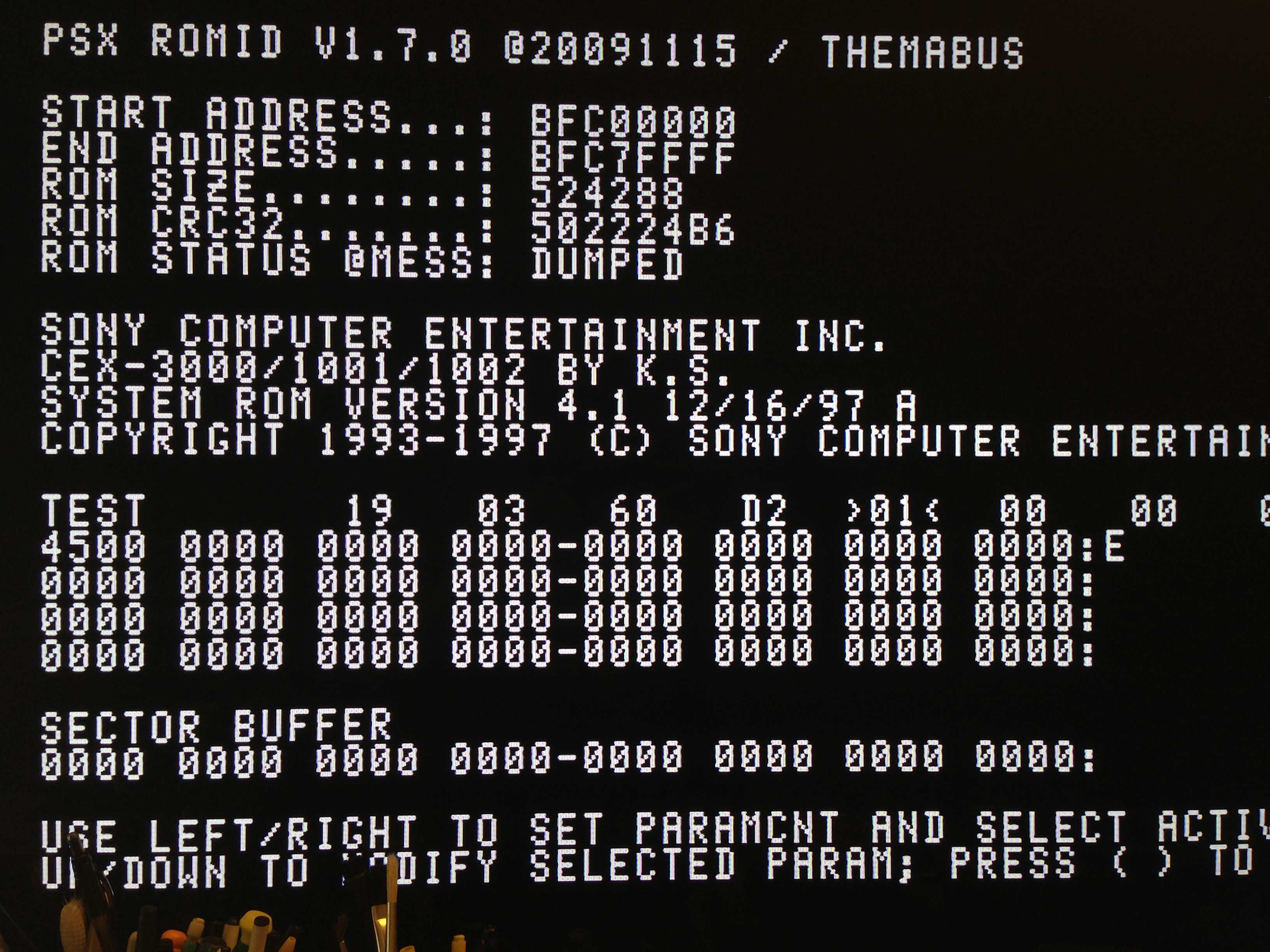

    Sorry for letting everyone hanging for awhile. It's the holiday season and things are packed both at work and home.
    The good news is, I was able to use the PSX ROMID program that CoolerKing suggested to check the BIOS. The bad news (well, for people who expecting something new) is the BIOS has been dumped.
    Here is the match I found that corresponds to the CRC32 :
    "name "ps-41a"
    description "SCPH-7001/SCPH-7501/SCPH-7503/SCPH-9001/SCPH-9003 (Version 4.1 12/16/97 A)"
    rom ( name ps-41a.bin size 524288 crc 502224b6 md5 1e68c231d0896b7eadcad1d7d8e76129 sha1 14df4f6c1e367ce097c11deae21566b4fe5647a9 )"
    Here is the screenshot

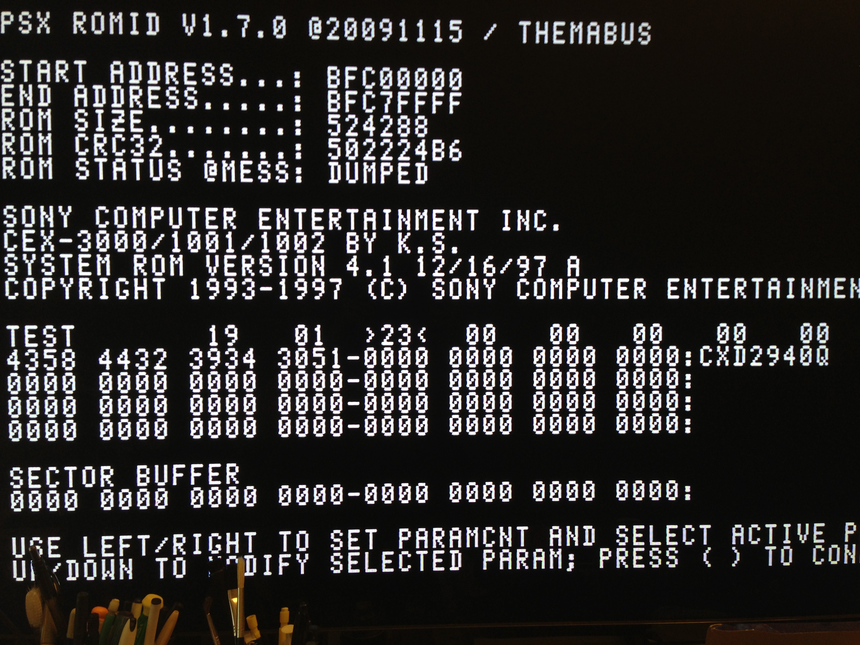

    Could you try something else? Boot up that ROMID program again and record the results of test commands
    19 01 22
    19 01 23
    19 01 24
    19 01 25
    The last three will probably be the same.
    If they are CXD1817Q then the board is a PU-20
    If they are CXD2940Q then the board is a PU-22

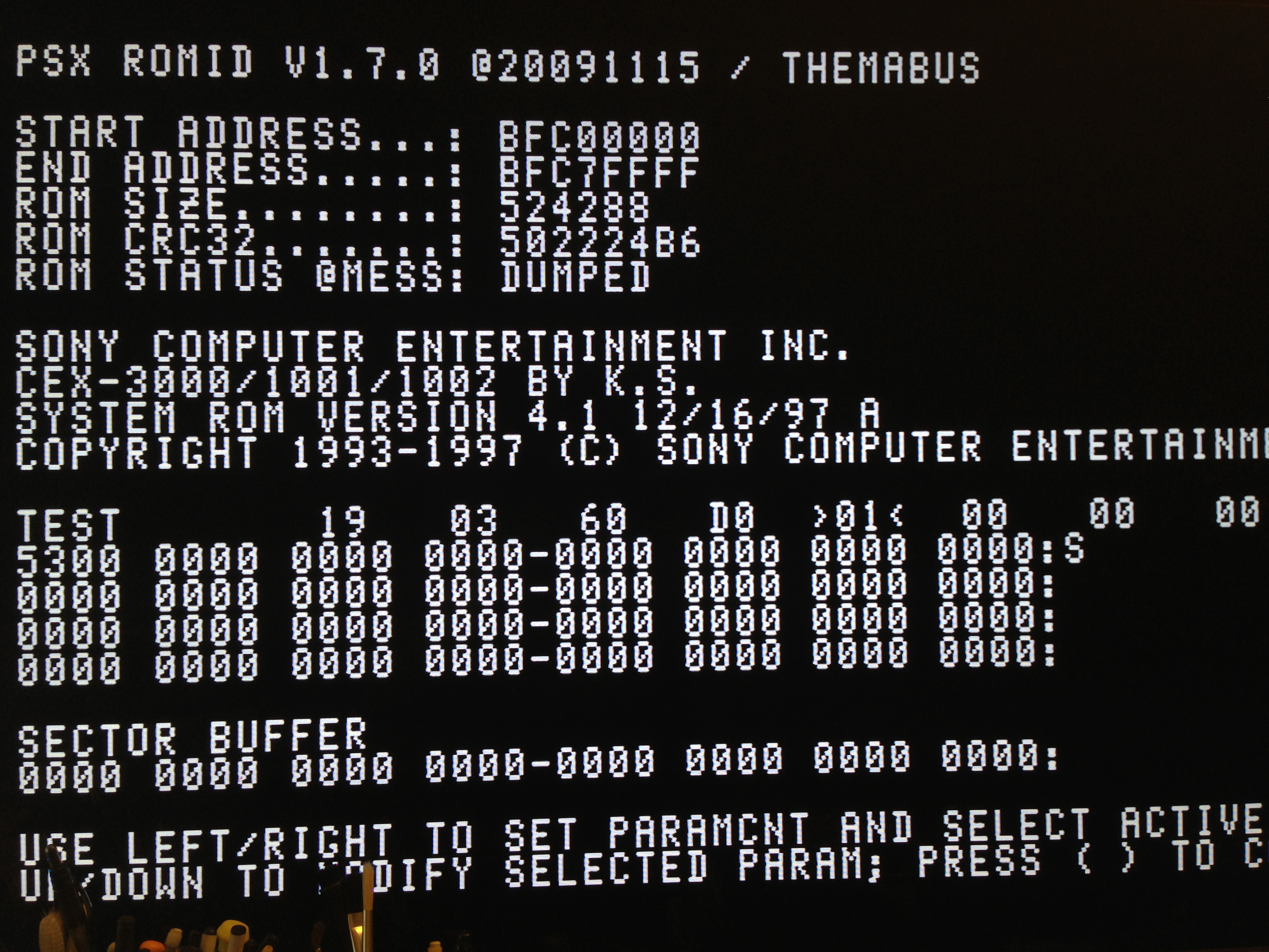

    It might be worth trying the commands to directly dump the ID string from the mechacon RAM, too - these return one character of the ID string each:
    19 03 60 D0 01
    19 03 60 D1 01
    19 03 60 D2 01
    19 03 60 D3 01

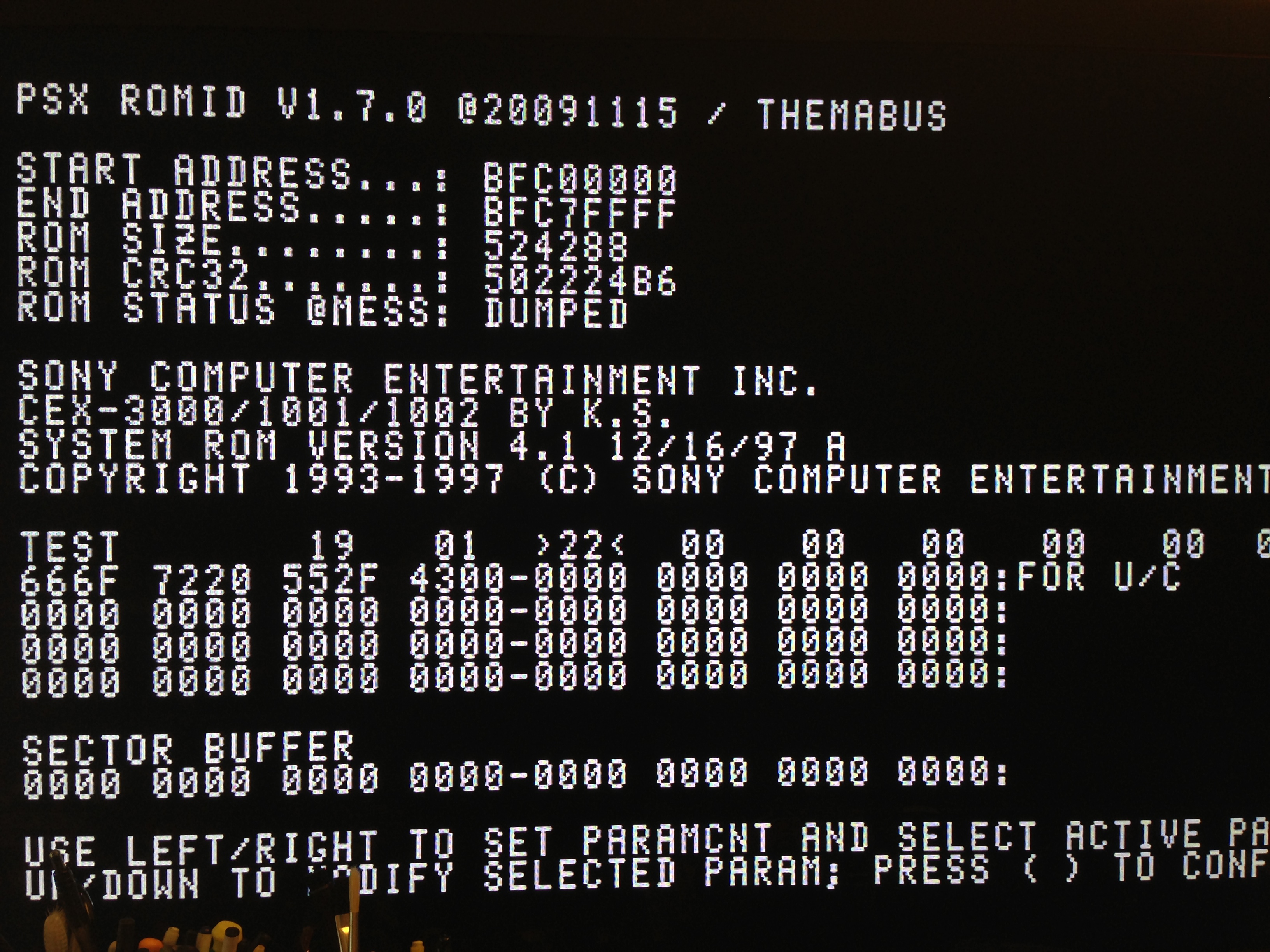

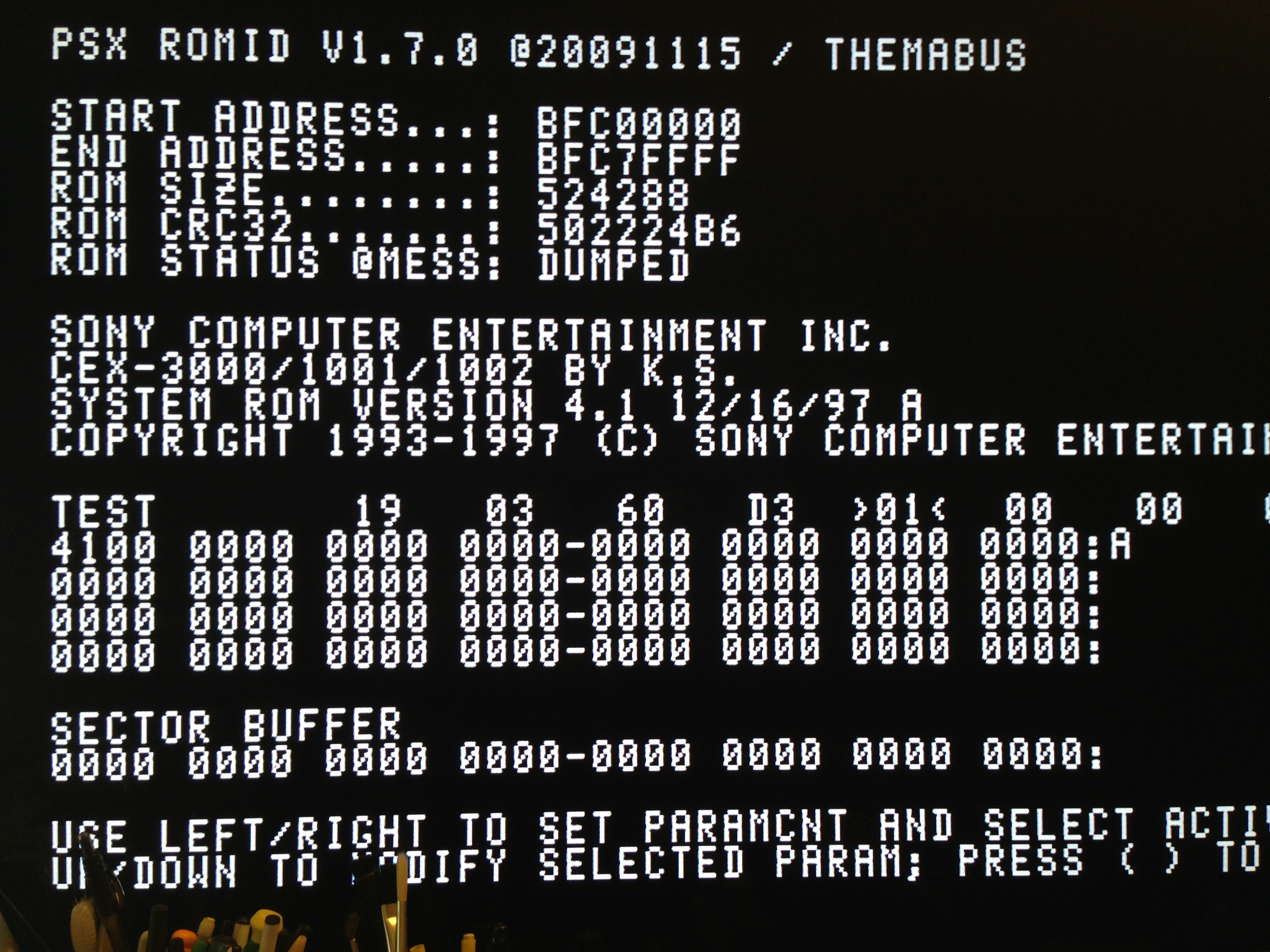

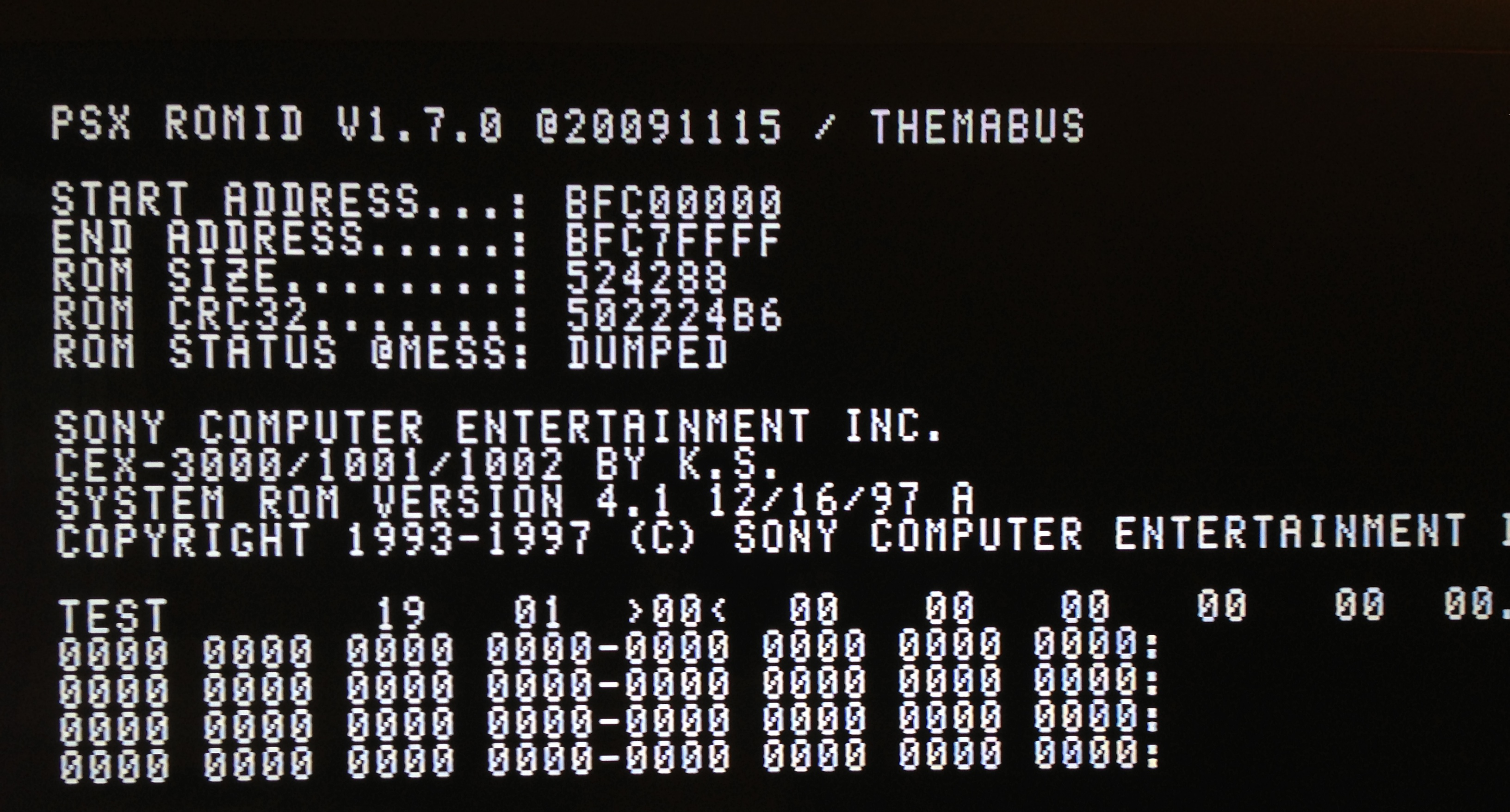

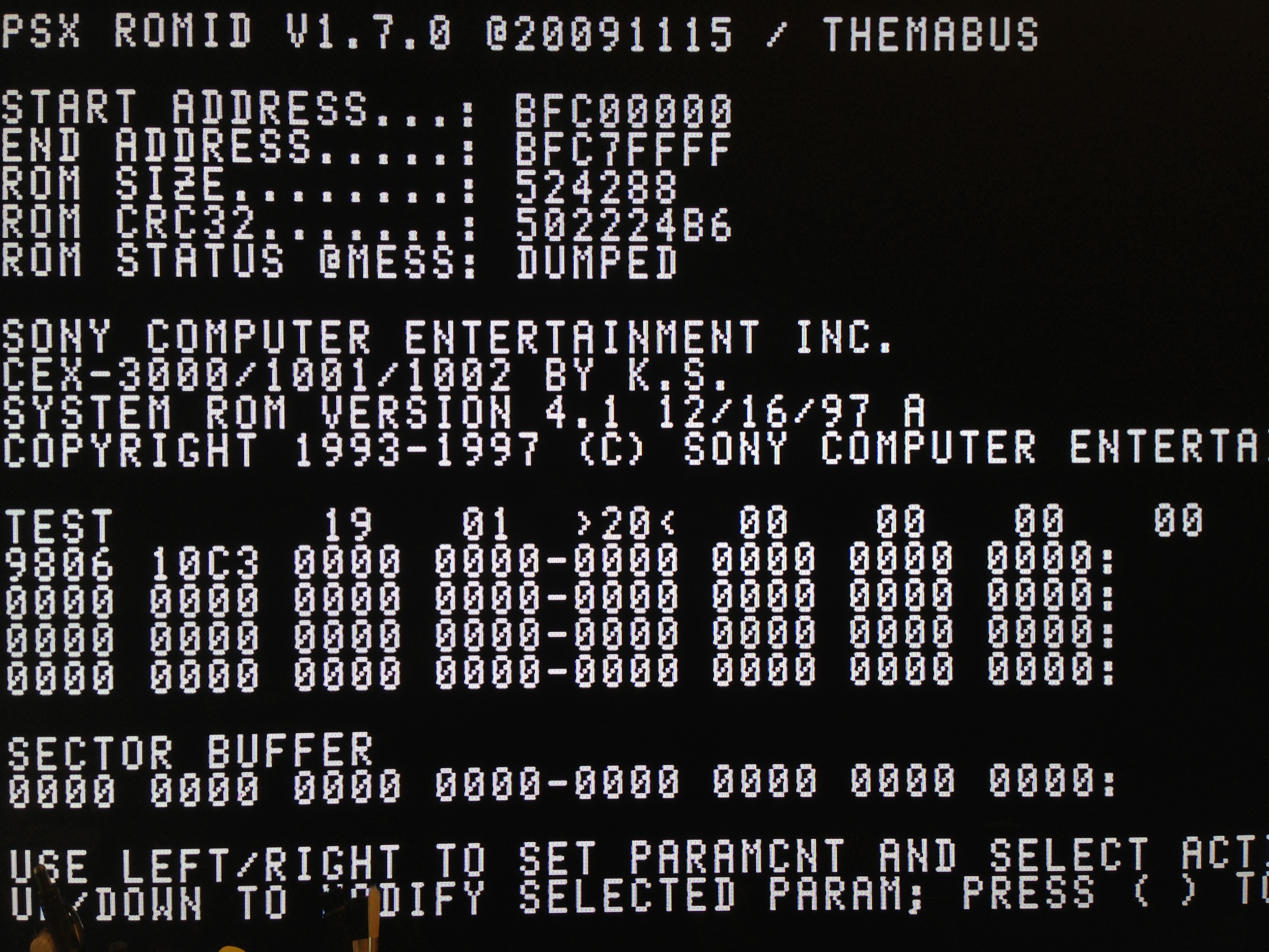

    Results are in:
    19 01 22
    19 01 23 (24 and 25 have the same result)
    19 01 20
    19 03 60 D0 01
    19 03 60 D1 01
    19 03 60 D2 01
    19 03 60 D3 01

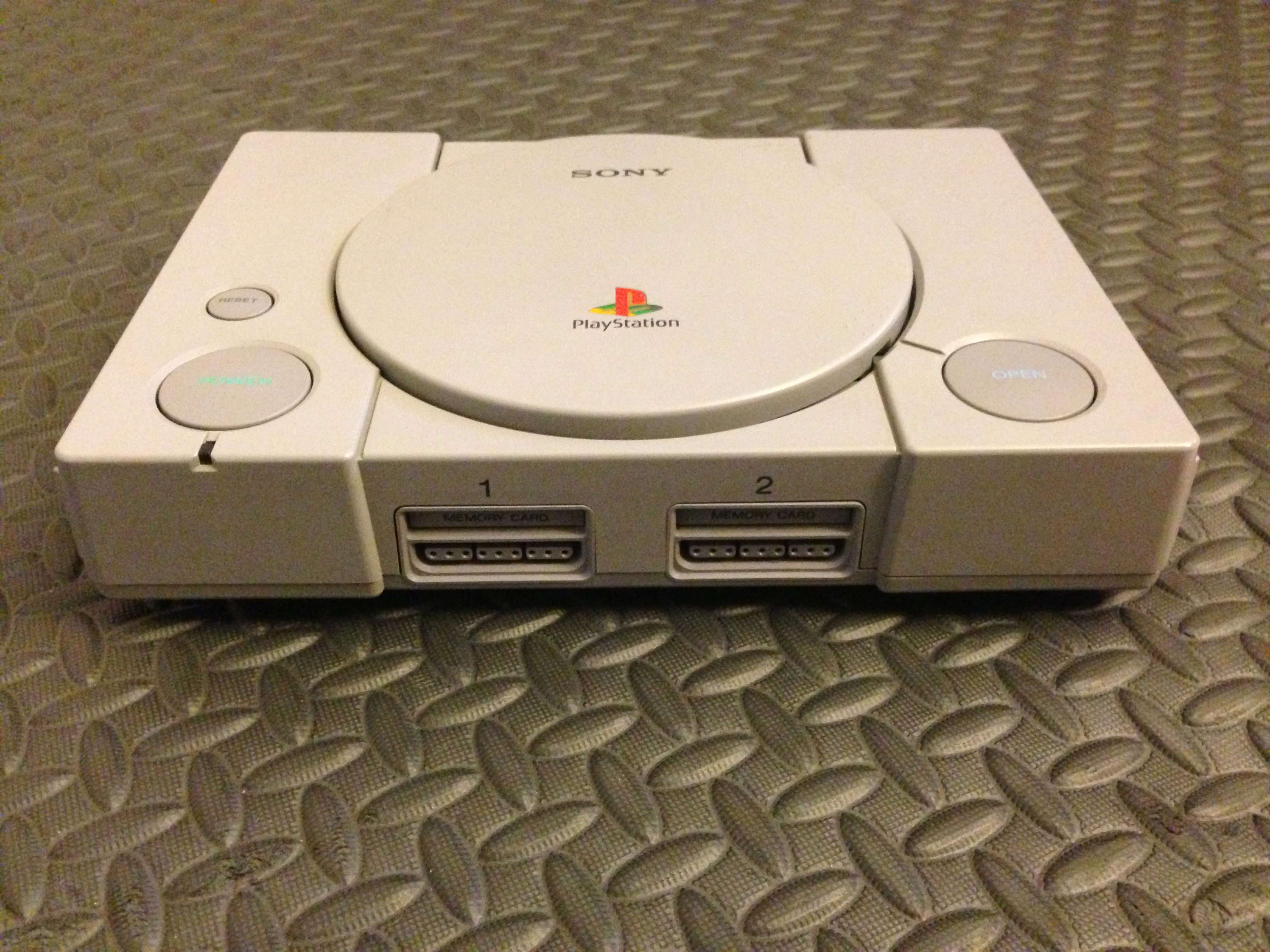

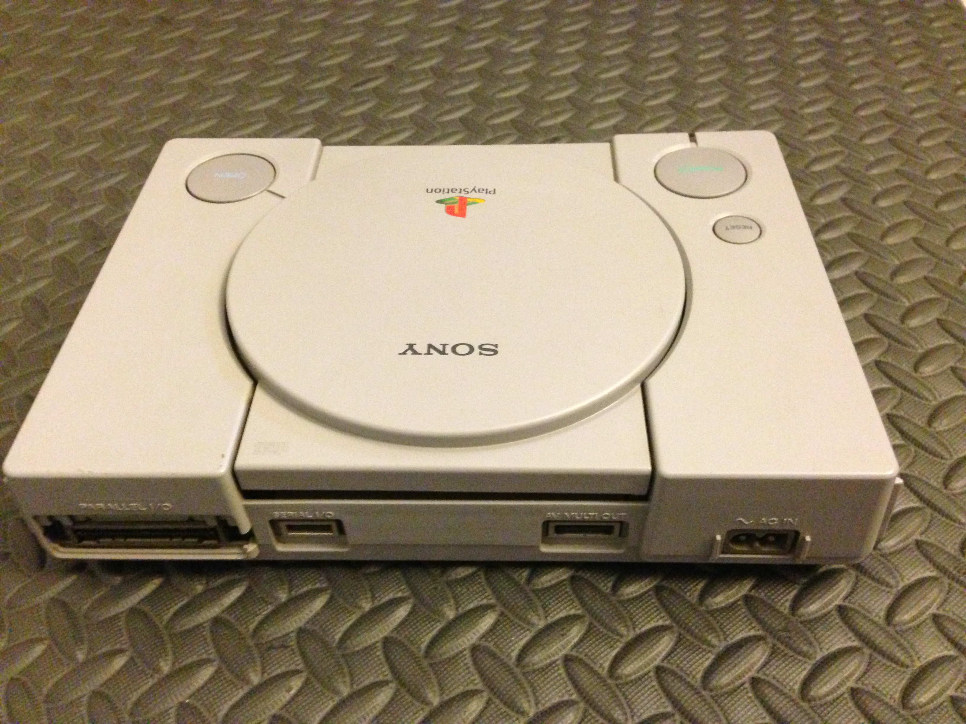

    Some people request additional pics of the console so here they are. Sorry for the noises.

    Hmm....a parallel port.
    Tichua,your SCPH-9903 PS1 must have been made on 750x hardware though,and that's because of the vent grills being like on a 750x/900x,and the parallel port there.Now,it's the motherboard revision that we don't know,but if Sony didn't relabel the motherboard,it must be a PU-22.

    Based on the ROMID report. it's a PU-22 board

    All the results are exactly consistent with a SCPH-7501 with a modchip in it.
    The fact that the CD chipset identifies as a CXD2940Q means that it has to be either a PU-22 (SCPH-750x) or PU-23 (SCPH-900x), except that it can't be a PU-23 because it has an expansion port.
    The CD controller territory comes up as "FOR U/C" - which makes it a SCPH-7501. The SCPH-7500 and SCPH-7503 identify as "FOR JAPAN" and the SCPH-7502 identifies as "FOR EUROPE" - non retail systems (debug, yaroze) normally identify as "FOR US/AEP" (some of the really old blue ones don't respond to this command at all). The other hint that this machine hasn't got a debug mechacon is that they don't even bother checking the territory info - even if you put an original disc in one the 19 03 60 <D0,D1,D2,D3> 01 commands will all return 0x20.
    The other thing is that looking at the photo of the console it has a PSU with a polarized line socket - and only US machines had those - Japanese, European and Asian units all had unpolarized "figure 8" sockets.
