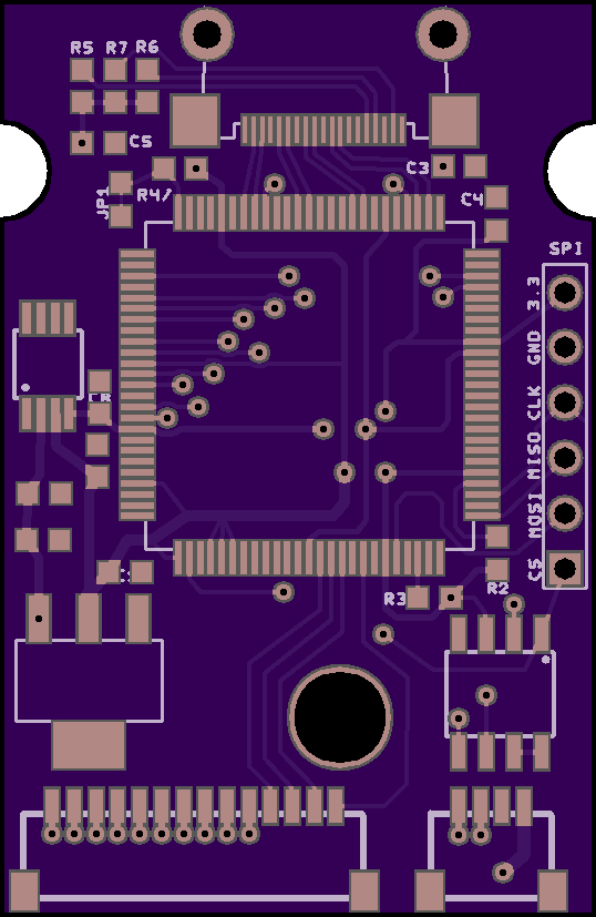

    Still didn't work. Whats even worse I don't have a direction to go in for debugging. At this point I'm going to set this design aside. I'm going to focus on the wasp and get that going and get that end wrapped up. I may design a test board that allows me to debug eaiser. This thing is so tiny its pain to do a simple voltage check etc. I did check every pin tonight under the microscope. Looking for anything obvious. I wonder if its something dumb like the FFC cable isn't able to supply enough current. But at this point my patience is getting thin and I need to take break and come back with fresh eyes.
    I just went through the entire PCB design again, pin for pin and don't see anything wrong. I am not using tant caps for the 1.2reg just ceramic caps. I can't that causing an issue but I will change them out tonight and cross my fingers.

    Wait there are more differences look on the wikipedia hdmi page under connectors most of the pins are swapped for the mini hdmi.

    I know its more than just pin1, I was just saying giving an example. That PDF has an illustration matching the pins up nicely to a Normal HDMI plug to a MINI
    Just revised the HDMI pins, made some other small changes to make a few resistors easier to solder. Then sent it off to OSH park.

    Cool don't want you to get more boards made and then find out the data pins are also swapped.
